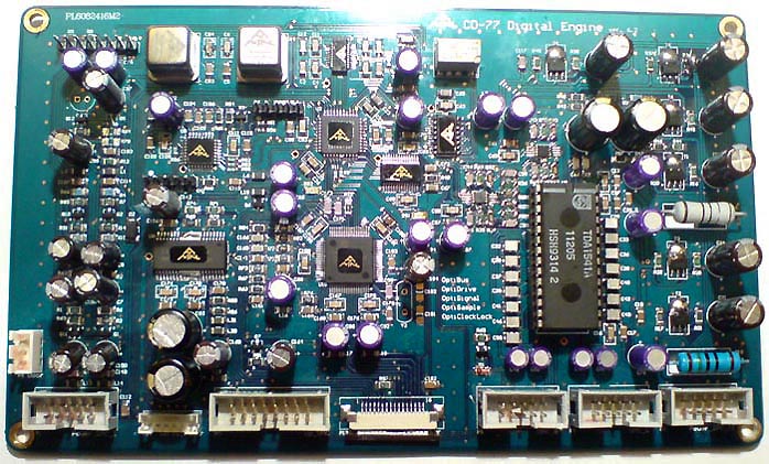

Seriously consider incorporating the three Salas Shunts needed for the TDA1541 directly onto the PCB, close to the TDA1541. Turn the TDA1541 so the supplies are on one side of it, the side opposite to the digital signal entry.
Equally, whatever powers the CS8412 I would suggest put them directly onto the PCB, using at least optimised LM1085 is a good idea, use a seperate one for the analogue pin on the CS8412, this is the PLL Chargepump.
It has a nice spikey current and likes low impedance sources with low noise. As the LM1085 will have varying output impedance with current. So use big size, low value resistors in the voltage setting network to force extra current through the IC. As we are doing DIY here we have no need to be too fretful, stick big heatsinks on the regulators and run a few 100mA, even if the supplies circuit only draws a few dozend...
Here an earlier version of the TDA1541 DAC and related logic, this had the groundplane at the bottom, routing on top. It was reasonably good, but far from ideal.
Looking to the right side shows all the shunt regulators for both TDA1541 and the other associated circuitry. The IDC socket there carries the various grounds and ccs reguated supply lines to the circuit board.
You can also see the various decoupling Cap's and the DEM decoupling Cap's (SMD). Above and besides the top lefthand corner of the TDA1541 are the I2S attenuators and reclockers.
The "generic" logic is to the left hand side of that, covering a range of function. To the far left left of it are the discrete supplies for the clocks, and the IDC socket that carries the various supplies into the PCB. The clocks are on the left top with the clock distribution towards the top center of the board (remember, this board is both CD-Player and USB DAC).
I hope this gives some ideas of the general layout principles. The most recent version is a considerable refinement on the original concept seen above.

Thank you again mr. T, sure lot of good stuff here to digest..finally 🙂, just bought 20x20cm pcb, last weekend, will be fun to put 4 Salas regs in there..
So we are essentially looking at 2 gnd planes, which connect at pin 5 of the tda. In my test rig, i am using off-board regulators, input stage, and analog stage.
I assume the analog stage will be referenced to agnd, the input stage to dgnd and the supply lines to whatever they power (digital or analog gnd). This, in turn, makes pin 5 of the tda a star ground, doesnt it?
In my final setup i will integrate regulation and possibly output stage on the same board, but the same situation persists...
Yes, essentially.
Not a good idea. In fact a terrible idea...
Yes.
Not really that easy, sorry I cannot tell more but the design I did form AMR is not for public release...
I guess that is a fair way of saying it.

Another way of saying this is to state the actual current return point for Iout is not Agnd but +5V, so strictly speaking +5V serves as analogue reference point.
However +5V is also the digotal supply line and needs a low impedance connection there (marce, is the digotal plane under the TDA1541 becoming clearer? 😉 (
This is the beginning of understanding, but not complete.
Ideally +5V and -15V and AGND and DGND are held at PRECISELY the same AC potential from a few Hz to a few MHz. The -5V supply is a little different, but can be treated the same (same AC as AGND & DGND).
This is (as said) not really the case and if we cannot make the potentials the same we need to consider which currents matter most.
