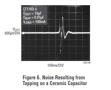

About piezoelectric effects:
From Linear Technology, LTC6655 datasheet (0.25ppm Noise, Low Drift Precision Buffered Reference Family)
quote:
"For very low noise applications where every nanovolt counts, film capacitors should be considered for their low noise and lack of piezoelectric effects. Film capacitors such as polyester, polystyrene, polycarbonate, and polypropylene have good temperature stability..."
The picture come from Linear Technology, LT1763 datasheet.
Using capacitors with long leads is never a good practice. For low noise application, many manufacturers recommend to NOT USE X7R capacitors.In a decoupling role, with SMD devices the microphony of X7R and above dielectrics will not be a problem, as said they do get a bad press in audiophile circles, but are used in there millions throughout the world and tested in high vibration equipement with no adverse effects.
quote:
"In order to achieve the best performance, caution should be used when choosing a capacitor. X7R ceramic capacitors are small, come in appropriate values and are relatively stable over a wide temperature range. However, for a low noise application X7R capacitors may not be suitable since they may exhibit a piezoelectric effect. The mechanical vibrations cause a charge displacement in the ceramic dielectric and the resulting perturbation can look like noise."
