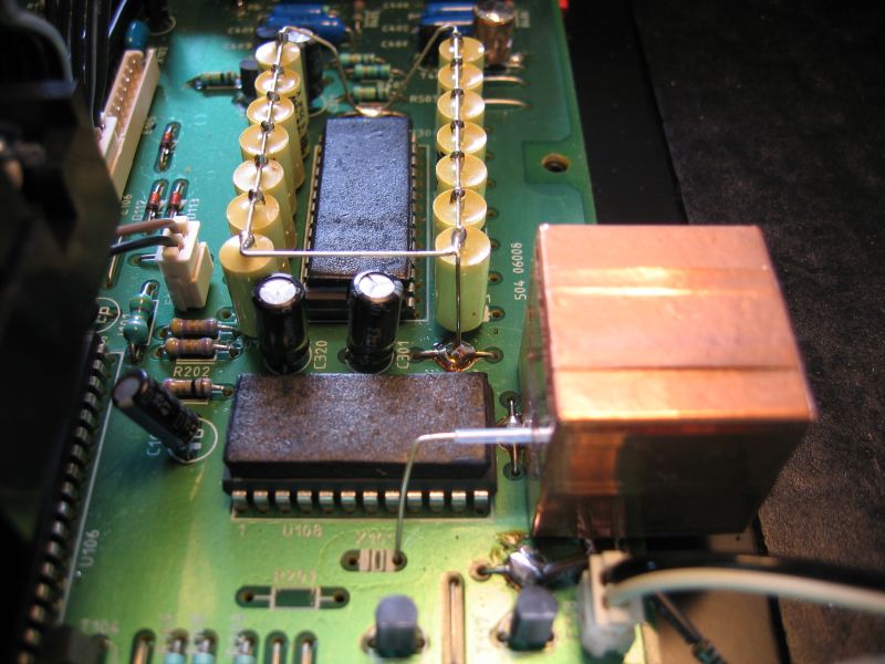

Hi Thor66,
The caps path to ground is way too long for my liking.
what is that copper box on the right ? clock ?
Hartono
Hartono
Yes, it is a rather long path to ground, but only slightly longer than the original pcb-tracks.
It's a quick and easy way of doing it when there's little space underneath the pcb.
A shield between the digital and analog sections is a good thing when using large foil caps.
Together with a standard CDP-clock comletely cast in silicone rubber and better OPs in the output, the result was amazing for a weekends modification-work. So keep on tweaking !
