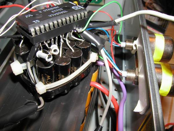

Hello to all,
I'm a newbie and i have a question. Is it possible to solder the decoupling cap straight to the pins of the TDA?
Thnx in advance.
Thnx in advance.
I've no idea where I found this - I probably downloaded it from a forum (probably this one) years ago. So, not my work, but probably the closest method to soldering big caps to the pins. Not sure I'd risk soldering straight to the pins myself - but that's because I don't have many TDA1541As going spare these days. You probably could do if you're quick (CD manufacturers did), but it's just safer using a socket.
I did this on my original adagio.
Wrapped the IC into copper foil which was used as groundplane and all components hard-soldered to the pin's (not just decoupling cap's, also 431 Shuntregs and other stuff...
A bit hardcore perhaps, for most.
Ciao T
