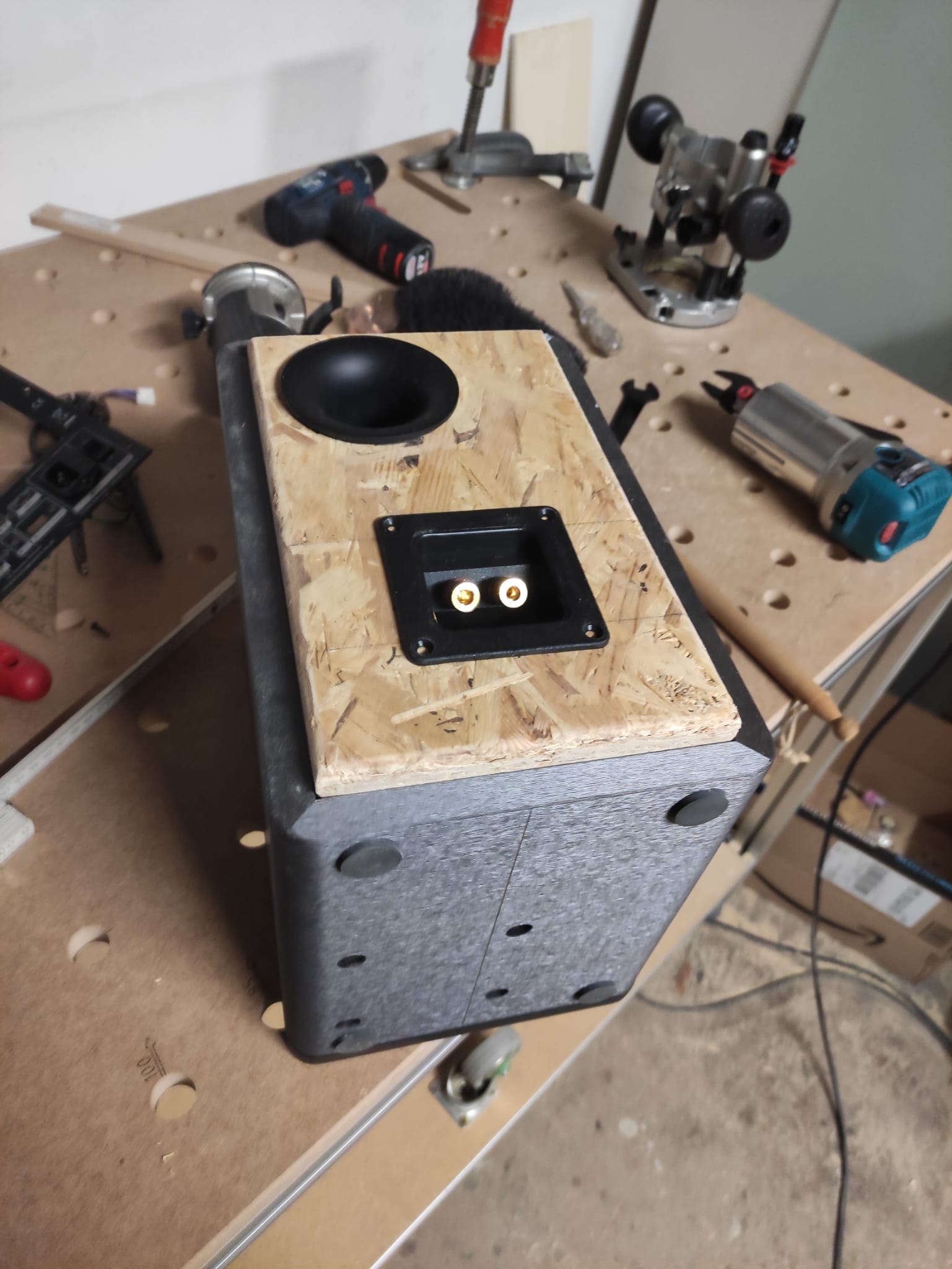

Given they are only 39 US$ each, already have the PCB, the ready to mount back panel , terminals, even wiring ready to plug-in at the speaker itself, personally I would buy the originals in a jiffy.
Doubt you save money after adding all costs.
In general the "electronics" part is the cheapest one, the "mechanicals" being the most expensive and inconvenient, by far.
Of course, the decision is yours.
And it guaranteed fits your speakers.
As of finding which is which, touch each speaker terminal pair with a 9V battery, tweeter will "click click", woofer will "thump thump"

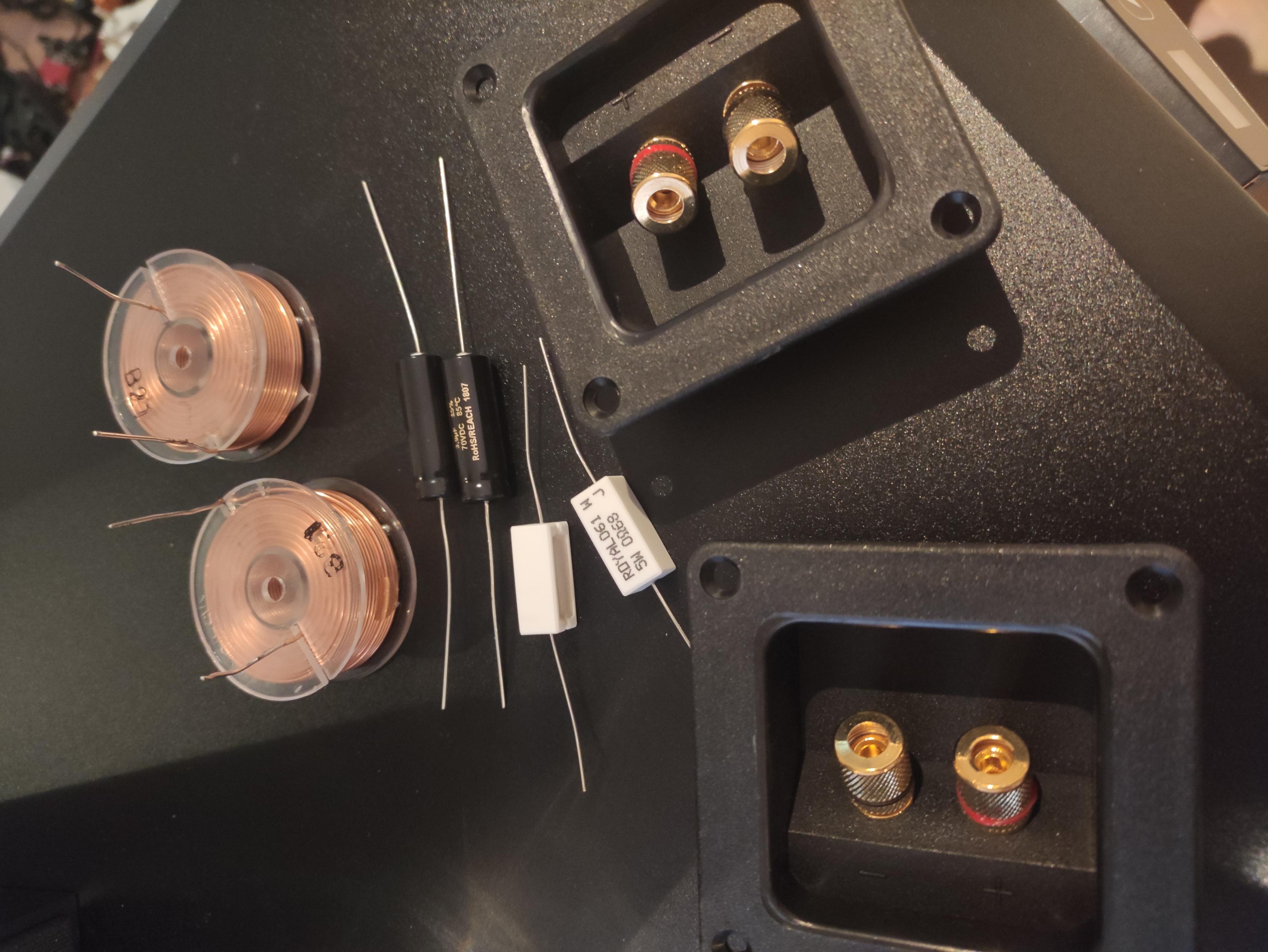

They are:
3.9uF, 70VDC
Mundorf ECap AC 3.9uf 70V Bipolar Electrolytic Capacitor - PLAIN - Willys-Hifi Ltd
3.9uF, 70VDC

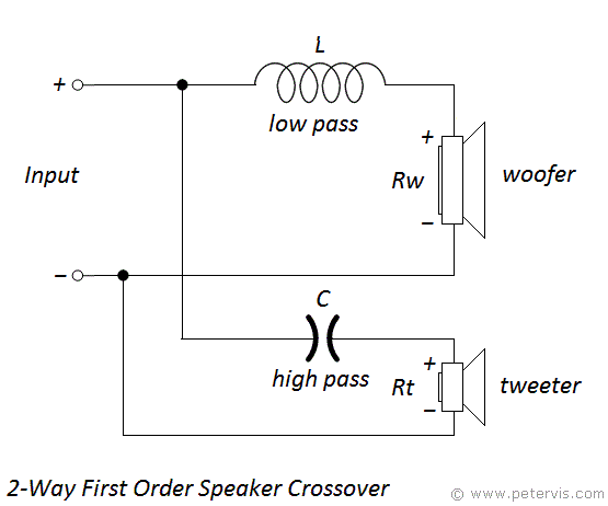

One more thing, in the diagram, what's L1 and what's C1? I'm not familiar with the software or those terms 😉
L is the inductor (the coil) which goes in series with the woofer.
C is the capacitor which goes in series with the tweeter.
Thank you very much! All clear now 😉
Now thinking about it, it makes sense how it fits together 😉
