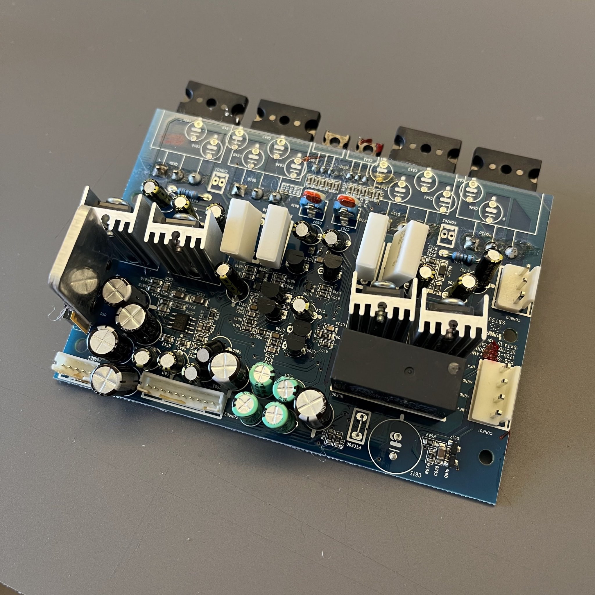

Btw. as I don't need them anymore and cannot fix it anyways: If anyone is interested in the KEF x300a electronic parts, please let me know.
I'm in Europe/Austria.

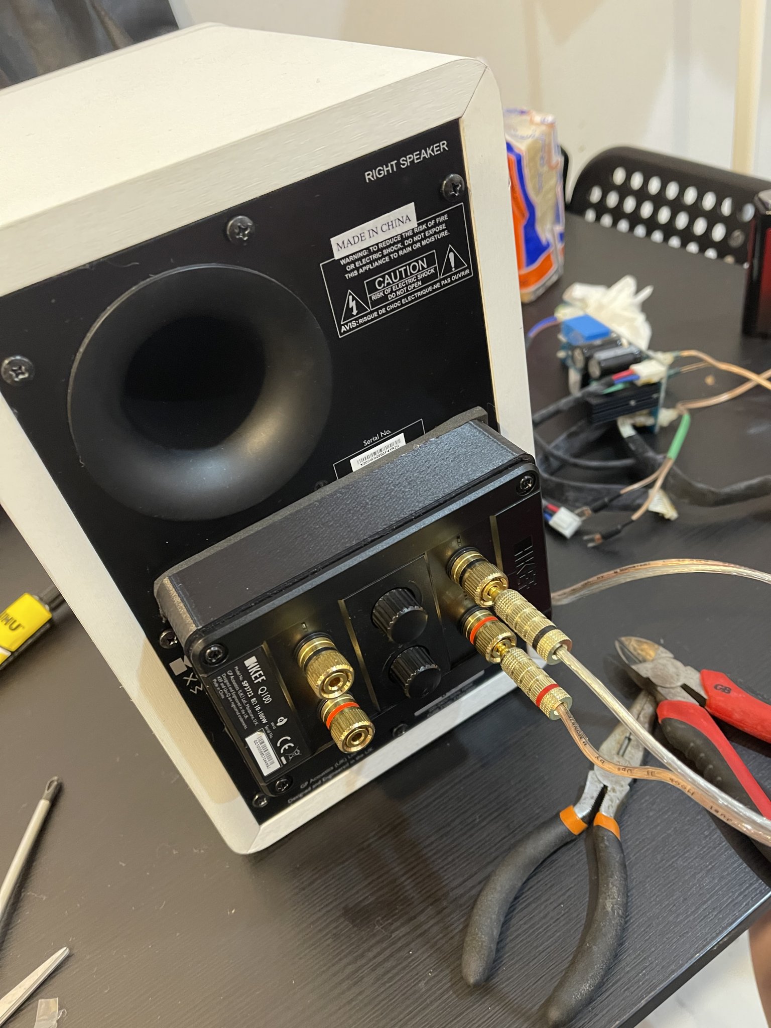

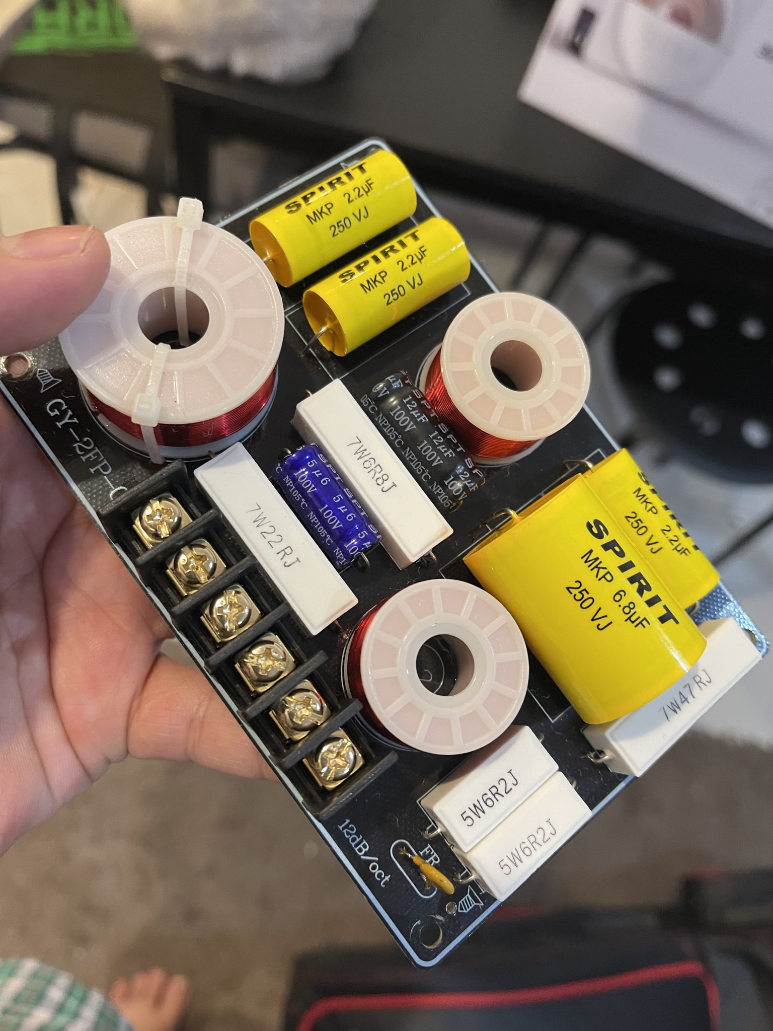

Hello there, i have the same unit x300a and im trying to do the same approach of making used of these speakers.
I bought Q100 crossovers from ebay, now the question is that the crossover is rated for 8 ohms and the uniq driver of x300a is 4ohms. Will it work just fine? or it will burn the voice coil overtime?
During the course of this thread, I established that the Q100 passive crossovers match the drivers in the active X300A.
The ebay statement that the crossover is rated for 8 ohms may be taken with a pinch of salt.
I would be confident in using the Q100 crossover.
Please report back, I'd be interested in knowing how the modification sounds - the OP certainly said his cloned Q100 crossovers worked.

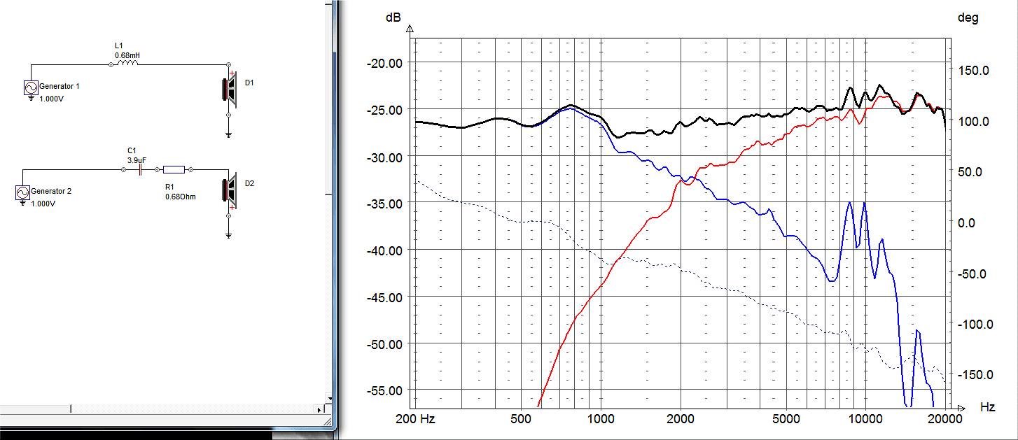

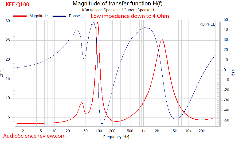

Since it's your first post, vrachie, I'll add that 8 ohm is simply a nominal figure since the impedance of the Q100 speaker system varies widely with frequency.
Look at the Q100's impedance versus frequency curve (red trace) in the attachment. Within the audible range, the impedance drops as low as 4 ohm in some places, but for most of the time it is well above 4 ohm. In fact at the crossover frequency of 2,500 Hz the impedance is 30 ohm.
The 8 ohm rating of the Q100 speaker system and crossover is therefore only a nominal figure. The crossover design takes the changing impedances of the drivers into account.

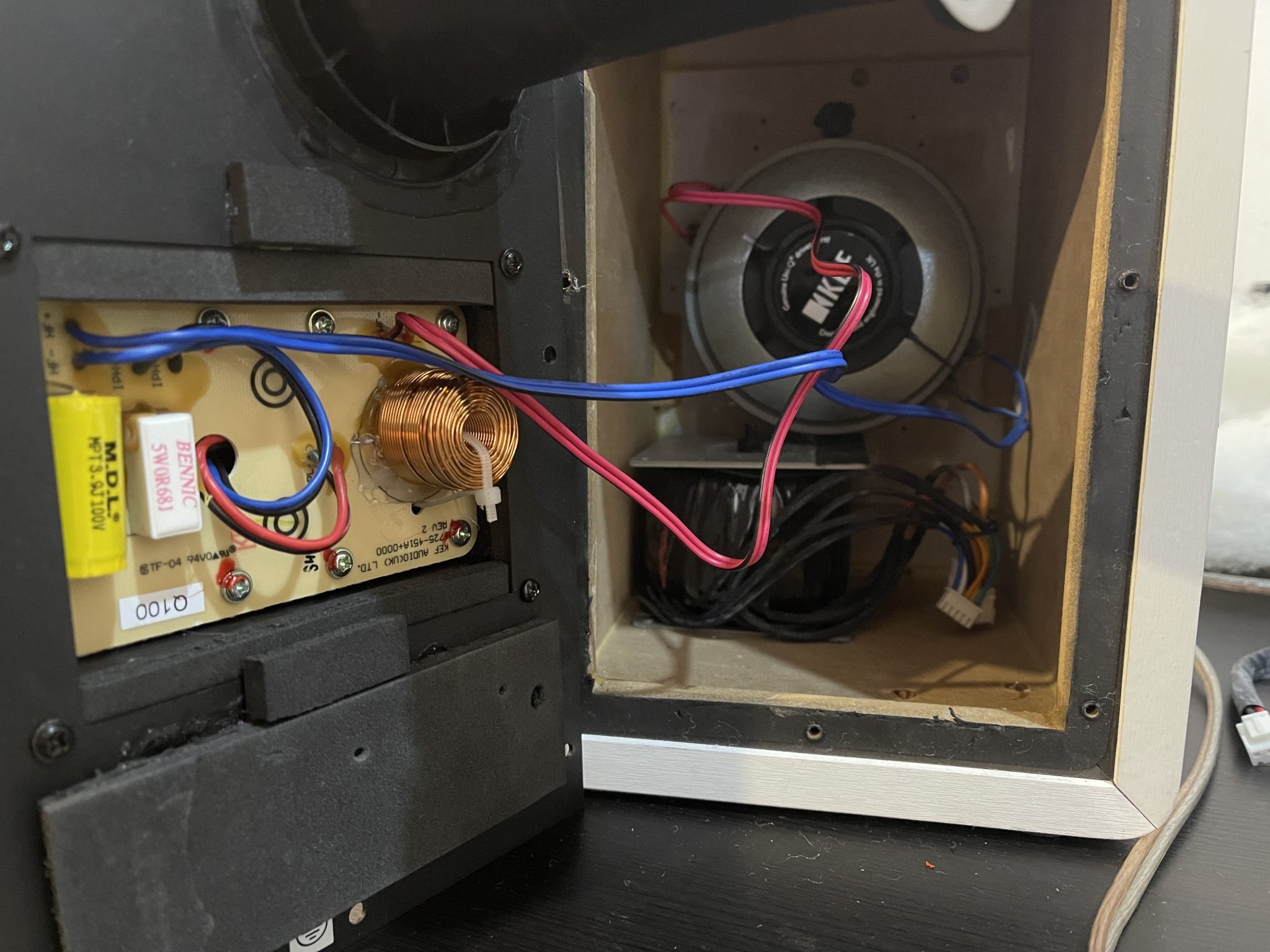

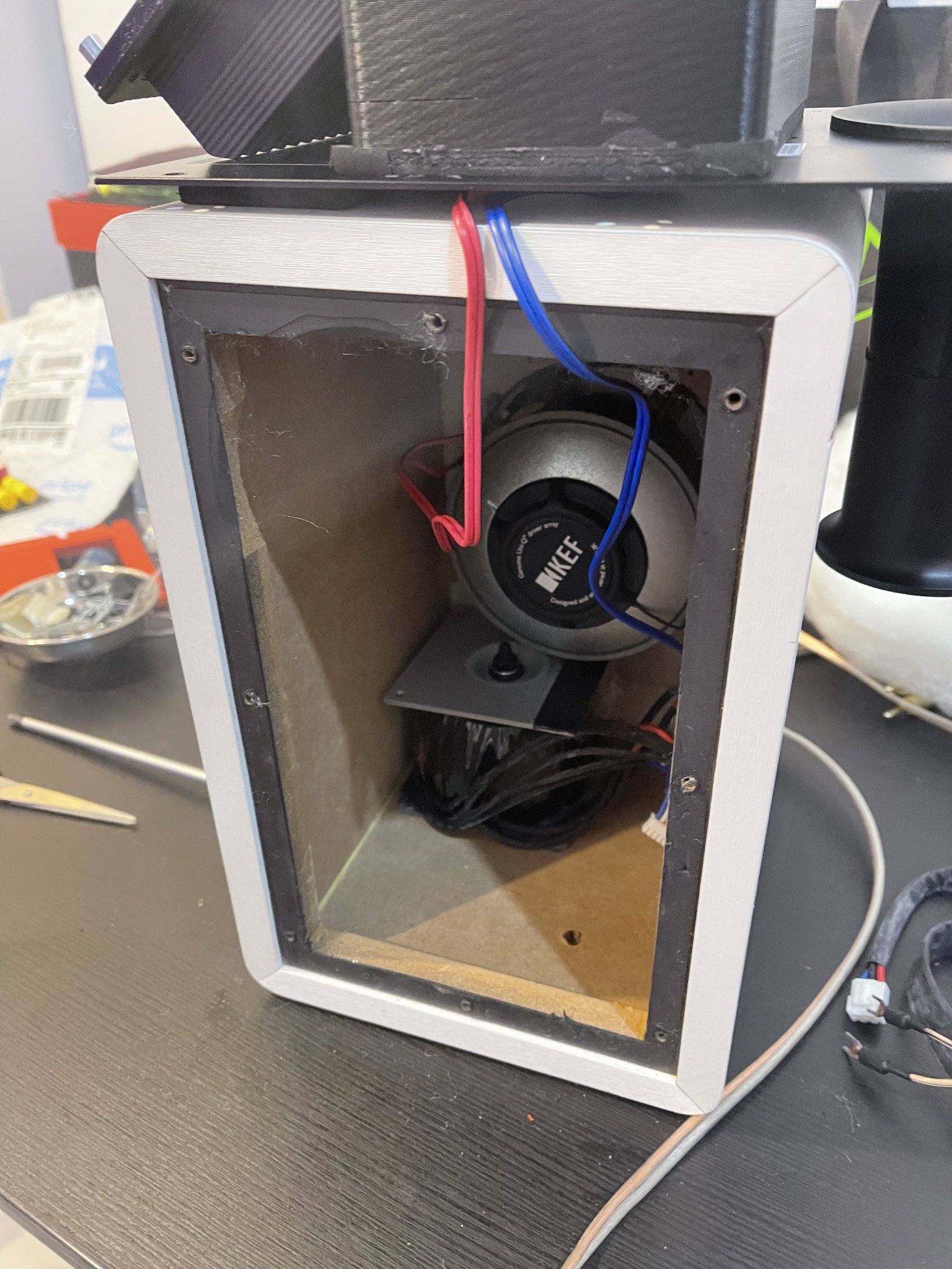

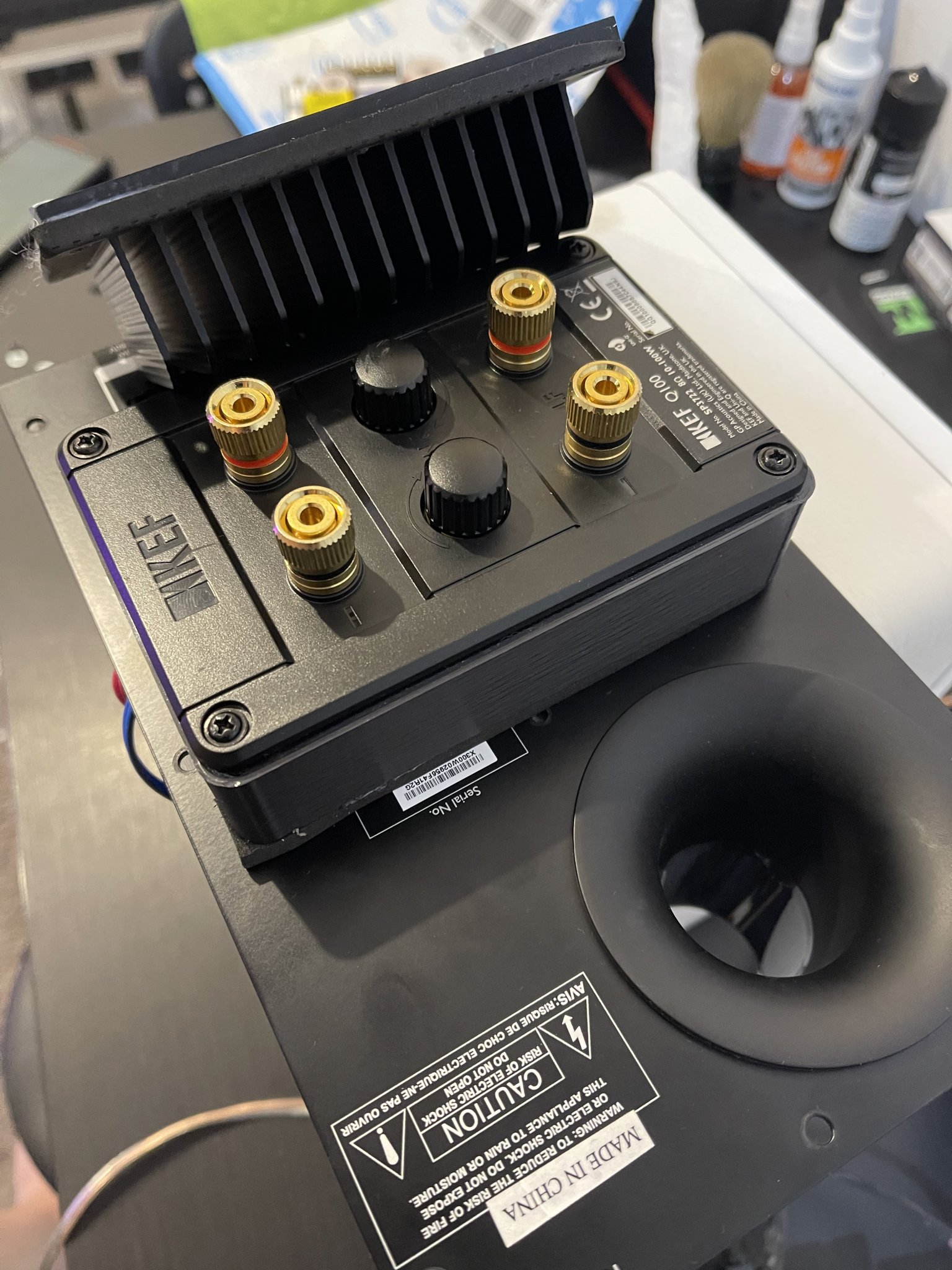

finally I'm done installing q100 crossover into x300a and its sounds amazing, even better from the build inpower amp dac of x300a itself.
I even tried other crossover which I bought from amazon but I think it was lacking the right frequency range (just based on what im hearing when I compared it side by side with the q100 crossover).
Well this settles it, Im very thankful I found this thread and learn a lot more from you guys. Thanks a lot.

Thanks for the feedback and photos.
It's good to have a second confirmation that the simple Q100 crossover (the components of which are shown in your third image) suits this KEF coaxial driver.

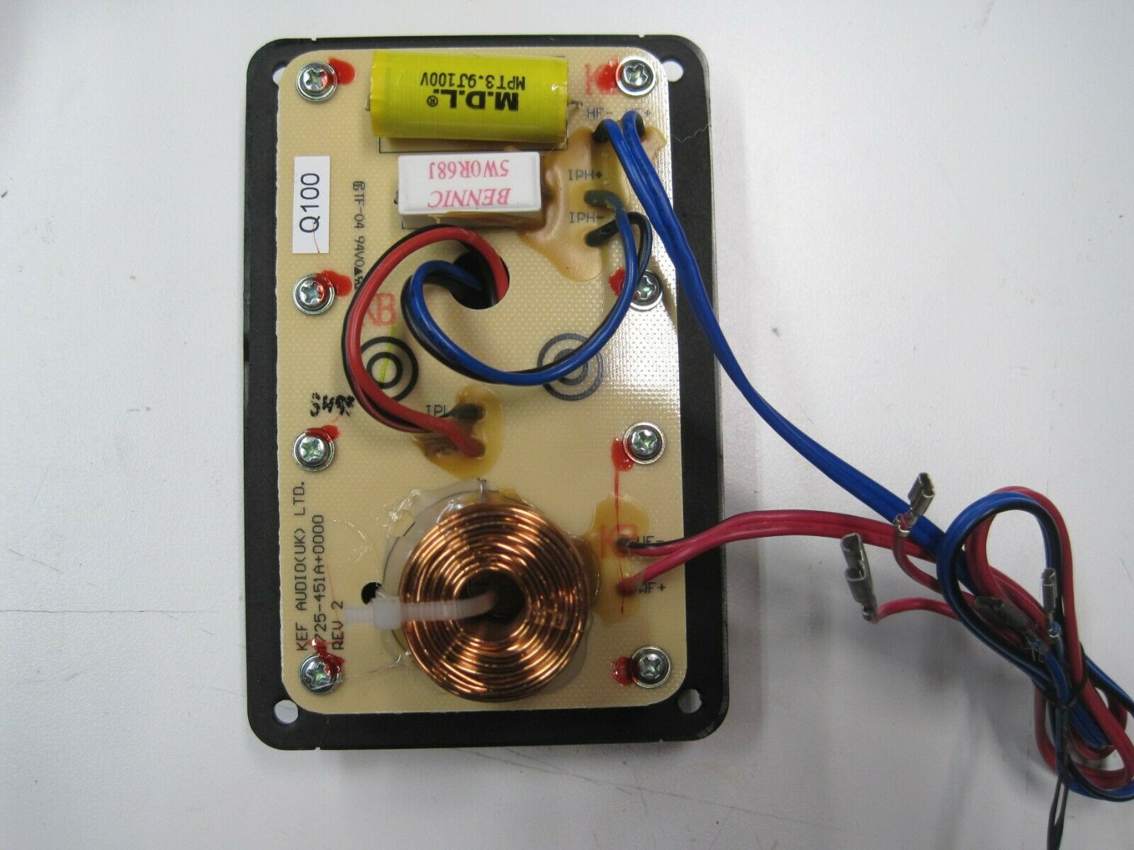

Since the thread has been re-opened, I shall state that its original purpose was to convert the active KEF x300a loudspeaker to passive use.
The solution is to use the KEF Q100 crossover circuit, a photograph and schematic of which are attached.
