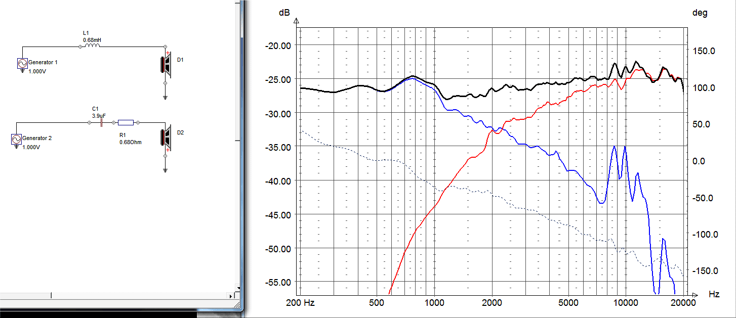

On the Q100 crossover, I can see a 3.9 uF capacitor. This would indicate that all you need to do to get the speaker working is to put a 3.9 uF film capacitor in series with the tweeter.
The Q100 specs state a crossover frequency of 2500 Hz.
Taking into acount the increase in impedance of the drivers at the crossover frequency, I would suggest you then add a 1.0 mH air core inductor in series with the bass/mid driver.

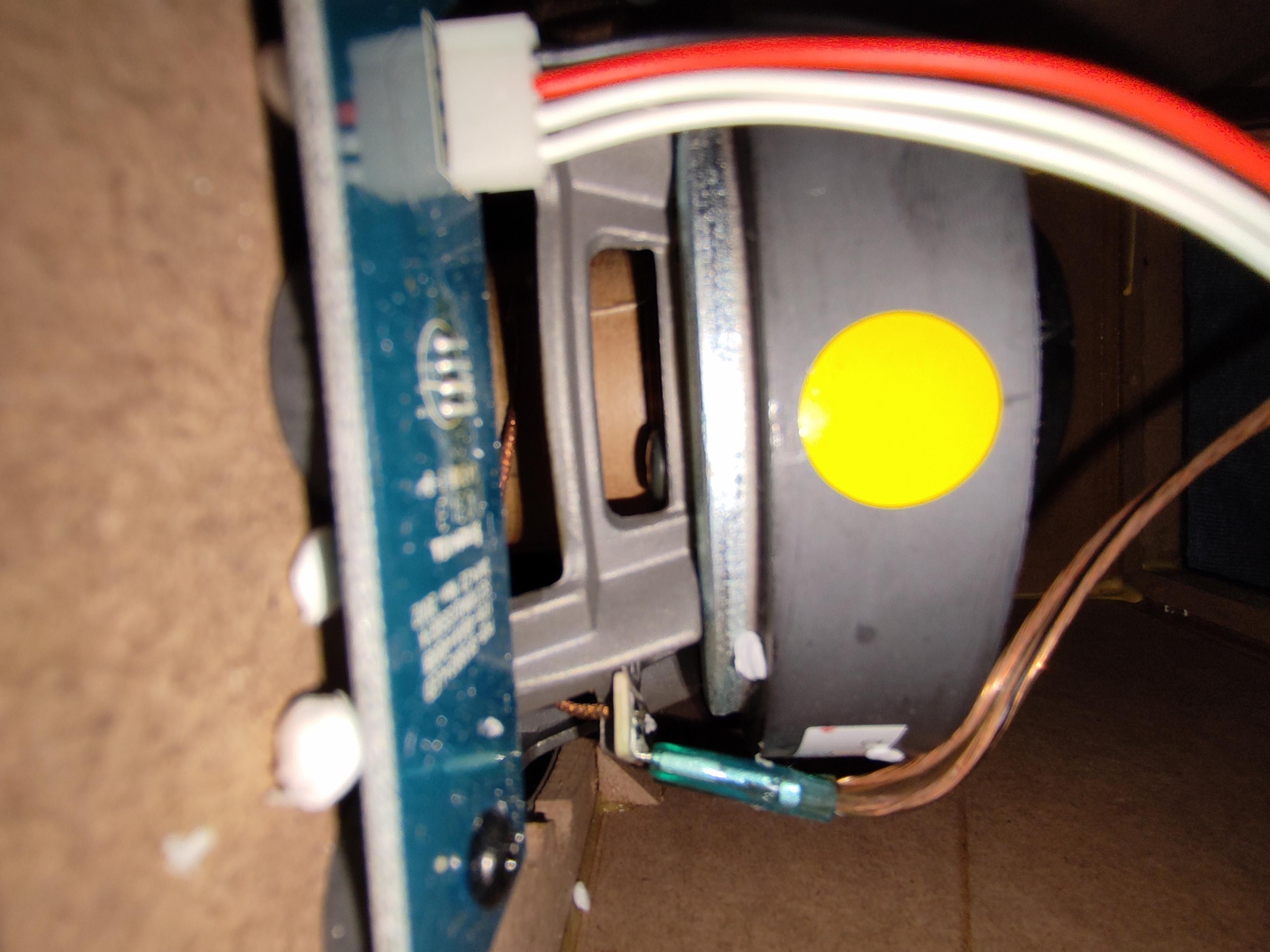

Wait, so I've checked the drivers now. See images.
I've only disassembled one speaker for now, and couldn't find any screws that would let me separate the driver.
Also, I'm not able to identify which of the pairs is the tweeter, can this be inferred by the resistance?
I've measured the resistance with a multimeter, across each pair.
The resistance of the multimeter terminals is 0.2 ohm.
The resistance of the driver wires is 3.3 ohm (at the label) and 3.1 ohm.
Can this be correct, or am I doing it wrong? 🙂

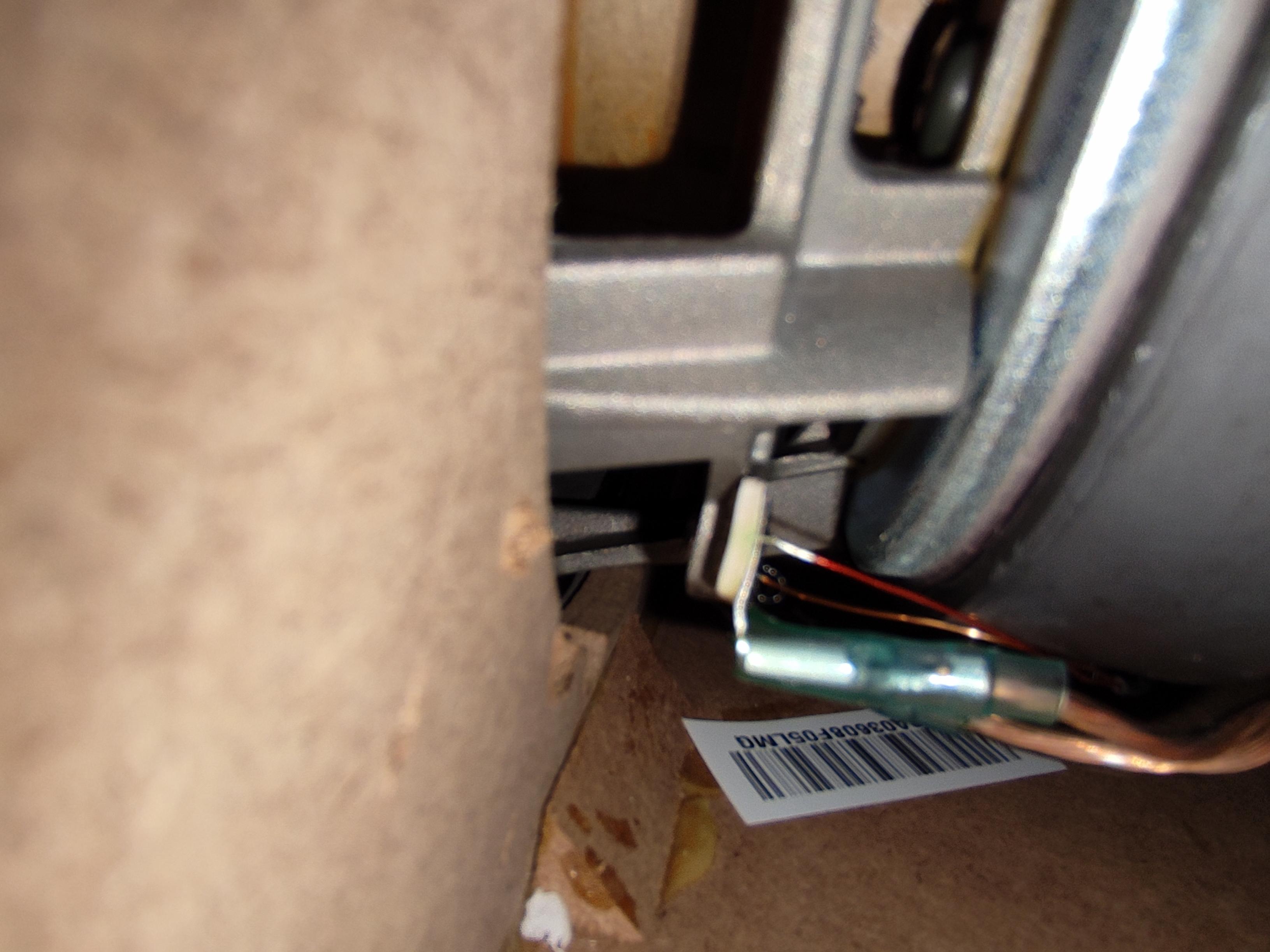

You're getting a resistance of around 3 ohm which indicates a nominal impedance of 4 ohm.
Don't try to separate the drivers!
The tweeter connection appears to be the one on the right of your third photo, if that little black wire going into the top of the unit is anything to go by.
Do you realise that this is a coaxial driver? The tweeter is in the centre of the mid/bass speaker, not separate from it.Small speaker = tweeter

I meant to separate the whole driver combination from the chassis so I could better check which is which, but if it's not necessary, then it's fine.
They don't have a common wire, it's 4 wires with 2 ground wires marked black. What I meant is I cannot see which of the pairs goes to the tweeter and which one goes to the woofer.
I found the screws, they glued a cover to the front.
Thanks for the hint, there are indeed markings. Let me send an update, one sec.

As a double check - the connection in your first photo appears to be going to the bass/mid driver section.
Combine that with my last observation and tell me if the two observations are compatible.
That seems correct.
On the third image:
Right side goes to HF+, AGND and has 3.3 ohm (minus 0.2 ohm of multimeter)
Left side goes to LMF+, AGND and has 3.1 ohm (minus 0.2 ohm of multimeter)
There is also another label reading Uni-Q 4 ohm
If necessary, I can separate the driver from the chassis
