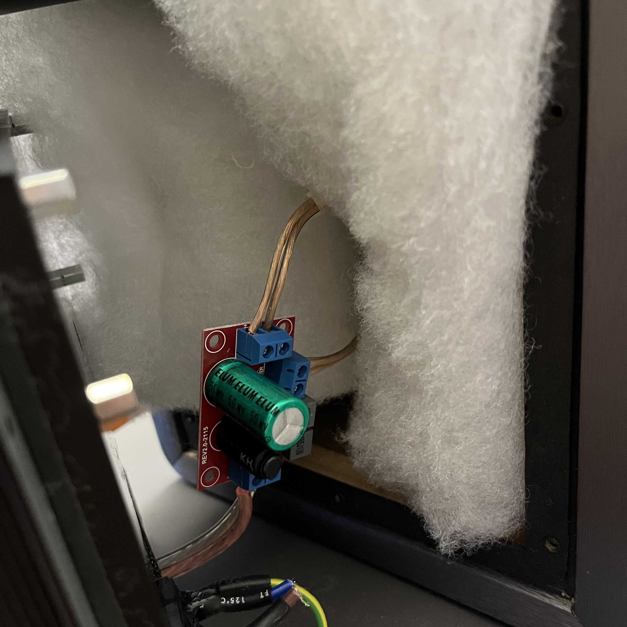

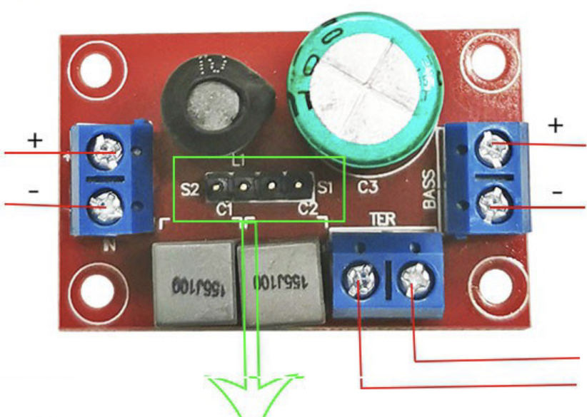

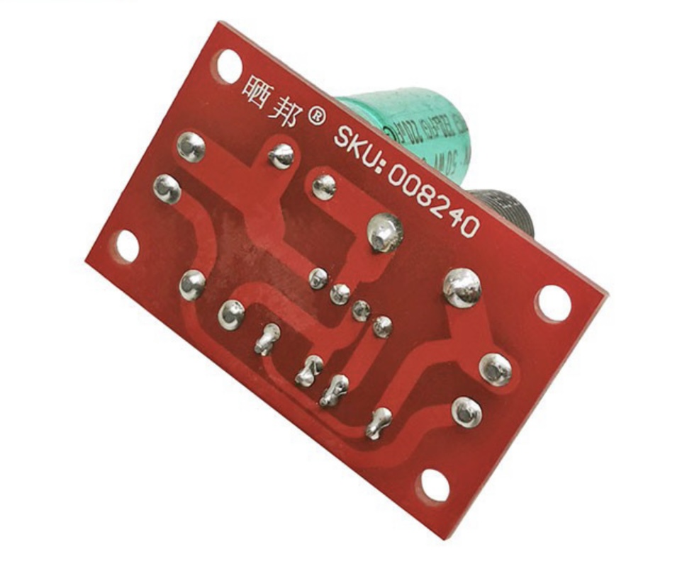

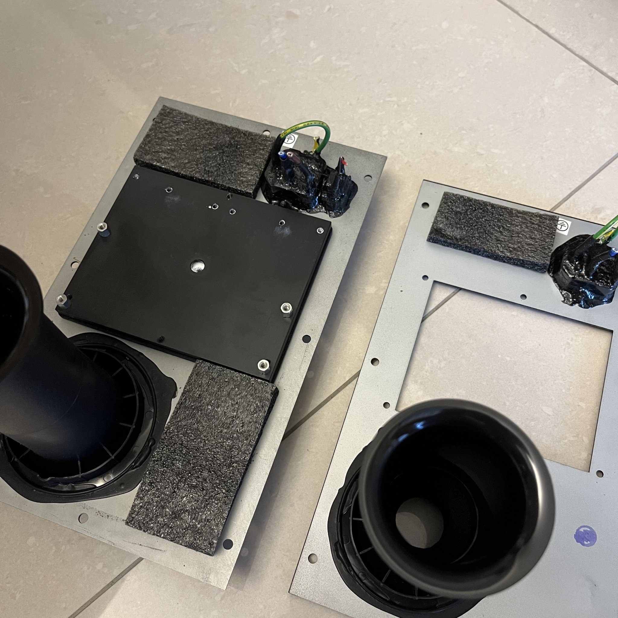

Big thanks to the gurus here. I have converted my speakers too. Wanted to save the wood work and cost, the back plate and the heat sink were reused. The amp was separated and taken off. The rest of small holes are sealed by foam. I got cheap crossovers which x/o point is around 2k-3k, tested by connecting only the woofer and playing the 20-20kHz sound. There are jumpers for tuning. Looking at the backside of it, it appears like of the jumper adds another 155J100 capacitor to the HF path in parallel. This cap is 1.5uF. I think I have to open the speaker again to connect this jumper to make it close to the recommendation above. The other jumper bypass the green thing (cap? resistor?) in the LF path. At least it has a x/o point is close to target, rather than those 4kHz I saw.

blach, how does the back board look like at the end? I saw you have tools and space to work on it.
I recommend you ditch those cheap crossovers. They contain a woeful little iron core inductor which will do nothing to enhance the sound.
Better to build your own crossovers using quality components, including air core inductors, as described in the thread. That won't cost the earth.
I am really motivated to get better crossover or make my own.I recommend you ditch those cheap crossovers. They contain a woeful little iron core inductor which will do nothing to enhance the sound.
Do make your own crossover.
The recommended crossover is about the simplest crossover you could hope to make.
There isn't a "better" commercial crossover that will do the same job, unless you find a couple of used KEF Q100 crossover boards at auction.

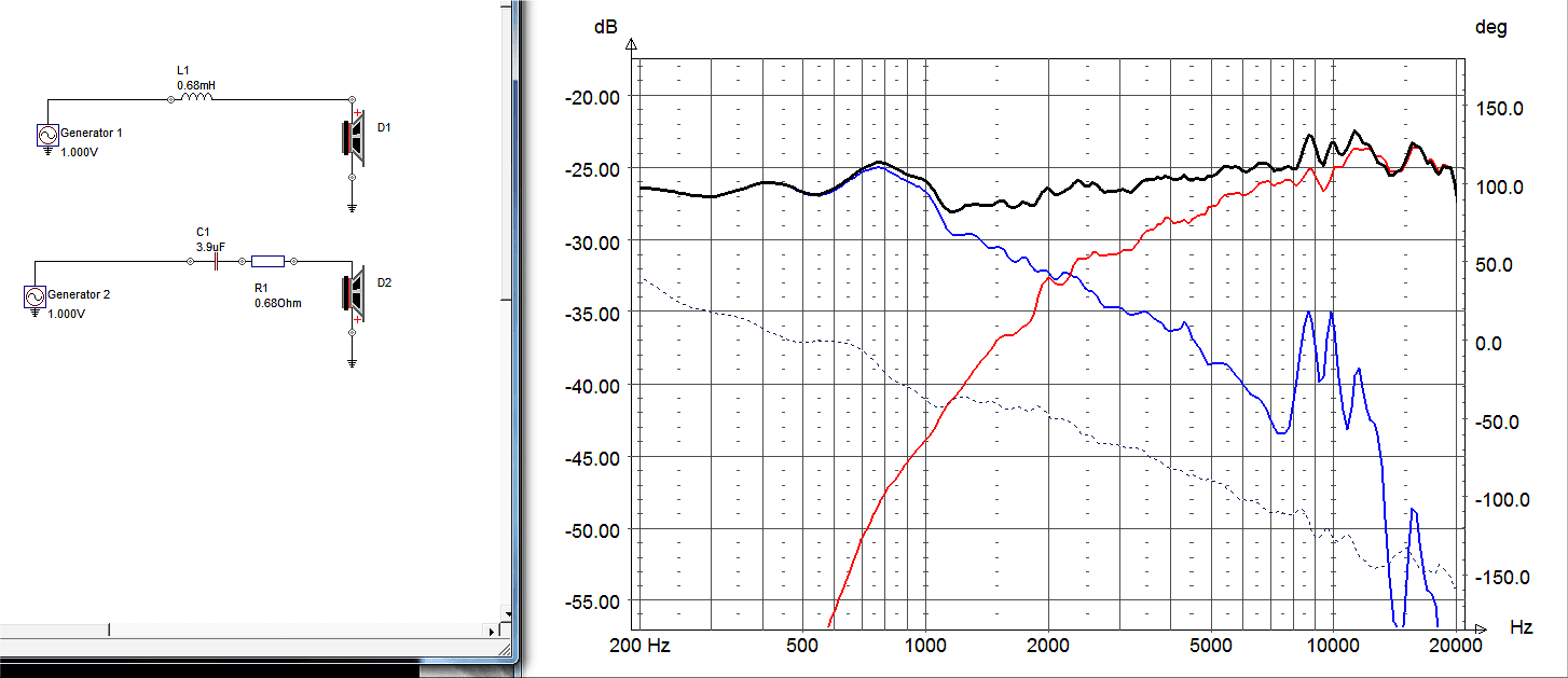

While I am sourcing the parts to make my own crossover, I came across some online calculators. The problem is, when inputting 3 or 4 ohm as impedance and 2500Hz as the x/o frequency, the result is quite different from the recommended values above.
Is it because the impedance of Q100 is 8ohm whilst the X300A is 4ohm? Did I do the calculation wrong?

It is because the online calculators do not take into account the impedance that each of the drivers actually has at the frequency of crossover.
Remember that impedance is not a fixed quantity, but varies with frequency, and values like 8 ohm and 4 ohm are only nominal (or average) values. It is the impedance of each driver at the crossover frequency which is important in crossover design, and you don't have access to those figures.
Others have attested that the Q100 crossover works well in this situation, and I would stick with it.

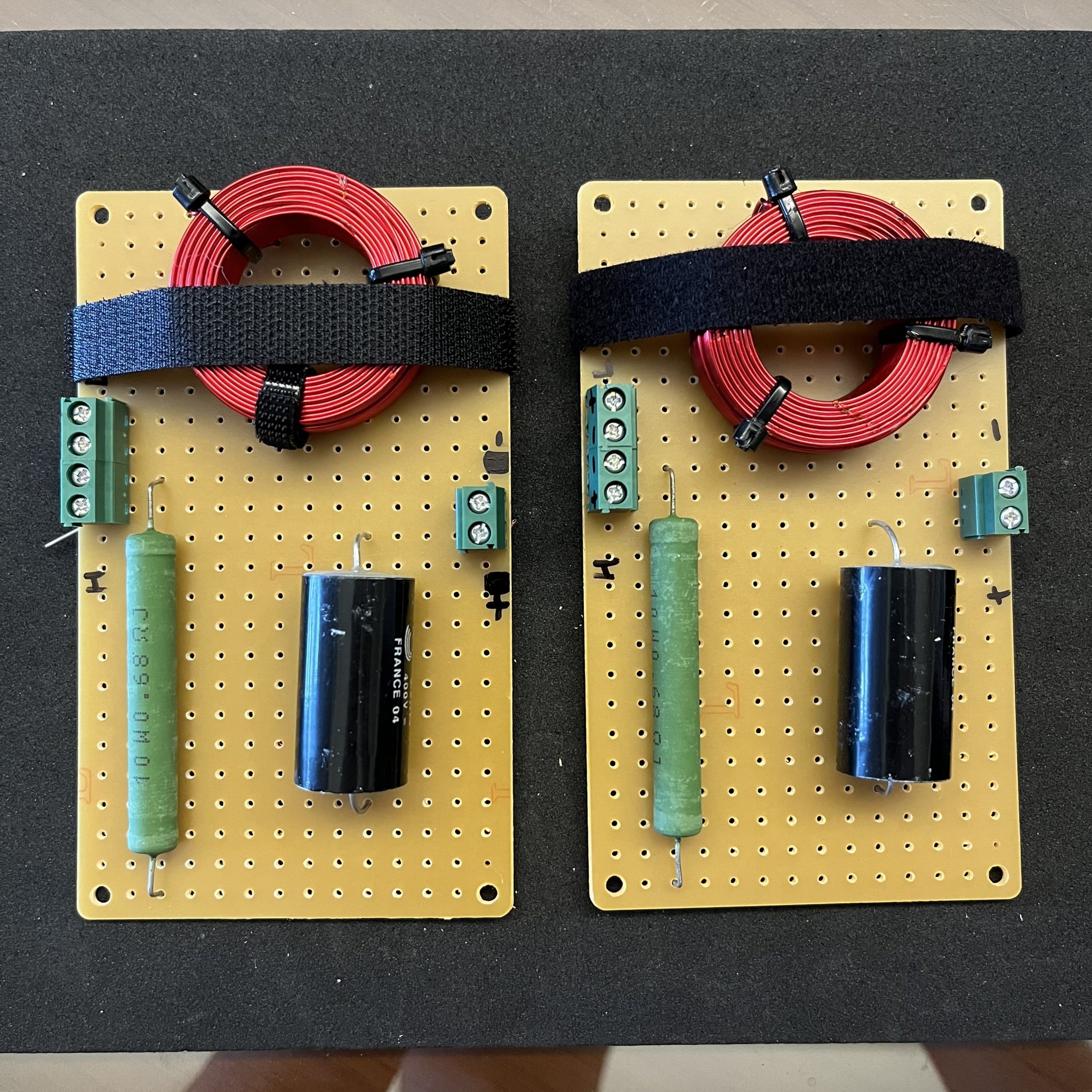

Hi,I've found the original Q100 crossover schematic.
The inductor is 0.68 mH - I wasn't too far out!

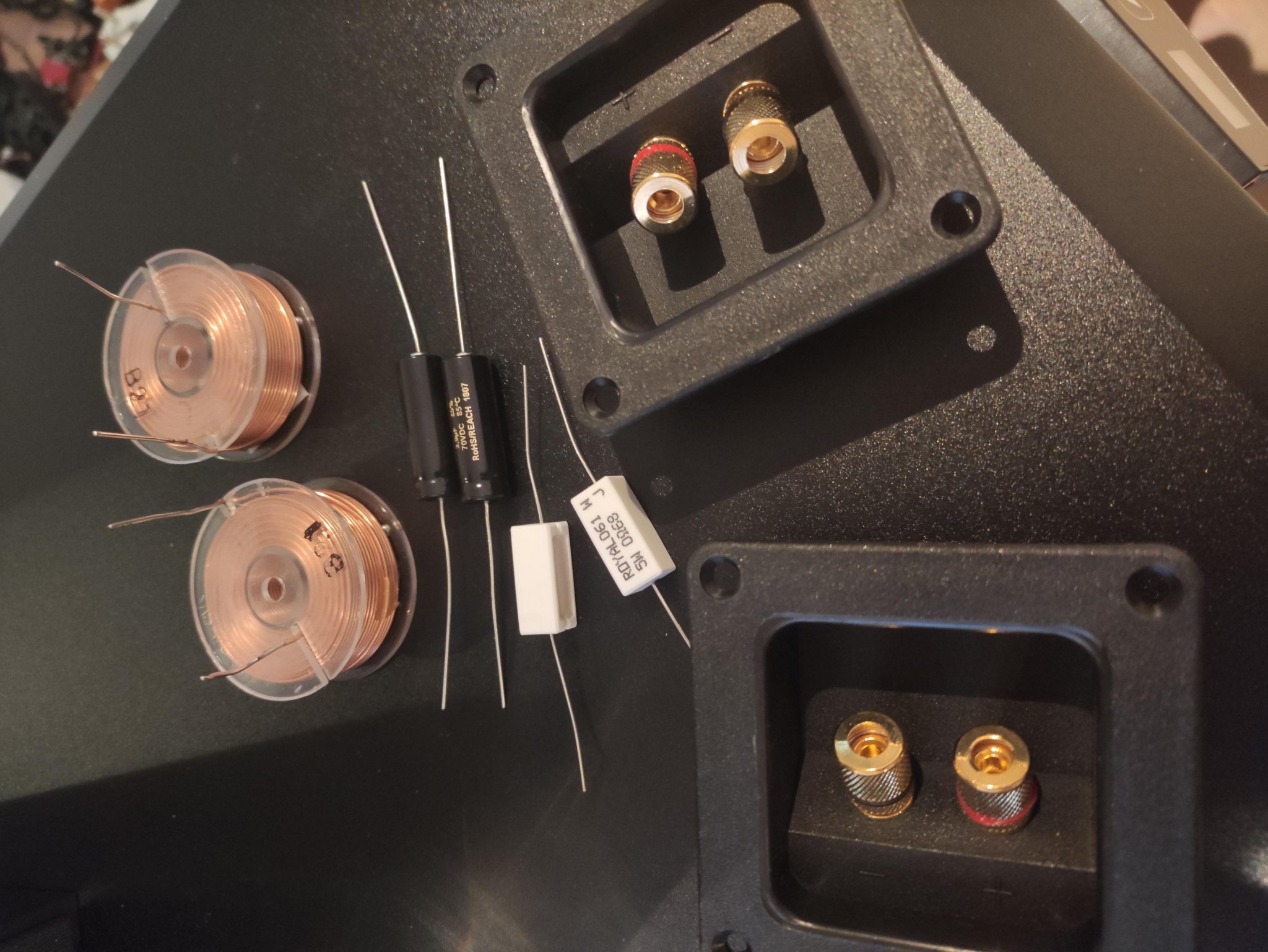

I'm a bit out of luck as I can't find a pair KEF Q100 crossover anywhere (there is 1 on Ebay), and I only have very basic notions of electronics (but I can solder!). I've read all the messages here, and based on RunningCookie the solution is likely to DIY the board.
From the above message, here's what I think I need:
1. Capacitor: Solen 3.9uF 400V
2. Resistor: Mundorf 0.68ohm (someone mentioned 5W ceramic)
3. Inductor: Solen 0.68mH 20AWG (someone recommended 0.68 lower resistance)
4. Terminal plates: any favourite?
5. PCB, green connectors, wires: recommendations?
Brownie points if you know a place that sells worldwide, as I'm in NZ and sourcing stuff can be challenging.
Thanks!
The required crossover could hardly be much simpler and the component values and schematic are clearly shown in post #116.
The type of terminal plate is relatively unimportant. If you choose one of a decent size, the components could be hard wired to the rear of the terminals thus obviating the need for a PCB. Hot glue can be used to secure the components to the rear of the terminal plate.
Happy soldering!
Happy soldering!
