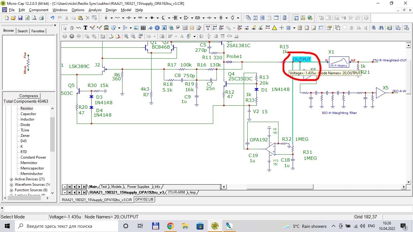

DC Servo using the OPA1656 CMOS Opamp

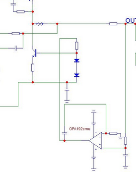

Seems that DC servo is used as virtual ground for biasing resistor of the CCS at SE output stage. Varying current through diodes provides enough Vbe variation on CCS, to compensate for any change at the output.
Yes it is. Simply download and test my Microcap12 circuit file [ https://www.patreon.com/posts/60580885 ] and you will see only several microvolts DC output offset [ https://c10.patreonusercontent.com/4/patreon-media/p/post/64958853/4e3bb8ef00ec42f4bd07663deeb42f06/eyJxIjoxMDAsIndlYnAiOjB9/1.jpg?token-time=1660953600&token-hash=wbYAnpmA35FwAhB0ZRlQjzJtwDKbNaamVIeCMcg3QTg= ] . more detailed here https://www.patreon.com/posts/1-5-mikrovolta-v-64958853

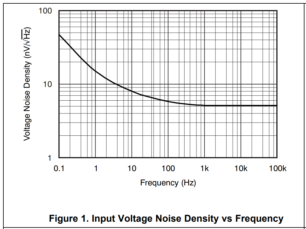

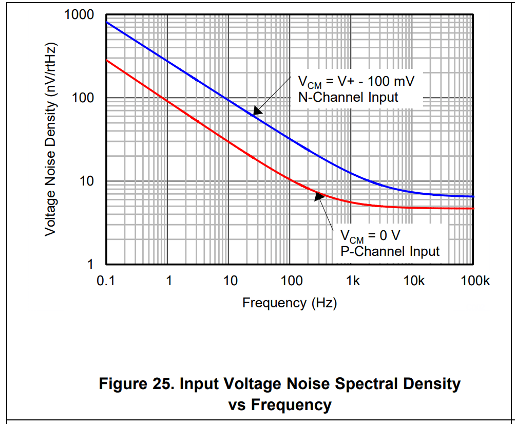

How about LF noise? OPA192 has 100 nV/rtHz at 10 Hz while OPA1641 has 8 nV/rtHz.

By the way, one of Nick's diodes became a resistor:
That seems more logical, as D1-R33 and Q4-R12 now form a current mirror. Nevertheless, I'm still curious about the control range.
The main advantage of such a DC servo (vs servo output to the input stage) is not adding noise. It is very important for lov-level preamps. I have seen it in Microcap clearly. And don`t worry about control range - OPA192 is rail-to-rail and its output range is fully enough to control Q4 current from 0 to twice of normal.
How much input offset does that correspond to? Is that more or less than the maximum VGS mismatch of the JFET pair?
If you need only a small control range and are worried about noise, you can also use a voltage divider to attenuate the integrator's output voltage. That seems more predictable to me. In either case, you have to check whether the worst-case offset and the maximum expected deep subsonic input signal can drive the DC loop into clipping.
