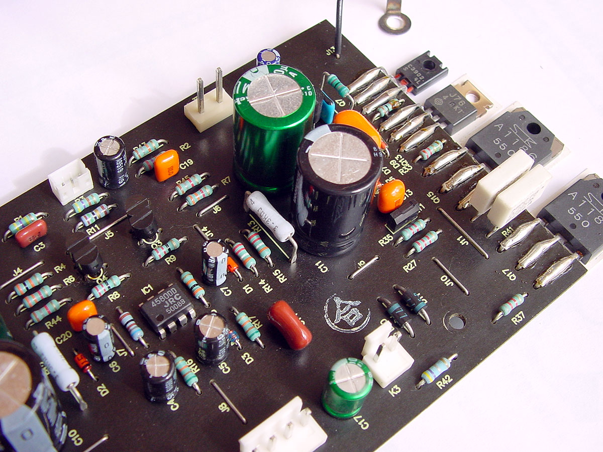

I opened mark Levinson No.33 .
Accuphase E210 E405. A60
PROCEED AMP2
They all use ordinary 4580。5532 operational amplifiers.

OK, see OPA192 datasheet: THD+n 0.00008%, full 36-V differential input range, true high-impedance differential input capability for highvoltage applications {patented input protection architecture), integrated electromagnetic interference (EMI) filtering, internal phase-reversal protection, patented output stage capable of driving up to 1 nF of pure capacitive load, ... and I repeat again 5 microvolts (not milli) offset with jfet 5 pA input current and noise 5.5 nV/√Hz. Power ±2.25 V to ±18 V with 1 mA quiescent. And 3.5$. What else do you want for DC servo and is anything better?
For a servo, an op amp with good DC specs is needed. AC specs need not be all that good. You especially want low DC offset and low input bias currents that could cause a DC offset to occur, since the sole purpose of a servo is to null out DC offset.
It depends. Some circuits have the servo op-amp output straight in series with the lower feedback resistor, or with a branch of it (when it is split up in two resistors, one resistor straight to ground, the other to the servo op-amp output). The feedback resistor then injects signal current into the op-amp output, and any distortion components or noise at the op-amp output directly affect the distortion or noise of the amplifier.

In fact, the offset voltage is often overrated. In a power amp, a few mV offset is totally irrelevant.
So paying a premium for 10uV offset opamp is money wasted for me.
Low LF noise could be a factor, not sure because the integration cap has a higher impedance at LF and thus also generates noise.
I haven't done the sums, maybe no factor, maybe dominates. And what about the usual 1M R?
