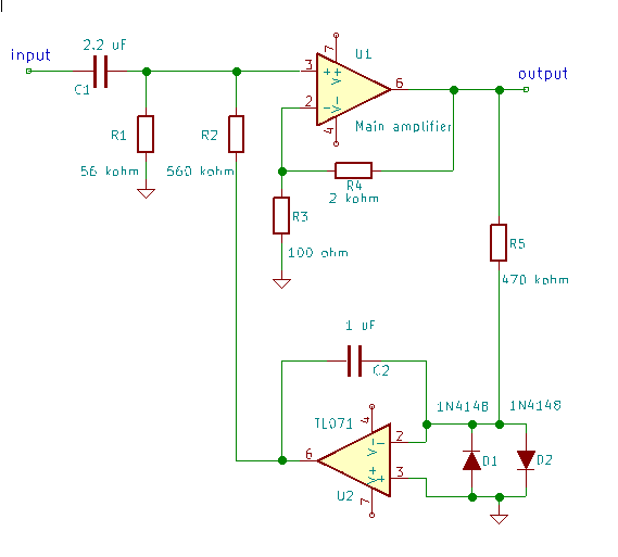

For what it's worth, my favourite type of DC feedback loop is as shown here. Nothing goes wrong if whatever drives the input has a large DC offset, it can handle reasonably large subsonic signals, the distortion of the op-amp (which hardly has to handle any signal current anyway) is filtered by the input capacitor and you can design it to have a second-order Butterworth response that gets more damped if the preamplifier has an output resistance or capacitance.
Main disadvantage: no-one likes it. People who dislike DC blocking capacitors don't like it because of the DC blocking capacitor, and people who don't like DC servos don't like it because of the DC servo. That is, no-one except QUAD likes it, as I later found out that QUAD uses the same principle in some of their amplifiers.

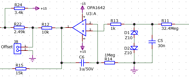

It’s similar to what I use. Mostly I just use a pot to dial out offsets, but if using a servo take the injection points to a low value R in series with R1. You can further decouple this with a suitable cap as well. Typically I use a 10 to 22 k bias resistor, 100 ohm in the lower leg and my R2 is 22k-47k. For C2 and R5 I use 2.2uF and 1Meg. I’ve never had a problem using a TL071/2 in this position.For what it's worth, my favourite type of DC feedback loop is as shown here. Nothing goes wrong if whatever drives the input has a large DC offset, it can handle reasonably large subsonic signals, the distortion of the op-amp (which hardly has to handle any signal current anyway) is filtered by the input capacitor and you can design it to have a second-order Butterworth response that gets more damped if the preamplifier has an output resistance or capacitance.

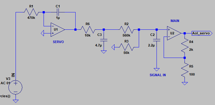

Maybe many would if someone pointed out that low pass frequency of such inverting servo can easily be 0.002 Hz, with -100 dB impact at 20 Hz (-134 dB at 1 kHz). That’s how was my attempt with OPA1641 and inverting servo. I had to decrease C2 to 150 nF, as servo was too slow for changes at amplifier power up.Main disadvantage: no-one likes it.

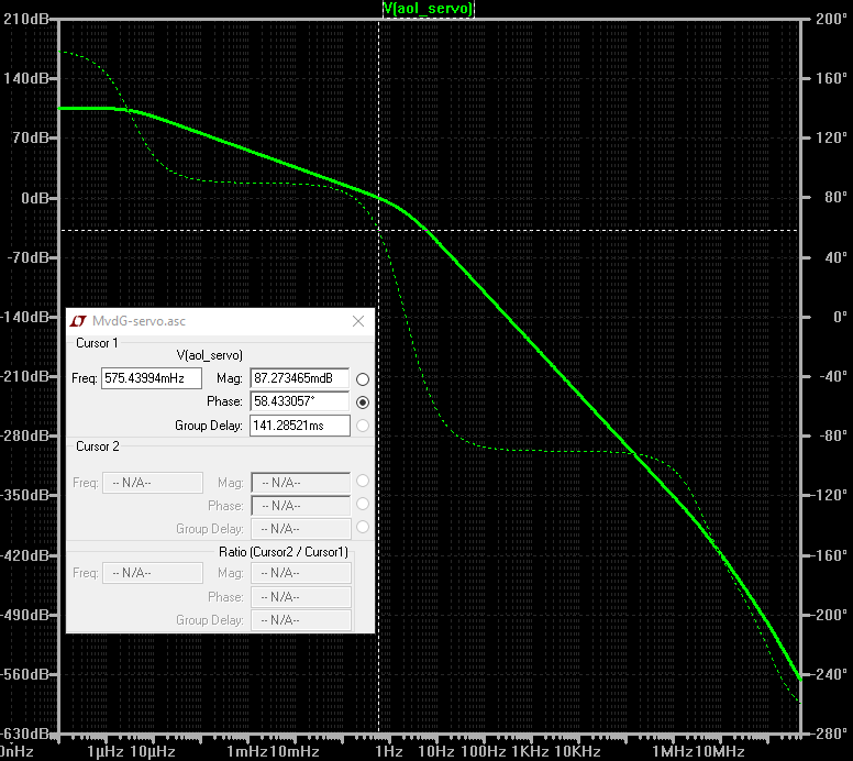

Thanks for that, this looks like a remarkly simple and well-dimensioned 2nd-order servo, doubling up as 2nd-order (Butterworth @1Hz) signal response. And is benign wrt to source impedance, open input is behaving well.
Did some loop gain spice'ing (@simon7000), the servo's open-loop gain has a robust 67deg of phase margin at the intersect with unity (as feedback factor is unity).
I could even introduce another pole after the integrator to get more attenuation in the passband with only minor impact on the alignment (58deg phase margin):
That will also result in a negative real zero in the response from amplifier input to output. I expect it will be almost but not exactly covered by a pole, and the pole-zero pair will affect the flatness of the response in the audio band to some extent. No idea if the impact is big enough to worry about.

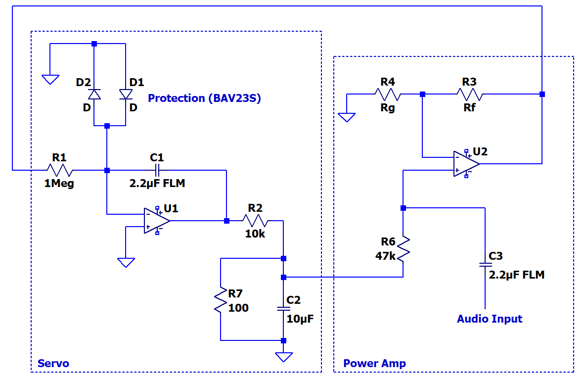

The extra zero is set by the parallel combination of your R2, R6, R7 and C2. I haven't found a way to calculate or approximate the location of the third (closed-loop) pole yet.I'm doing it like this. On a CFA amp , the inverting input is low z in so its not a convenient place to inject a servo signal. This works well. U1 is a TL071.
Do you see a small abberation in the frequency response around 160 Hz?
One thing I forgot to mention about this circuit
is that the input impedance of everything to the right of R1 is a resistance R2 in parallel with an inductance L = R5 C2 R2/(1 + R4/R3). Once you know it behaves as an LR parallel circuit, designing for a Butterworth response and figuring out what happens with a nonzero source impedance gets much easier.
Hello MarcelThe extra zero is set by the parallel combination of your R2, R6, R7 and C2. I haven't found a way to calculate or approximate the location of the third (closed-loop) pole yet.
There is no frequency aberration.
