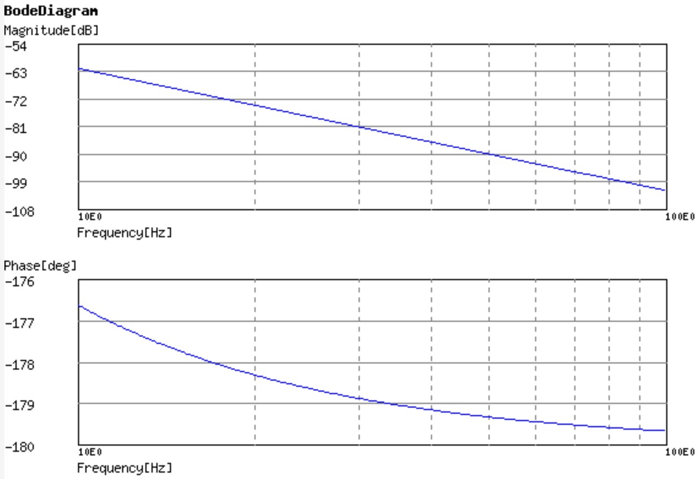

I see. I was not expecting much impact due to the ~ Hz level integrator time constants and >> 10kOhm load on the output of the TL071/72. Given those parameters and the TL071/72 performance/gain/PSRR/CMRR/distortion/etc at those frequencies I thought the TL071/72 would be very safe.
What TL071/72 performance characteristic might show up as a measurable or perceivable limitation? What sort of back-of-the-envelope calculation could show/quantify the concern?
After all the Douglas Self MC based 60 dB LNA design achieves quite impressive noise and distortion performance for only one NE5534, one TL071 servo and three TO92 transistors. (So after building that LNA I later used the TL071/72 in other servos without really much of a second thought.) I don't have Cordell's book. (Perhaps I should put that on the shopping list?) Does it have calculations or measurements that dig deeper into this topic?
With -63 dB and -176 degrees at the output of the integrator (at 10 Hz) I am not expecting anything beyond a very small gain reduction. (TL071/72, 1% metal film, PP capacitors and regulated supplies.)
In other words I am expecting a heavily attenuated/filtered but very low distortion and low noise signal to be applied as negative feedback. At these low frequencies and high load resistances I expect the distortion to be exceedingly low.

The servo works only as a low pass (integrator actually) thanks to its loop gain at high(er) frequencies that provide the feedback. So I can understand that with not-so-hot opamps there will be signal and/or distortion at the servo output.
But as Marcel noted, it depends a lot on the circuit and how 'aggressive' the servo is.
Note that with an amp with -100dBV distortion, an output of 10uV of the servo will have the same level.

It would seem to be silly to not have attenuation on the Servo opamp output. As the greatest correction required should only be in the millivolt range I would expect at least a 100 to 1 reduction along with a low pass noise filter. It seems easy to get a multi-pole filter function with a simple filter on both input and output of the Servo amp.

Sure, that's smart, and I assume that's one of the things Marcel implied.
But you need to be carefull with additional low pass filtering of the servo output.
Before you know it you have a 2nd order system and LF oscillations.
You should make sure that the integrator time constant and the additional filter TC are sufficiently apart.

It's a matter of preference, but I wouldn't want to design a DC servo such that a large subsonic input signal can clip the op-amp and cause offset if the clipping is asymmetrical.
