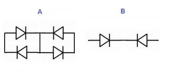

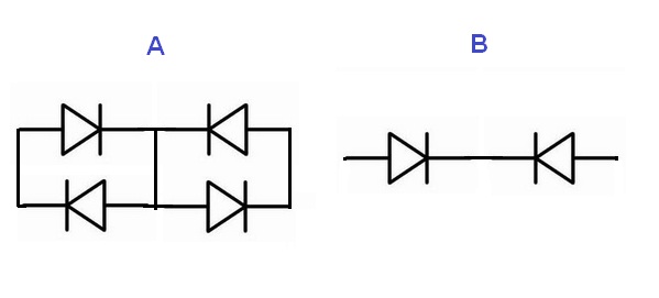

Questions.
What the forward voltage will be in each configuration (0.7 standard)?
What are the benefits of A over B and vice versa?
If the Caps are in series & back to back (+ to +) what would the combined Ripple Current will be?
Will it be safe to run all my equipment through a DC filter from one outlet & a power strip,
if the capacitors ripple current and capacitance will suffice?
Is a fuse is mandatory in the DC Filter box?
If yes what will the value would be?
(larger then the total consumption in amps and lower then the ripple current?).
The hum is from my Studio Monitors toroidal transformer that rated 110W (0.5A) 220V each.
I've read that in a small transformers all of this is insignificant.
So, am I doing it for nothing or will it help the small ones to?

Andrew:
In other threads you talk about reverse voltage (forward Voltage?) of the capacitor itself;
thats why we want to put the caps back to back in series not in parallel like Bryston.
So putting the caps in series bypasses this danger of having max of about 1-1.5 Vf of the cap?
I chose high power diodes that combined will form about 2.2 Vf (~1.1 each); is it too high for the caps (same question)?.
