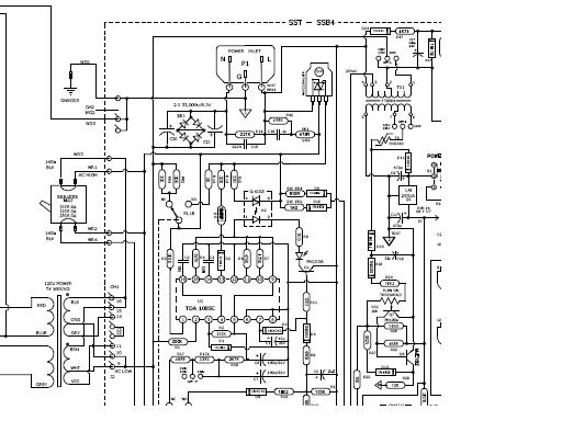

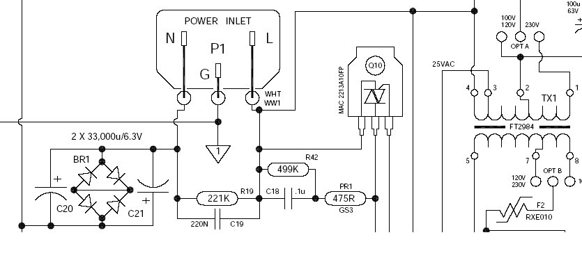

I've attached a snapshot of a schematic from such a well-known manufacturer. They use 33,000uF, 6.3Vdc caps, connected in parallel.

The Bryston Dc blocker shows inverse // caps with a 1.4 dual diode bypass. The amp manufacturer has used the cap manufacturer's data on acceptable reverse voltage and taken advantage of the 1V to 1.5V reverse quoted by some of them.

I took a snapshot from a PDF schematic downloaded from Bryston. It's for a 3B-SST amplifier. Closer inspection reveals that the transformer originally shown is not the power transformer. I've attempted to attach another screen shot.
However, the power transformer does seem to connect through the DC blocker through a varistor. Also, there is a second diode bridge connected to the secondaries of the main transformer, without the capacitors of a dc blocker on page 1 of the schematic. I'm not sure what that is intended to do.

Look again at the Bryston layout.
The DC blocker is on the neutral line and there are only two routes for power to get out of the amp.
first exit:- the interference switch suppressor.
second exit:- the DC blocker.
Almost no power will exit through the suppressor which should tell most of you that essentially all the power passes through the DC blocker.

I believe Bryston use this DC blocker circuit in order to make their Triac inrush current limiter alias power switch to work. DC on the mains can disturb the zero crossing sensing circuit, and can make the triac triggering on the wrong moments. As a bonus it remove DC offset from the line. In Bryston's case it didn't help for transformer humm. I owne several Bryston amps till the 7B's and many of my clients own 4B's and all the (expensive) Plitron transformers have hum in more or less extend.
If people intend to built a DC blocker themselves I strongly advice to simply copy the bryston one with a bridge rectifier, to stay on the safe side.

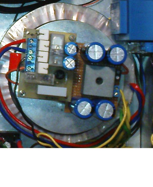

I have made this dc filter and now has stopped the noise from the transformers.

Here you have another DC Blocker this one I use in my mono blocks and this works perfect:

Thank you for posting this topology. Must actually be the royal way and I have never see before in commercial products. The schematic collection, that I know from commercial products, you will find by post #1 about
http://www.diyaudio.com/forums/soli...t-buzzing-toroid-transformers-what-right.html
What is the reason for the choiced polarity of the electrolytic caps (positive pole to anode and negative pole to cathode)? The voltage in the reverse mode is commonly 1V (independend of the voltage values in normal mode).
