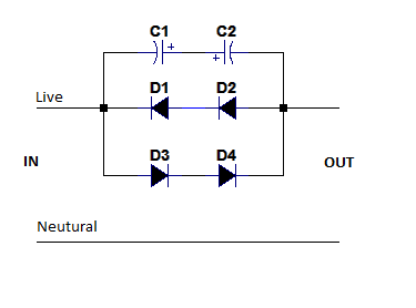

I understand the formulas involved.
Using Ohm law I calculated that for 10A and 2 Vf of the diodes it would be 0.2 ohm of resistance.
Using 1/(2*Pi*50*0.2) I got ~16000uF.
So at least two 32000uF caps in parallel (back to back).
I plan to use 47000uF 16v Nichicon with 6.93A ripple Current each.
The diodes I use:
http://www.rectron.com/data_sheets/10a05-10a10.pdf
So the quiestions I posted are still valid.
1n5401, or 5402, or 5403, or 5404. Two in series in each direction (4 total).
10mF to 20mF 16V electrolytic. Two in series +ve to +ve.
The 10m to 20m capacitance can be a parallel bank of lower value capacitors. They might be cheaper. I use 3300uF 16V, 5 in parallel in each direction for a net 8m25F which has an impedance of ~0.4 ohm at 50Hz.
2Aac will generate ~1.1Vpk across the caps and diodes. The diodes should not pass when 2Aac is being drawn.
That allows ~500W to be consumed and the bypass diodes should not pass.
Current pulses exceeding 3Apk will bypass via the diodes.
Forgot to mention, in my country mains are at 220V 50Hz AC.
Is it possible to use diodes 1N5408?
Did I get schematic right?
Normally when I do such things I join the two minus. This just because the Capacitor chassis normally is that one and this can prevent shorts if they touch by chance putting them really close. There still are around non -insulated ones, or the insulator may fail .
Not really important, nor necessary, just I belive between the two choices, that's the more logical.

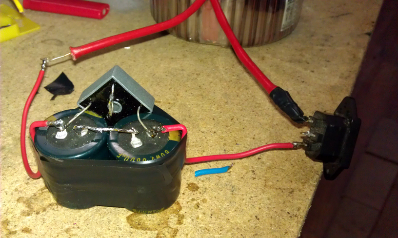

Did mine MacGyver-style (because of duct tape) with 35A bridge reticifer and two 6800uF 80V caps. Works good, transformer noise went down a lot.
