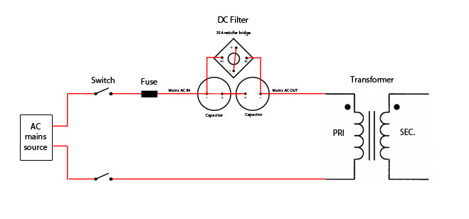

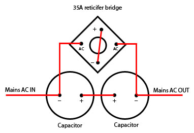

* reticifer bridge's + and - wires is conected to each other
* reticifer's AC wires is conected to each of caps - terminals (one AC wire to one cap's -, second AC wire to other cap's - )
* capacitator's + terminals are conected to each other (+ve to +ve)
* filter is wired in series with transformer
Read that article and choose your parts wisely. Proceed with caution and be careful. Check your wirings many times before powering up anything. This is mains AC we are talking about, not a flashlight 9 volt battery. Schematic in article. Explained connection diagramm in atachments. Hopefully this will help.

allright, this explained this way i understand everything! And i know it's mains AC, so i am asking beforing doing anything Very helpfull! thanks
but i have two more questions...
on this:
-filter is wired in series with transformer

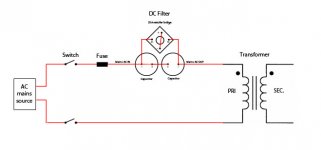

what this mean? the live wire from AC comes from the socket then cuted and go to - cap and leave - cap on the other side to the transformer!
can i put this in a box metal or plastic.... like this: (from socket wall, then the filter on the metal/plastic box going to the iec plug on the active speaker?)
-And the other question ...
how to find the live wire on the cables? by color it's simple... but the plug turned 180º it's the neutral cable... is there a domestic way to find the live wire to put this filter?

Just do it like in schematic, I don't have exact live and neutral markings in my country either.

I designed & built the attached filter schematic to help with a minor mains DC issue that causes my Naim system to hum more than it should. All my boxes are quiet(ish) except the CDP. But the main problem I had with DC was that the hum tone & level would change momentarily for for short periods, this is distracting.
The filter is placed in my 8 way power strip & filters 6 of the outlets. Its sized for current draw with 230v 50Hz up to 750VA.
The filter fixed the DC issue completely, but it did not stop the CDP transformer from humming. Its just slightly quieter but the DC caused tone variations are gone.
The message here is that no filter will stop a transformer that is inherently noisy from humming.

targeting, if you are asking those questions, you should not be working with electricity.
The filter can be connected in live or neutral, reversing the cable connection will not harm it.
The bridge needs to be same or higher rated voltage as your supply e.g. if you have 220v, then a 250v or higher bridge is OK.

Tief,
you have chosen to show/use the wrong implementation of the bridge rectifier for your DC blocker.
Short the ~ to ~
Short the + to -
Connect mains incomer to ~
Connect outgoing mains from + or - (they are both connected).
This implementation puts the diodes in the bridge in parallel rather than the series connection you show.
The double shorted version has half the Vdrop and double the current capacity cf. the single shorted version.

Hi Tief.
I am not sure if your post is a statement or a question. But whatever, this is my thinking.
The DC block filter running in an AC system will require either
(1) Non-polarised capacitor (not practical for size considerations)
(2) 2 or more polarised caps in parallel non-polar config
(3) 2 or more polarised caps in series non-polar config
I am not sure series or parallel is that important & am not dramatically persuaded one way or other.
However I opted for my method for longevity reasons:
If two, same-value, electrolytic capacitors are connected in series (back-to-back) with the positive terminals or negative terminals connected, this results in effectively a single capacitor that is non-polar, but the downside is it gives half the capacitance of each of the individual components.
But it gives 2x upsides:
(1) Doubles the operating voltage – 16v becomes 32v or you can safely go even lower as 2x series diodes limit voltage across the cap to 1.4v – but practically 1.3v
(2) Maximises ripple current through the cap assembly - As we all know electrolytic caps will withstand a small reverse voltage (around 1V is typical), this series connection method doubles that value & achieves similar or even higher levels of longevity, probably reaching many years even when permanently running.

In-rush aside, the filter is running with 95% reserve when my audio system is on idle & aprx 85% reserve when used at disco level volume.
Additionally I designed my filter for 750VA to permit a power cut followed by uncontrolled switch on.
But it is actually running a number of transformers - the largest is 400VA - that collectively do not exceed that value at inrush, plus they are normally not switched on simultaneously.
The Circuit from which post ?Tief,
Short the ~ to ~
Short the + to -
I haven't until now a clearly statement to (2) and (3), because I am also not sure about the behaviour while high current flows.Hi Tief.
about
http://www.epcos.com/web/generator/...__en.pdf;/PDF_GeneralTechnicalInformation.pdf
there isn't to read about "back to back" serial connection.
I have found only this statement about
Electrolytic capacitors
The only downside for electrolytic capacitors is that their metal-to-metal oxide interface is a rectifying contact. That is, it is a good insulator only in one direction, and in the other it conducts electricity. That is why electrolytic capacitors are non-polar, and the only way that non-polar electrolytic capacitors can be created is to use two oxide films back to back.
Andrew, it's better to have the diodes in series because then the blocking will get more effective.Tief,
Short the ~ to ~
Short the + to -
In my design I have three diodes in series.
I will accept that it is a design decision depending on the operating criteria to whether 700mV or 1400mV or 2100mV of bypass voltage is allowed across the diodes.Andrew, it's better to have the diodes in series
I cannot accept that it is better to have series connected diodes when Tief is is asking about excessive diode Vdrop and suggesting the solution is massive diode current capability.
The designer chooses to suit the conditions.
Taking the point made by Mikeb that 1000mV of reverse voltage is tolerable on a polarised electrolytic, then increasing the bypass voltage to double or triple value cannot be good for paralleled electrolytics.
However, series back to back electrolytics behave differently and in this wiring arrangement your double or triple diode solution allows smaller capacitors to be used for the same AC current flow that does not bypass through the diodes.
- DC filter
