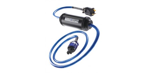

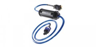

Guys, we are in the wrong business. Go see what these commercial DC traps cost when put into an exotic high-end box!!
