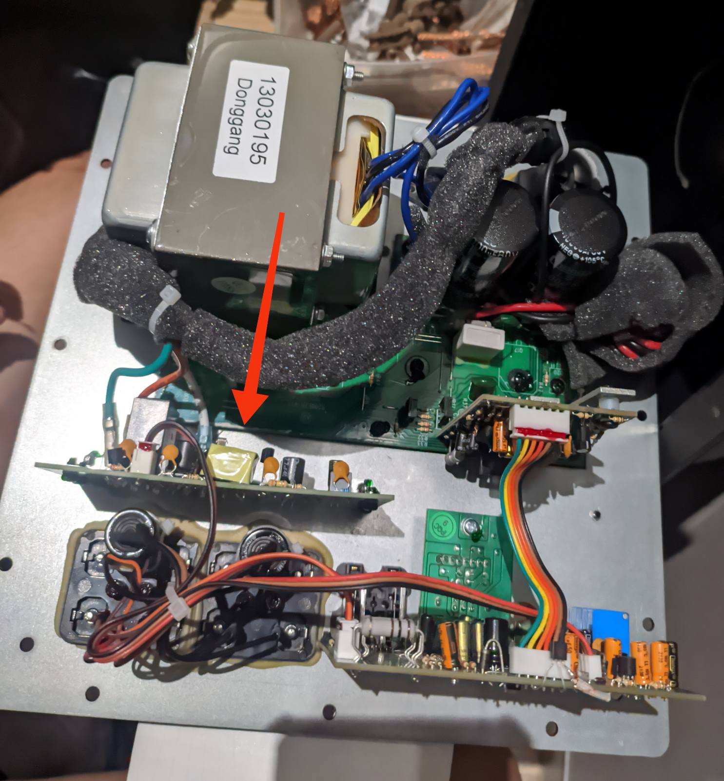

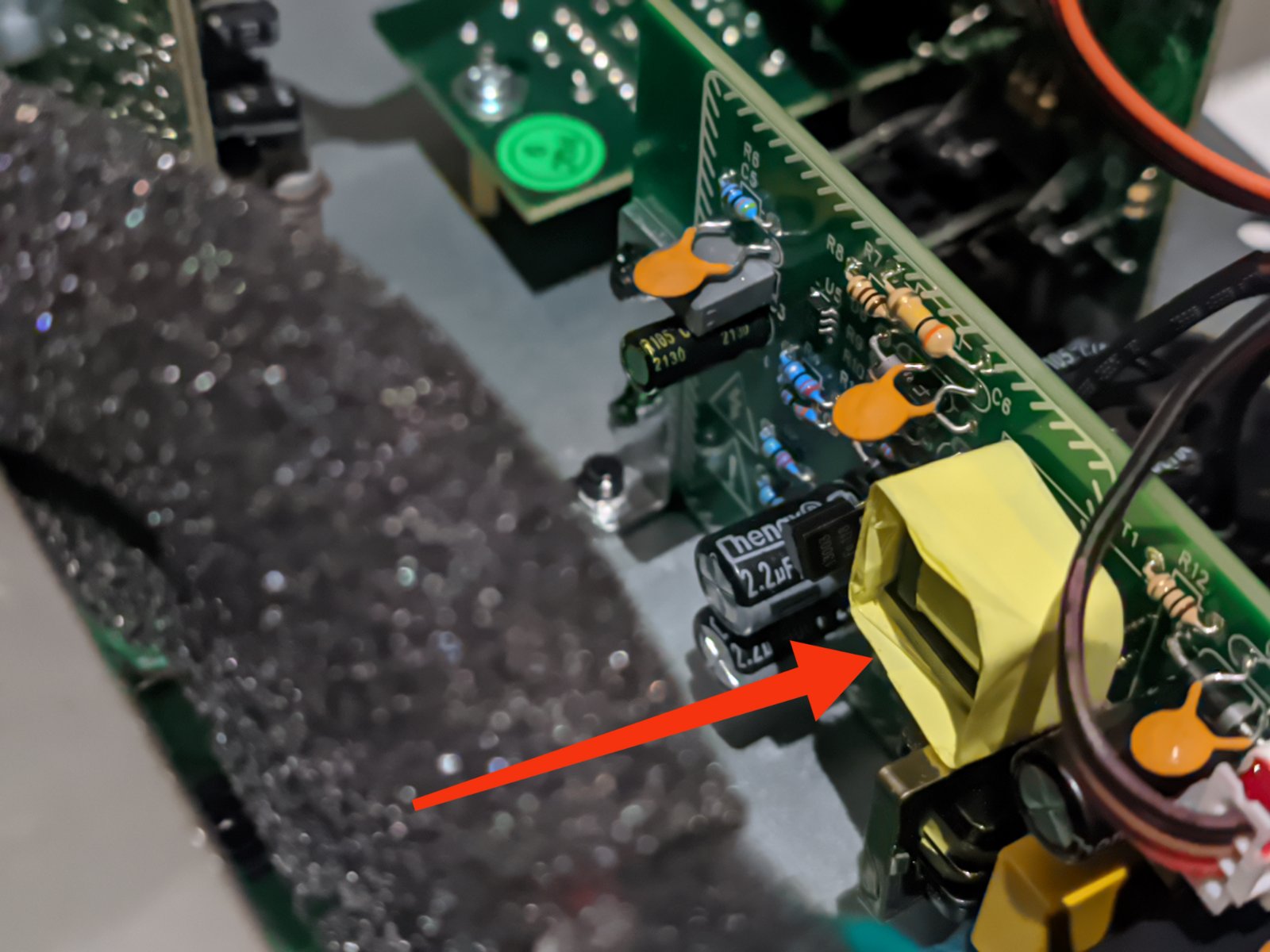

I had the courage to open it up and I probably have found the high pitched sound, it is coming from one component (I think).

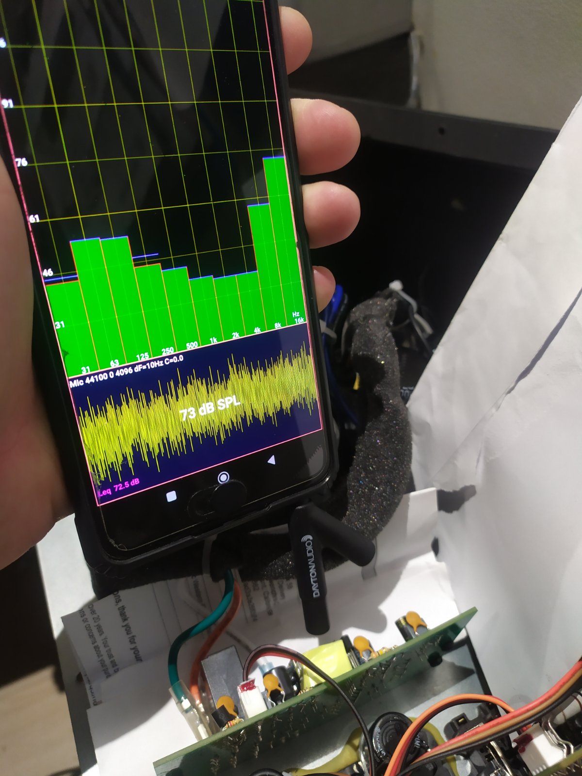

I used a phone with a connected Dayton Audio iMM-6 mic, and it seems at around the 16khz-20khz range as I expected (very annoying sound).
I went through each part of the amp to localize the high pitched sound, and it seems this component was the culprit (see pics with red arrow).
I tried touching it with a plastic rod, but there is no mechanical vibration (well not felt anyway). I also tried tapping it or leaving (pressing) the plastic rod on it to try and see if the high pitch whine lessens or goes away, without any success. It also doesn't heat up (I measured it with a laser thermometer), so heat wasn't the issue. It whines even if the unit is turned off (but plugged into the wall outlet).
What component might this be? The PCB board that it is located from isn't present in the SPA240 that the previous poster sent (you may compare pics), so it may be a new addition (to a new revision).

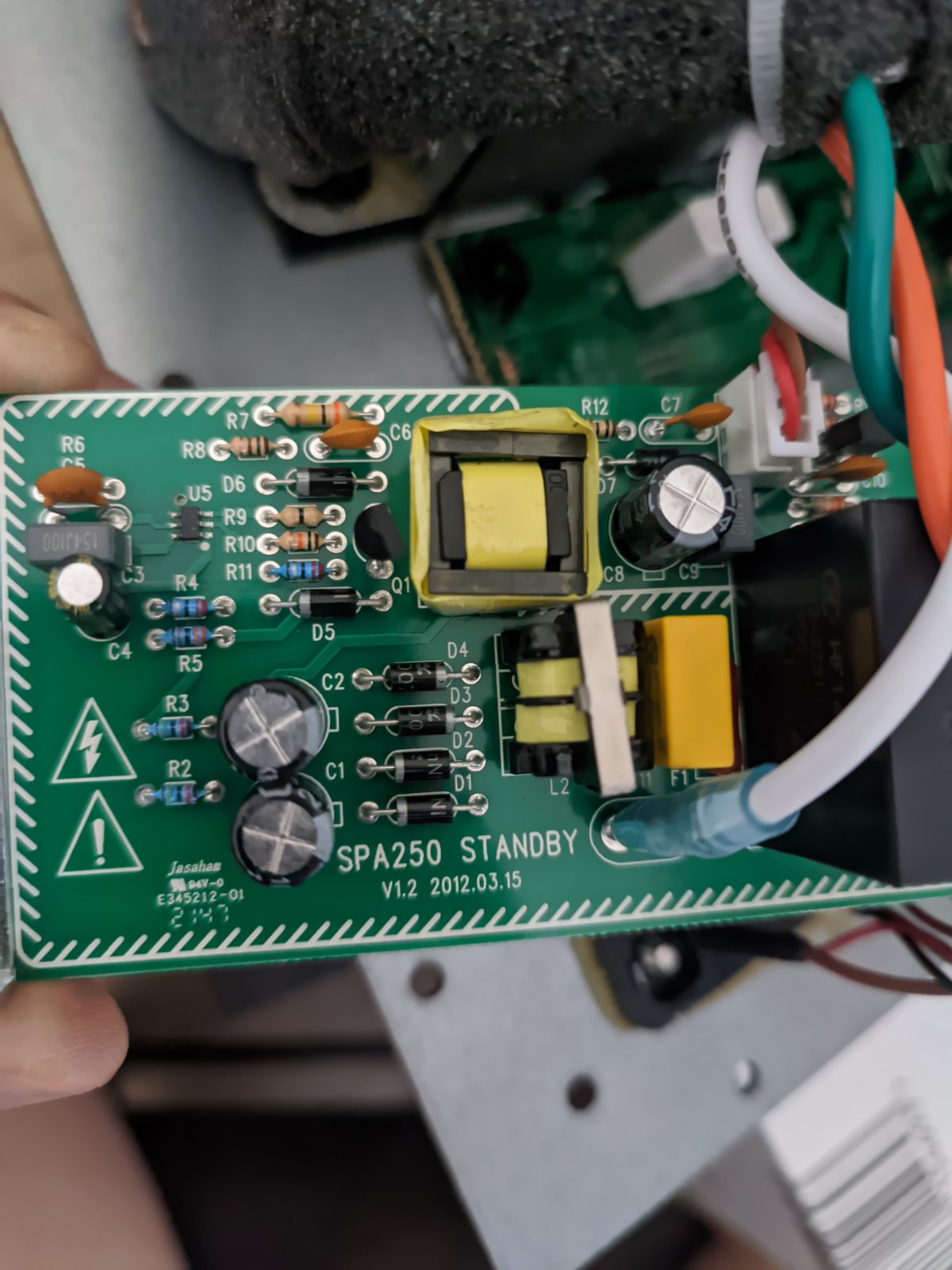

You Asked, "What component might this be? The PCB board that it is located from isn't present in the SPA240 that the previous poster sent (you may compare pics), so it may be a new addition (to a new revision)."
Congratulations, I think you found it! Your photo, 1.JPG shows the new circuit card in the SPA250. This board was labeled STBY in my amp. It has the ON-AUTO-OFF circuitry and power relay. It also has a small DC power supply that is always on, even in the off mode. The component identified by your arrow in 2.JPG is a low current transformer for this P/S. It is very possible this transformer is resonating at a high frequency (Directly below it is a yellow inductor). There are a few options available.
1) Transformers are usually dipped in electronics varnish. This varnish helps keep the windings intact while eliminating moisture and vibration. It might be possible to remove the transformer and dip it in varnish. After a 2-day cure, the transformer can be re-installed and tested.
2) A transformer shop can rebuild the transformer.
3) You might be able to buy a replacement transformer from the Manufacturer of the SPA250 or from the Internet. The Transformer has markings on it- usually a date code and part number.
4) The scariest possibility – some circuitry external to the transformer is causing it to resonate or apply DC voltages to the windings. . . This is also the lowest percentage failure. Although rare, I have seen both things happen.
My best guess (stress the word ‘guess’) is the transformer was manufactured incorrectly and needs further investigation. You can also perform a sanity check by using passive resistance checks on the components around the transformer. If you can read the transformer marking, please post it. You are getting really close, well done! EVMan.

Thanks so much for your comprehensive reply EVMan.
Your explanation about the small DC power supply with the low current transformer resonating makes good sense.

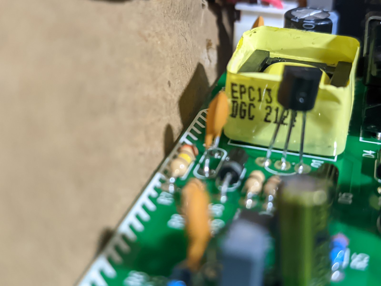

The transformer is labelled:
EPC13
DGC 2128
Unfortunately, I do not have any experience with regards to varnishing a transformer (especially this small), as I just might ruin it even more.
Is it possible to just cover that transformer with glue gun or maybe silicone sealant to "hold" it down or absorb/cover the resonance?

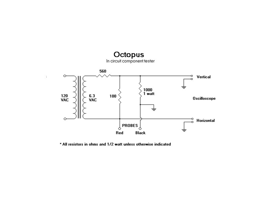

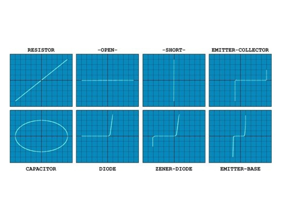

Not sure how competent with a DMM you are, but if you are comfortable, you can take measurements (in AC) on both sides and then measure in mm the spacing for all the pins and likely find a cheap replacement on AliExpress that is "potted/sealed" - I bought one a few weeks back for <$5 and worked great.

RE Transformers: Best practice for manufacturers is to apply Transformer Varnish prior to final test. The varnish does several things: (1) It protects against moisture, (2) aids in heat dissipation, (3) reduces vibration. The simplest method is involves dipping the entire transformer. The most advanced (and costly) method uses vacuum depositing. I would guess that this transformer missed the varnishing step altogether. Transformer varnish is a specialized formulation. It goes on as a liquid and dries to a hard plastic while also being heat conductive. Being a liquid allows the varnish to penetrate the windings before solidifying. If you re-dip the transformer, remove moisture by heating it up in direct sunlight for a few hours. A transformer shop will have the ovens, varnish, etc. They could even re-wind it if necessary. DO NOT use epoxy or any other substitute! Substitutes will not conduct heat away from the windings. . .

A quick update. The STANDBY board is essentially a PWM switching power supply. C8 is the output filter. This should be a SMPS rated capacitor. i. e. High Ripple current and low ESR, not a regular electrolytic. Good switching caps are made by Panasonic and Nicichon to name two. I was not able to verify the switching diodes in the flyback circuit- they should be fast switching types with soft recovery. . .
Current work involves generating a parts list and schematic. For those interested, the power supply circuit looks like a lift of Silicone General’s SG6848 PWM IC's reference design. I bought some old SPA250 parts for documentation efforts. When the SPA parts come in, I will finish the drawings. Famous last words.

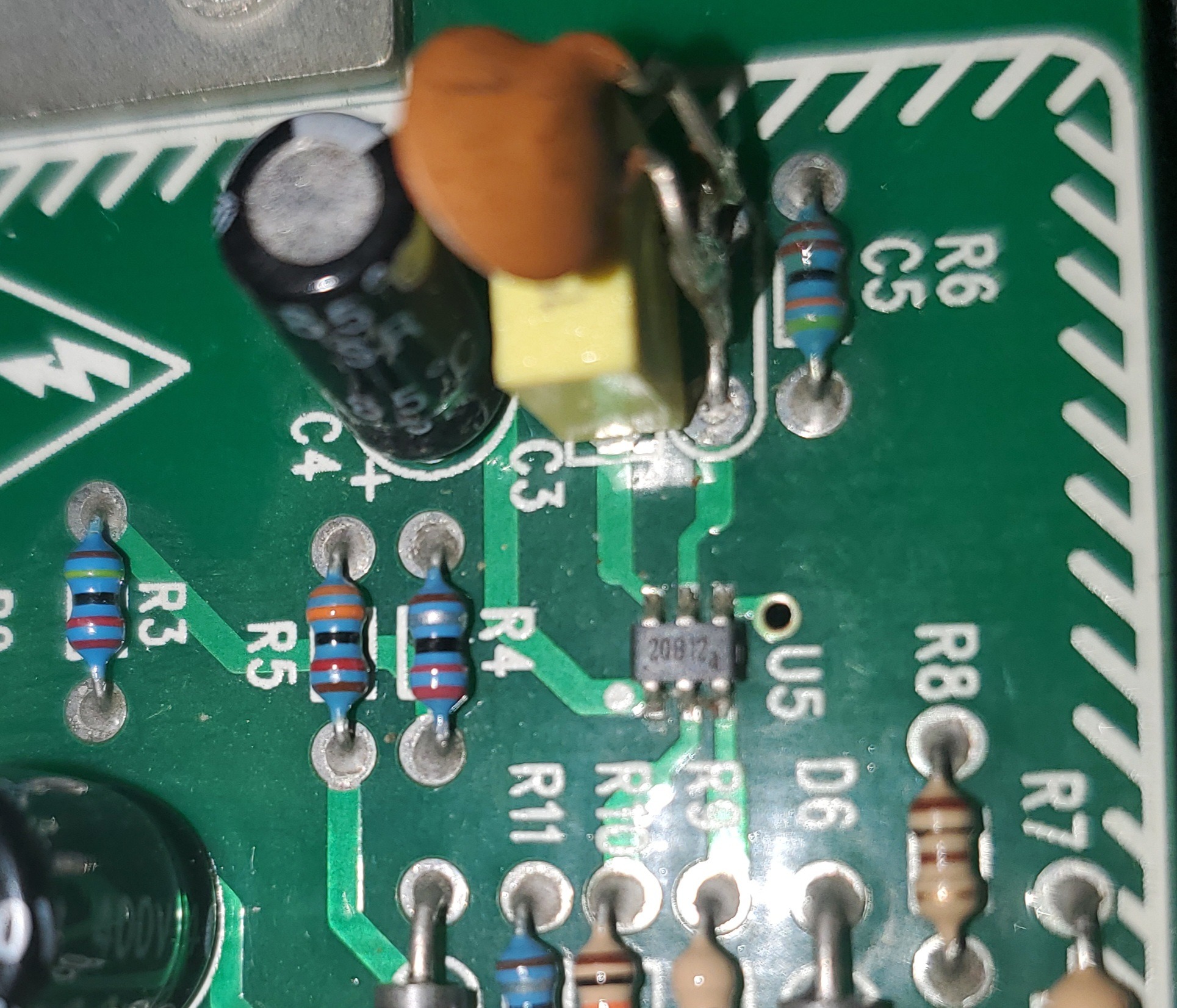

The SPA250 arrived in pieces as expected. The STANDBY board has two transistors, Q1 and Q2. Q2 is labeled C1815 and this correlates to a low Hfe NPN transistor. Q1 is more troublesome to identify. it is labeled "CSX13003H08" per the attached photo. Running various permutations of this number led to two viable possible alternatives: (1) a 600V MOSFET or (2) a 450V NPN bipolar. This is the main switching element for the flyback transformer, so I would expect it to be an 'N' Channel MOSFET. If anyone can shed some light on Q1 . . .
Same deal with U5, a 6-Pin SOIC. Markings include A67 and 20812 per the attached photo. I believe this is a SG6848 clone, a PWM Controller. However, I cannot find a data sheet. I believe that both Q1 and U5 are of Chinese origin. Any help in identifying either part would be deeply appreciated. Thanks- EVMan

U5 chip that got busted (there are very small burn marks in the board, more of black dust burns during the explosion)

Nail polish may or may not quiet the transformer sound level. It definitely is not thermally conductive. If you are in Manila, there is the electronics district. If you ask around, you should be able to find a "rewind" shop. They rebuild/rewind transformers, fan motors, etc. Simply bring in your SPA250 and ask them to apply the transformer varnish. Should not cost more than a Red Horse beer.
RXV: Yes, I have been in Quiapo (Manila) before. But it is very far from us here, and it is difficult nowadays to travel there (let alone find a reputable transformer repair shop there), as there are a lot of scammers and swindlers there.
With regards to transformer varnish, I am just thinking about it (but will not necessary do it) since I am not experienced in that regard (I might just mess it up more). I'll probably read up on it more to see if it is feasible
EVMan: My bad. I assumed that you were in Manila. Where are you, Visayas? No matter. DHL and FedEx are expensive overseas, which is why I suggested the post office. They were the most reliable, hassle free method in Thailand and Pakistan. Sorry to hear that the post office is unreliable there. Sounds like a board swap would be difficult.
If the Amp is working (with the whine), it makes sense to coat it. I would use nail polish as an absolute last resort. There should be a rewind shop in a town of any size. Transformer varnish and heat conductive epoxy are hard to find and expensive. So, it is really up to you. Short of swapping out the boards, there is not much else that I can do except answer questions . . . I will keep you informed via the main SPA250 thread. Good luck!! EVMan

I believe I made a boo-boo this time. This is going to be a long read (apologies for bothering your precious time). As discussed before, I initially planned to add some insulating varnish to the small "whining" transformer found in the Standby board.
I first removed the attached yellow Kapton tape surrounding the outer edge of the transformer, and found out that it was there to hold 2 pieces of small ferrite cores. I believe these 2pcs are the ones vibrating (hence causing the high-pitched vibration), since they're only being held by the yellow Kapton tape. I removed the 2 separate ferrite cores from the main transformer base (the one soldered to the board)
I also tried peeking into the center transformer part (where the copper windings are supposed to be for varnishing (as planned), but after peeling the yellow tape, I don't know of the dark yellow part (shown in picture below) are the wires already (just insulated), or just another kind of tape (I didn't bother to remove them anymore as I might just damage it more). So the varnishing plan is initially scrapped. Here is where my carelessness comes in:
I then re-attached everything back into place EXCEPT for the 2 ferrite cores from the small transformer. I wanted to test if those 2 ferrite cores were indeed the ones doing the vibration, hence I did not put them back.
I then plugged in the plate amp, and then turned it on. After a few seconds, I heard a loud "pop", as if a component exploded, so I turned off the amp immediately. The next day (to ensure that there was no stored energy for electrocution), I observed the Standby board to see on what chip/component might have exploded. I took me a while to find any physical damage, and unfortunately, of all the components to get destroyed, it seems it was the
So, there you go, another one bites the dust. I actually don't know what to do anymore, I should have left it alone huhuhu
(Note: Some excellent photos would not copy)
EVMan: Ouch! By omitting the ferrite cores, you radically lowered the transformer impedance. Low impedance = high current. Transistor Q1 is probably bad as well as IC Chip U5. Could have smoked the transformer windings as well. Can you possibly bend Q1 a little bit to get the part number and photo? This is why quality companies use transformer varnish . . . EVMan
RXV: Huhuhuhu it seems I really did a very bad decision in trying to "fix" it, which only got worse.
Based on your assessment, it seems that the Standby board itself is pretty dead and unusable by this point 🙁
Q1 is labelled: 13003 Fe 118
U2? I don't seem to find any U2 here, maybe you meant Q2?
Just in case, here's what's labelled into the
Q2: K130 C3198 GR
NOTE: Upon plugging (turning on) the amp, it only took around 2-3 seconds before the pop (explosion), in which I pulled the plugged immediately Other than the small burn marks on the U5, I haven't seen (or smelled) any other burn marks as well as any physical damage to the other components
EVMan: Hi RXV, how are you? Yes, your STANDBY board is bad now. Thank you for the part number info on Q1 & Q2. I have not been able to find good part numbers for U5 or Q1 (sorry about that- I meant Q2, not U2 in previous post). Parts Express does not carry any replacement parts for the SPA250. I have a working (I think) STANDBY board. That is one option. Another option is to contact the manufacturer directly and see if they will sell the STANDBY Board. I had all of their info and was going to contact them, but then I found C8 was bad and dropped it. Chinese manufacturers vary greatly. Some will DHL the board for free, others will not even acknowledge your message. Give me 24 hours to come up with a good idea. 🙂. EVMan
