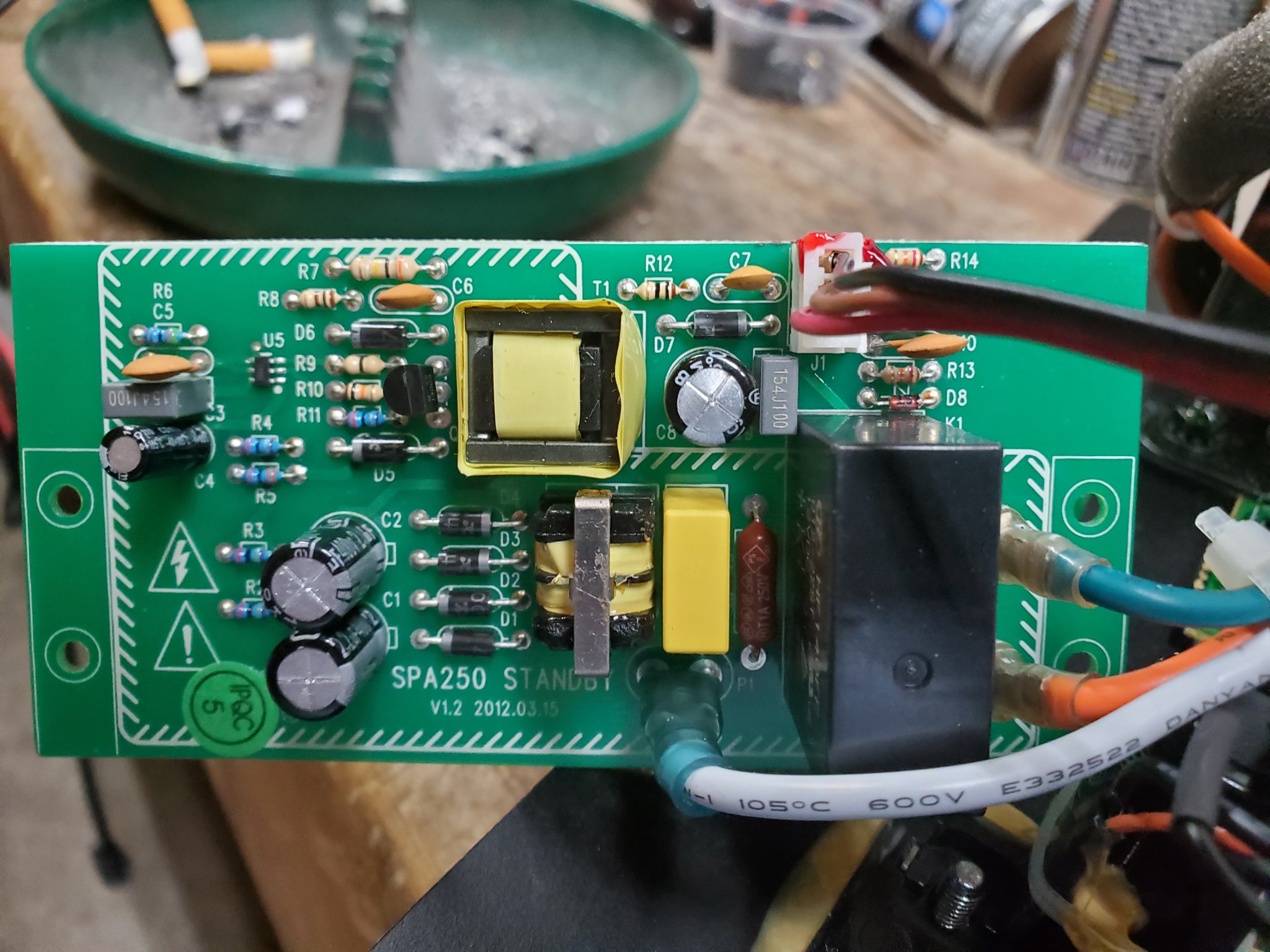

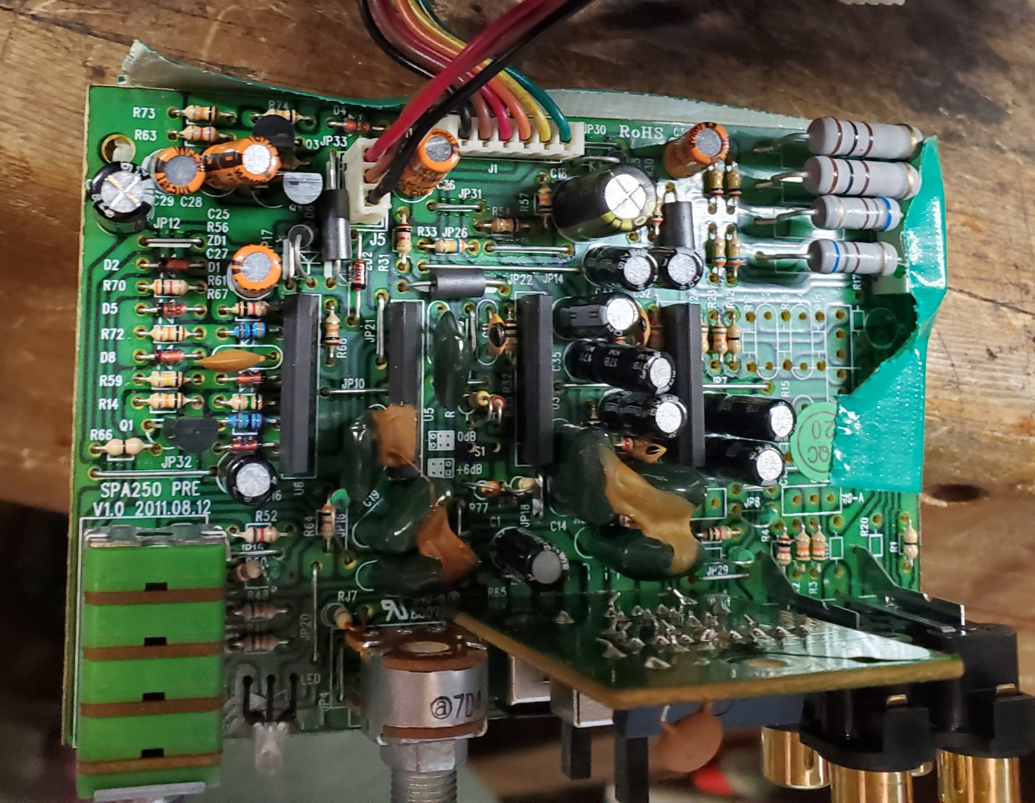

Another quick update. I took the Preamp and the Standby board out of the SPA250 amp for a better look. The Zener RS resistors are new 3k0 2W units. The filter cap bleeder resistors are also upgraded (R40, R41 3k0 2W). They have not discolored over six years, so it looks like a good fix. However, the capacitor that sits next to the Molex connector (labeled C8 on this version) is buckled. This a 16Vdc 470uF cap. The cap is on order now.
For what it's worth, pictures of the STANDBY and PRE boards are attached. Note the date codes of the PCB Artwork. I would still love to see some more documentation. Thanks to everyone who contributed, very much appreciated. EVMan

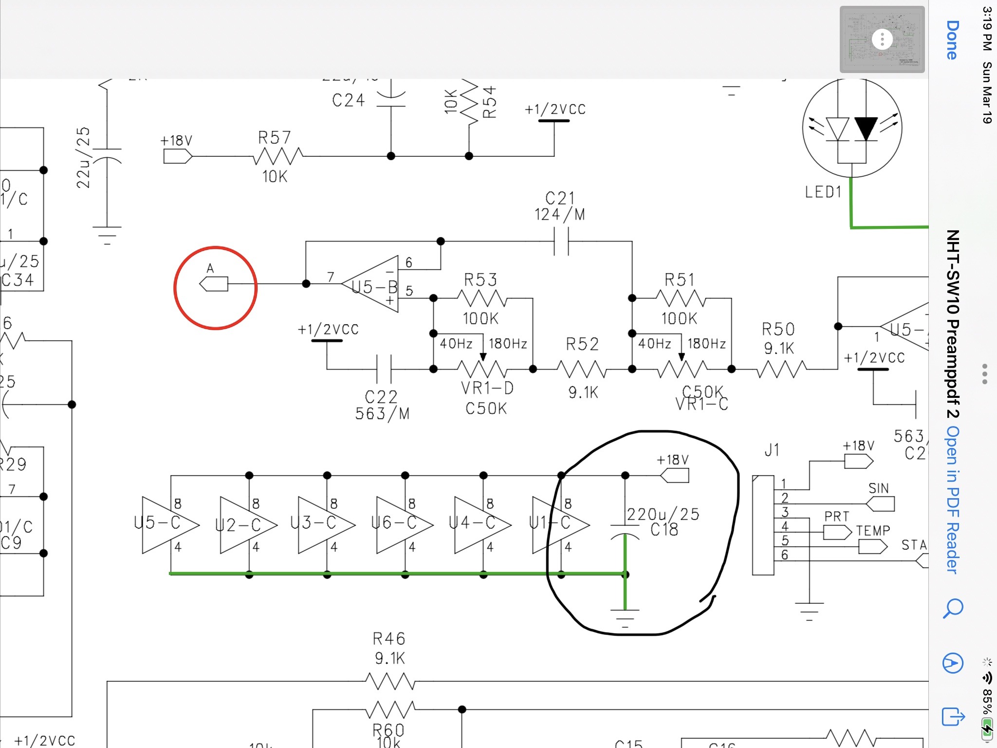

I also found the NHT SW10 preamp schematic. It is partially useful. If you look at schematic ZONES C1 and C2, you will see the 0N-AUTO-OFF switch and capacitor C26. C26 is rated 25 Vdc 470uF, but it looks like it is run from an 18 Vdc source.

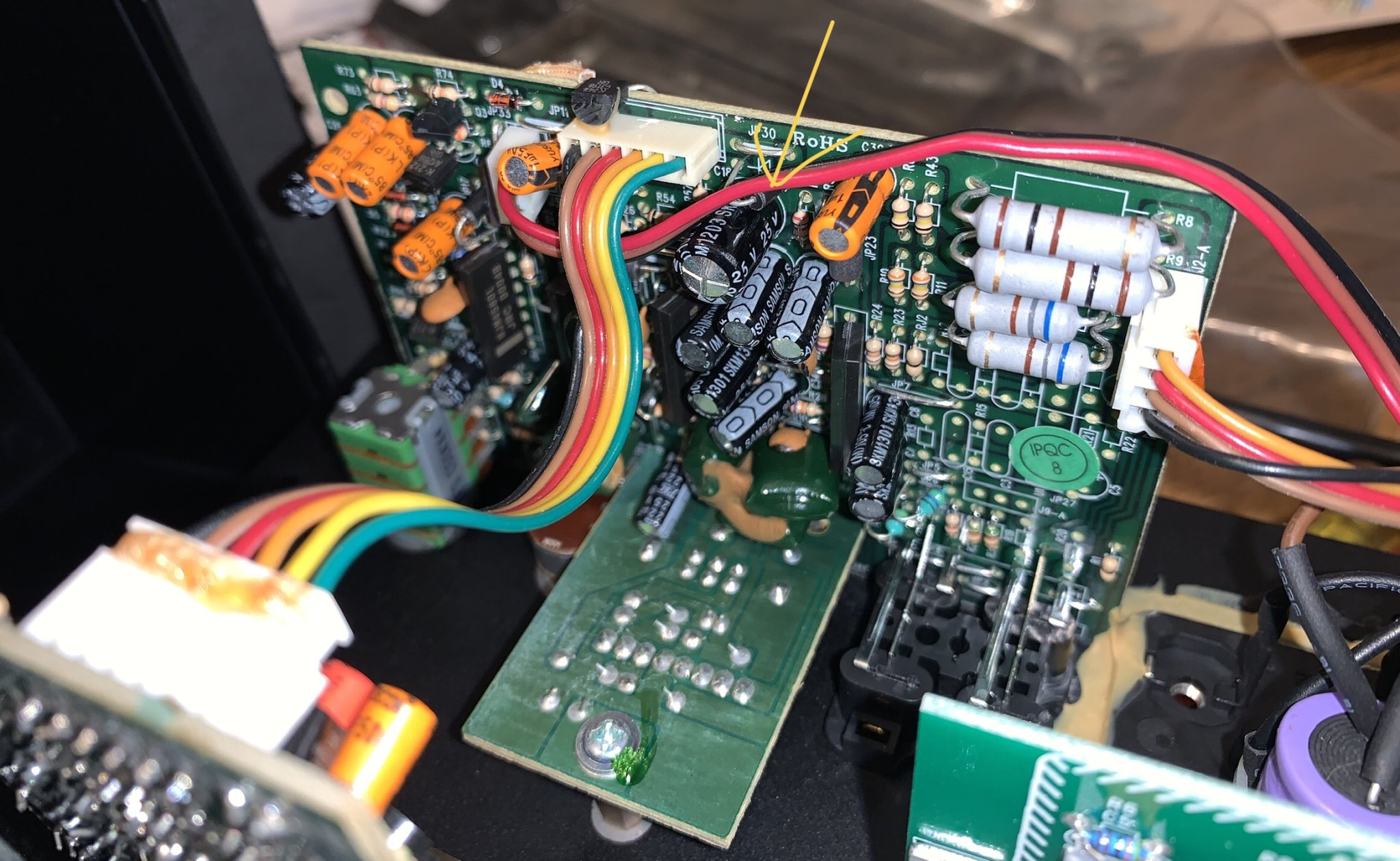

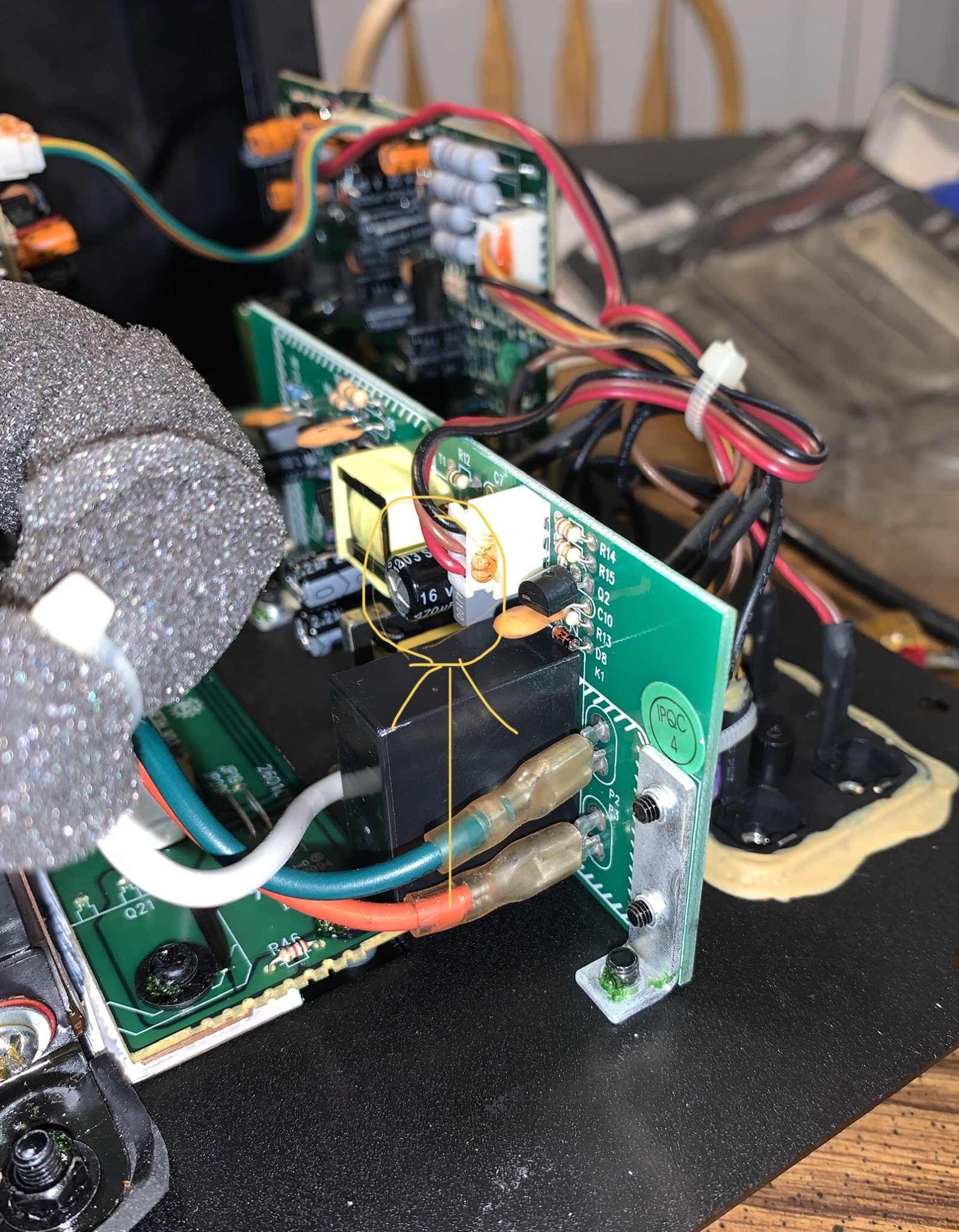

Glad I found this thread. I have the Dayton SPA250 plate amp and I also have the issue of the auto senseing ect. clicking on and off. I am posting 2 images. The first is the board has the connections. Is that cap circled in yellow blown? in the second image is the c8 cap, is that blown as well? Any help is appreciated. Thank you.
Put higher voltage caps, 16V on a 12V line is close.
But please check if they will fit, the higher voltage caps may be of larger diameter.
See for 25 / 35 / 63V, and change them out.
And see if the good ones are also cheapo Chinese stuff, you can replace with standard quality caps from a reputed maker.
You might find 47 / 1000 / 1500 / 2200 uF in 16V from an old motherboard...Gigabyte for one uses Japanese caps, mostly undamaged on blown boards!
Very useful for such repairs...
Good morning guys. I noted the C8 Cap manufacturer as ChengX, 16 Vdc at 470uF. I have been in electronics for forty years and never heard of that brand. C8 is definitely bad. The cap on your first photo is also suspect. WacGen is the Man who deserves the credit. Great job. My amp is repaired and burning in my low frequency driver. No more problems to report after replacing C8.
I can get the C8 cap on Amazon (it’s listed as a bestseller), can anyone tell what the other cap is that’s in pic #1?

Hi Freerojo, sounds like you are in the home stretch. Capacitors usually hard fail with a short (resistors open). Before failing completely, caps can act wonky. The caps can exhibit an extraordinary array of symptoms. If you even suspect, a capacitor problem - replace it.
All electrolytic caps are marked somehow. The gray or black band has a "Minus sign" imprinted on it. Obviously, the polarity must be observed. My "go to" caps are Panasonic or Nichon. I replaced the wonky cap with a 25 Vdc unit. Capacitor size increases with higher working voltages. Since space is tight, I used an axial leaded component instead of the original radial leaded cap. When designing circuits from scratch, a safety margin of 4:1 ensures long life. Designs with less than 2:1 will eventually fail IMHO. Good luck and good listening.
Free Rojo, my apologies if I left you hanging. My amp is back in the subwoofer cabinet, so I cannot confirm. All is not lost. Simply remove the suspect cap and read the Wvdc and capacitance in uF marked directly on the component. . . You can upgrade the voltage rating and capacitance values if they will fit in the allocated real estate. Replace with the same value or better, never go lower. My go to for components is usually Digi Key or Mouser. Amazon is easy but expensive. More questions? Always feel free to ask. These forums are a wealth of information.
That cap is used for decoupling the power supply from the amplifiers. The absolute value is not critical, but a wonky cap here would be a disaster. In this case I would recommend a 35 Vdc 220uF Cap. 105C is the temperature rating during operation. If you go capacitor shopping, look for the Lowest ESR and a minimum of 105C. Tantalum caps will have the lowest ESR in this volume. To gild the lily, you could add a non-inductive solid film .22uF cap. in parallel. Polypropene, mylar, etc. The larger value 220uF cap will handle the low frequency noise and ripple, while the .22uF cap will handle the higher frequency noise. If you look at the impedance curves, you will note rising impedance vs. frequency for the electrolytic, while the solid dielectric cap has relatively flat impedance across the band. Good luck- EVMan
