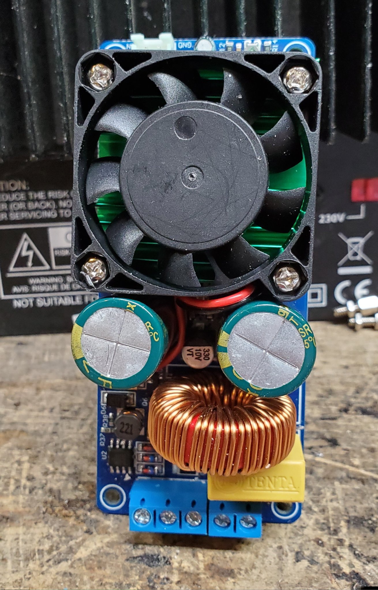

The G2 is roughly the size of 4 packs of cigarettes. It comes with a 32V/5 Amp power supply. My woofer is sensitive- 97dB 1W/1M, so it seemed possible. We made the connections and set the front panel controls. Low Pass Filter to Max, Volume to Mid-Range and PBTL/SUB to sub. We powered it up and listened to some familiar music. The Yamaha LFE crossover was set to 120 Hz for the best blend (by ear). Way too hot for making test measurements . . . The volume control on the Yamaha is graduated in 0.5 dB steps. At -30 the volume was above my normal listening volume. At -20 setting, the volume was uncomfortable. The G2 did not miss a beat. Chris Squire and Ginger Baker sounded magnificent.
I am not trying to sell the Nobsound G2, merely pointing out a work around for a bad plate amp. I have to return the loaner when college starts in the fall. This turned into a viable, zero hassle fix in the short term. Zero research was performed before installation. I looked it up later and liked the simple, effective features:

Power- is a guestimate. 160W power supply, no external heat sinks, etc. Sustained high power usage? I really don’t know. No measurements were performed. The G2 had more than enough power for my application, i.e., 10W equates to 107 dB SPL- more than enough. My subwoofer system is back in action.

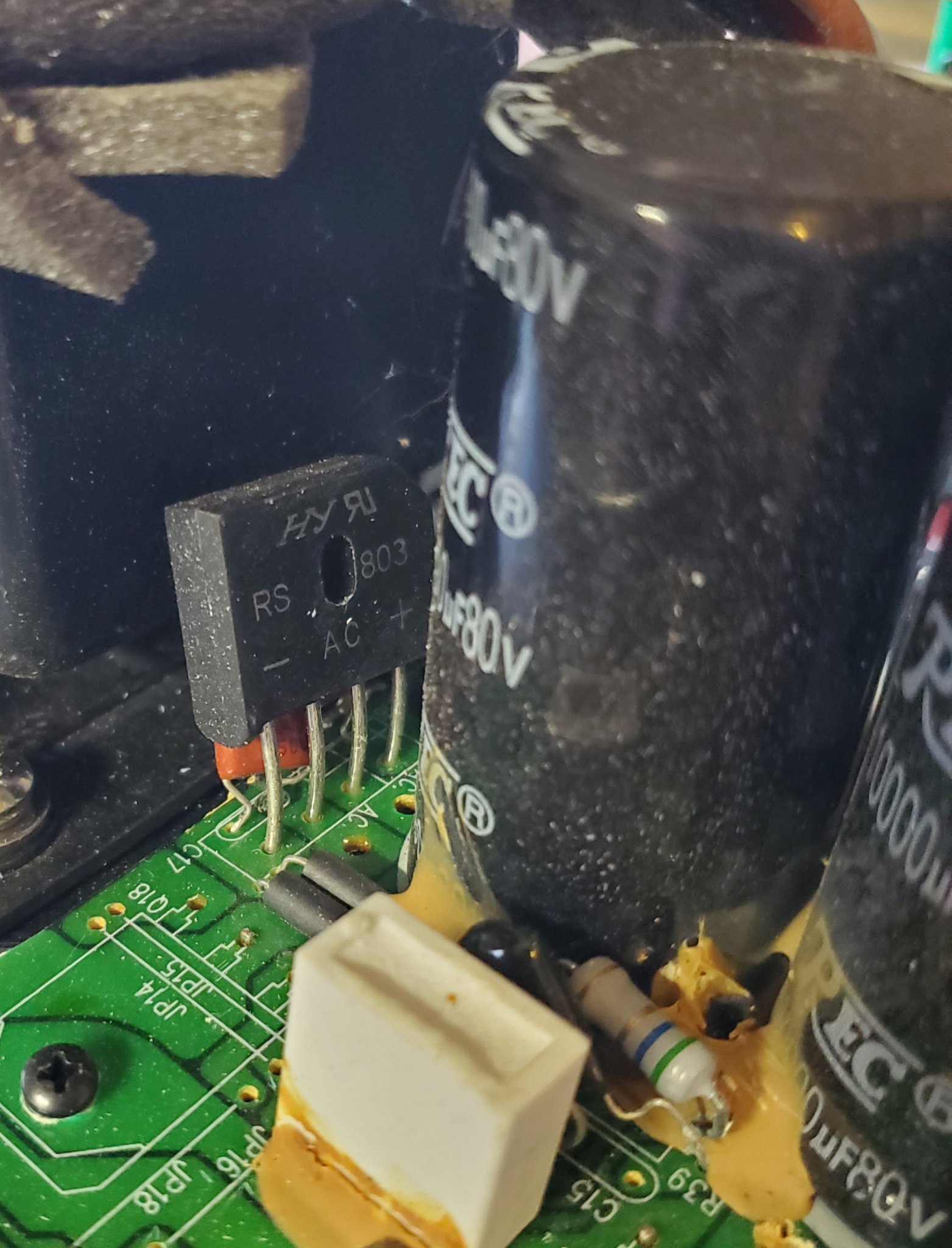

Get the wires from PCB to a higher rated rectifier, find one with a heat sink (common in alternators in cars for example).
That will solve your rating and size problem.
Using a chassis mount 25 or 35 Amp Rectifier is not a bad idea and I considered this. The Bridge rectifier would probably last forever, but a Few factors influenced my decision not to go this route. A new hole would need to be drilled and tapped. Max current or anything close is not required in my application. Max current at 4 Ohms is not a consideration for my 8 Ohm sub. Max current at 10 Watts @ 8 Ohms is a shade over 1 Amp. 10W into a 97db 1W/1M sensitivity woofer is extremely loud, bordering on uncomfortable. I can't imagine playing the sub at 100W and being in the same room. Your mileage may vary. Inefficient subs e.g. 87 dB would need 100W to reach the same SPL of 107 dB and would obviously draw more current. In my case, a 10 Amp bridge is plenty. Still, a chassis mounted, Hi V/Hi I, bridge rectifier might be the way to go for people that drive the amp hard. My two cents. Cheers- EVMan.

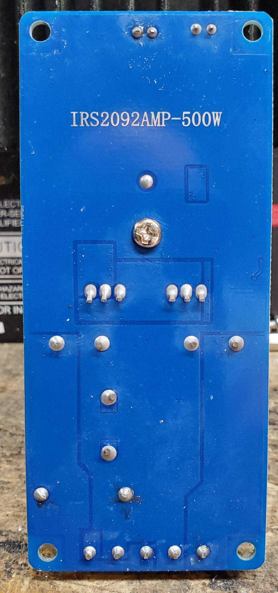

I am about to bench test the IRS2092 amp board and read @EVMan had posted about having wrong gain resistors (R11 and R13?)
I tried google searching a bit but came up empty handed.
My board currently has the following values:
R11 = 10K
R13 = 100
If these are wrong, my next questions would be:
1) What values SHOULD these be?
2) Must I replace these with another SMD, or can I use normal through-hole resistors?
3) Expanding on the second question, I am specifically worried that re-locating R11 (in the case of using through-hole) may cause some strange inductance issue. I notice that resistor is just a few mm from the chip.
I found this on another post (re-posting here):
So...
For R13, change the R100 out for a 3.01k for less gain on R13 (seems easy)
For R11, change out the 10K for a 8.2k (which also changes the clock frequency?)
Given my application (the retrofit), is the above correct?

Hi Dean,
How are you? And thanks for the question . . . You are correct about this being a crazy summer. My project progressed well up to my wife’s sickness. My apologies to all. My IRS AMP500 board had both resistors as you indicated. Into a resistive load, the audio gain was way too high and will likely oscillate into a reactive load. Changing R13 is mandatory for stable operation. A value of 3K -4K Ω will allow for proper operation (Gain-wise). However, the low value of R13 creates possible drive problems for the preceding stage(s). For example, my Yamaha RX-V667 had trouble driving a 3K Ω load.
R11 change to 8.2K Ω sets the current limiting symmetry. I did not test this out and from my reading it seems this is an issue at high power levels. My little amp has been run up on the bench sans a preamp. Since Class D Amps use some critical path runs, SMD Components were retained. Tough to work with- I had to break out the Pace Station. The surface mount components are very inexpensive. Matter of fact, it is getting harder to find thru-hole components.
I do have the components on hand for a simple preamp/attenuator/18 Hz HPF and the attached PDF Sketch depicts this simple circuit (minus power supply). The power supply unit (PSU) is a simple resistor-Zener-cap-Darlington combination that generates ± 15 Vdc. This power supply/preamp circuitry is all that is left to finish the project. These two circuits have not been built or tested. Cheers- EV Man

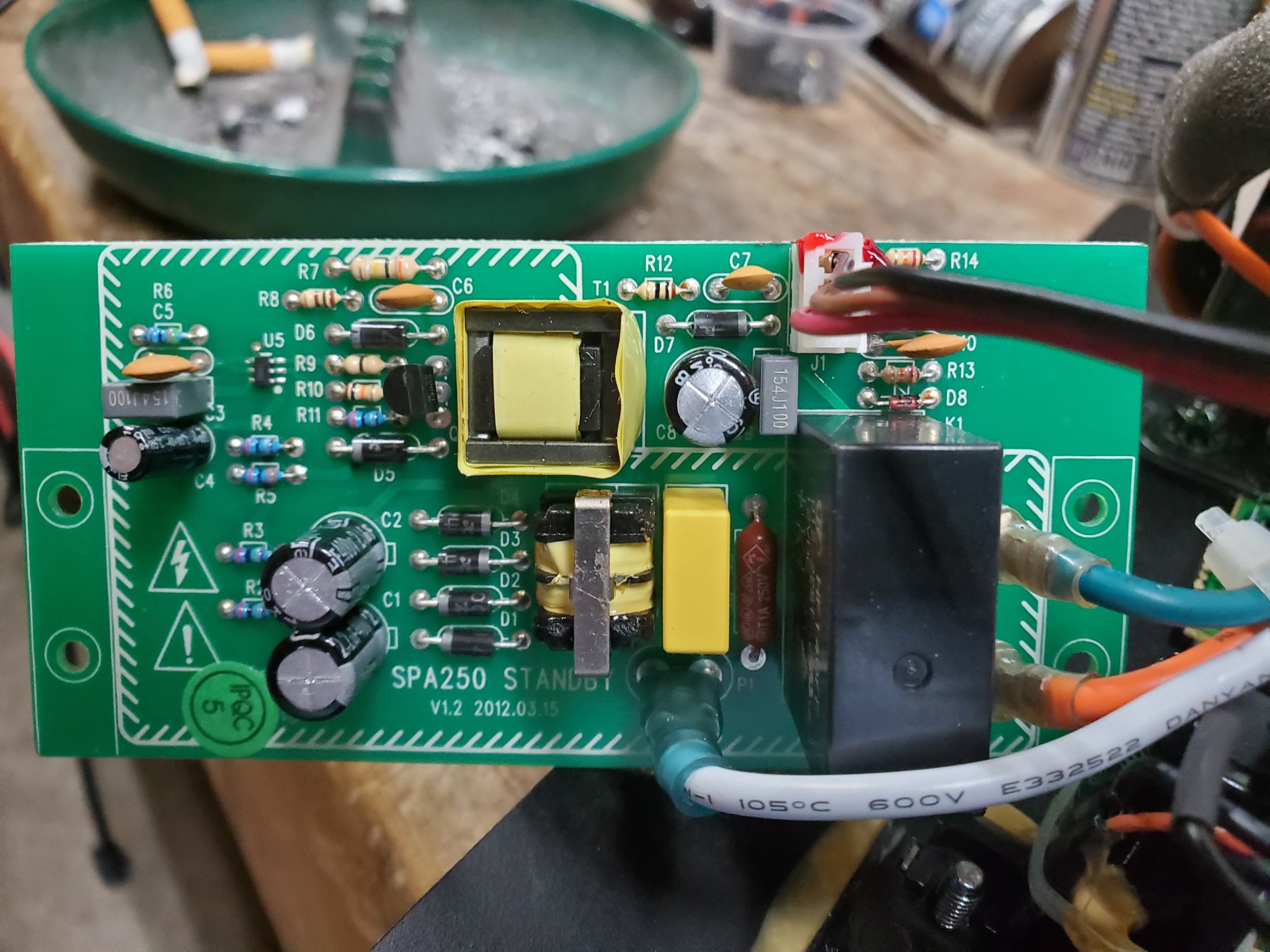

Hello gustinotetro,
I might be able to help; several versions of this amp were manufactured depending on the year. Early models had undersized resistors in the soft-start. RS1 and RS2 were upgraded from 2.4K, 1/2W to 3K, 2W. The auto-sense circuit was also added after the original NHT Amplifiers. All of the resistors on the soft-start begin with RSxx. I could not identify R20 and R21 in the soft-start circuit, only in the preamp. Those resistors limit current in the preamp’s driver circuit. According to my schematic, they are 30 Ohm, ½ W resistors on the emitters on Q9 and Q10. If this is true (I could be very wrong), it indicates a problem in the driver circuitry or the power amp input.
A word of caution: these amps were designed with very low margins of power dissipation and some very bad capacitors along with noisy flyback transformers. C8 on the auto-sense board has gone bad in multiple amps. I could not find RJ2, RJ3, RJ4 anywhere, sorry. So, I am not sure if you and I are on the same board or have a different version. Can you provide a larger area view and more detail? Or maybe point to the board . . .
All the Best- EVMan

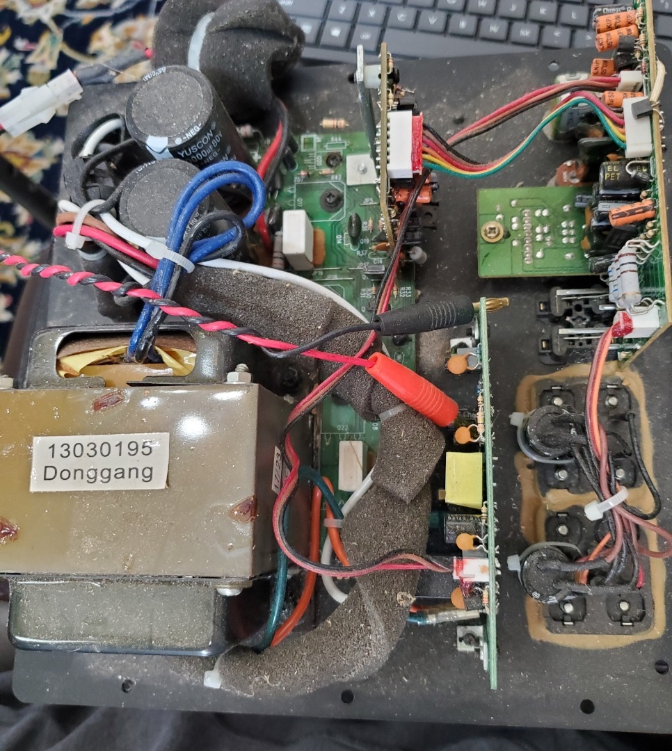

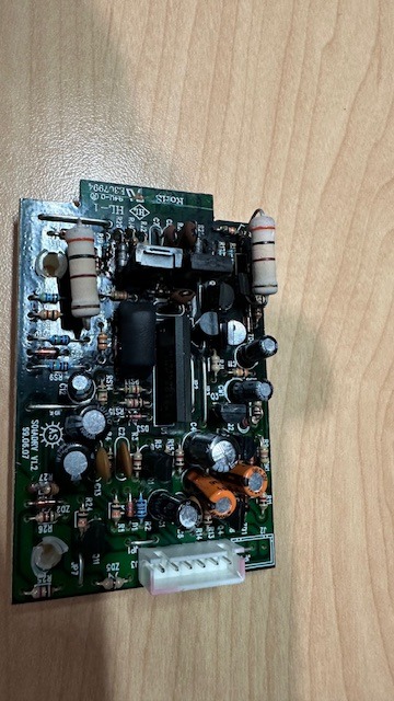

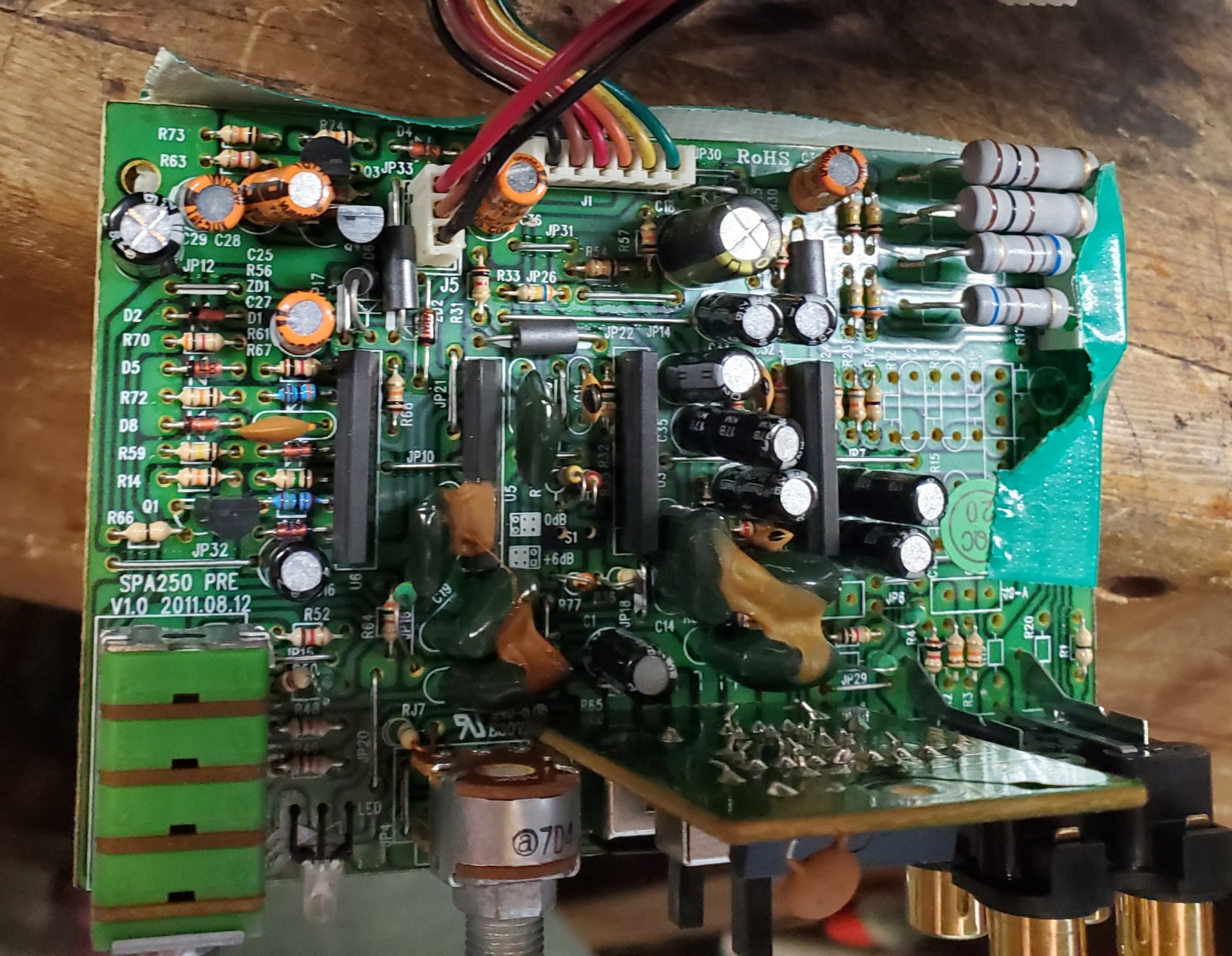

2) After comparing your photo against a physical amp, that is definitely the second half of the preamp. This card is mounted on a two-screw mounting bracket and also soldered to the main power-amp board. This mounting arrangement is fragile mechanically- cracked/cold solder joints are a real possibility. However, after working on 8 different SPA250 Amps, I have never seen this board fail. Attached below, is the pre to power amp interface. Very tough to work on.
Most failures seem to be on the autosense board (EMI, SMPS & Relay) or the first half of the preamp. This has the variable crossover, phase reverse, volume. Etc. This board is secured to the chassis via the potentiometer shafts. This board also has two connectors and a daughter board. 90% of the time, the fault lay with a capacitor.
To effect any repair will require the removal of the main board and power transistors. This is a rather involved job. To make things worse, there is definitely a bigger problem than a few resistors.
All the Best- EVMan
All the Best- EVMan

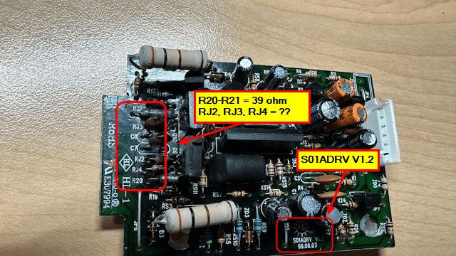

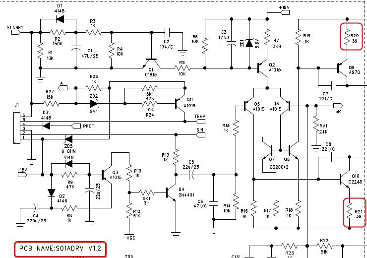

Thanks EVMan,
You are right, it is the soft-limt circuit (identified as PCB NAME: S01ADRV v1.2 on the schematic of the NHT-SW10 (same as SPA250)
I was able to remove it (see pctures) and effectively the two resistors on Q9 and Q10 are 39 ohms and they have burned. I will replace them with 1/2 w instead of 1/4 w but can not see the value nor the existence of RJ2, RJ3 and RJ4 on the schematics who represent the same pcb and version... I just wonder if someone has those values (could not see colors on them - burned by R20 and R21)
Good pictures!! I have never separated the 2nd half preamp from the mainboard. RJ anything is a mystery to me. While you have it out, I would suggest that you check all transistor junctions and ohm out all resistors while crossing each one off the schematic. Also check every Electrolytic Cap for bulging/leakage. There is something shorted somewhere, probably a transistor junction. Good luck!!!
I will see if my buddy with a borescope cam can come over. I am not taking this apart for photos!!
BTW this is not slow start circuitry, just the second half of the preamp. 1st stage is mostly buffers/filters with variable voltage gain. : -)
Again- multiple versions exist. The SPA250 is obviously a kludge to the original baseline. I have had four of them go bad and will not trust these amps with any $300 subwoofer. A redesign is called for; this version is 24 years old and kludgey . . .
Best- EVMan
Best- EVMan
