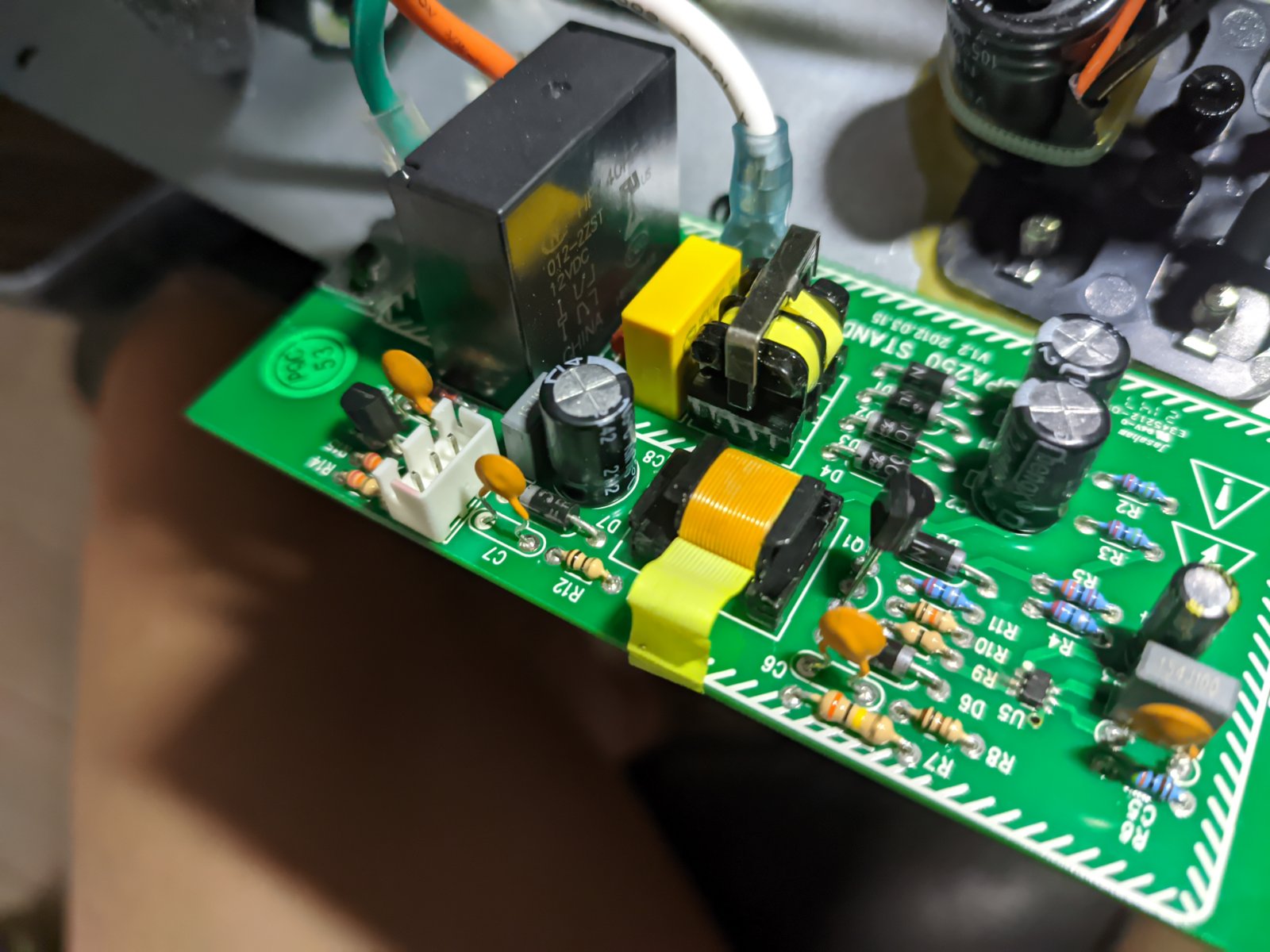

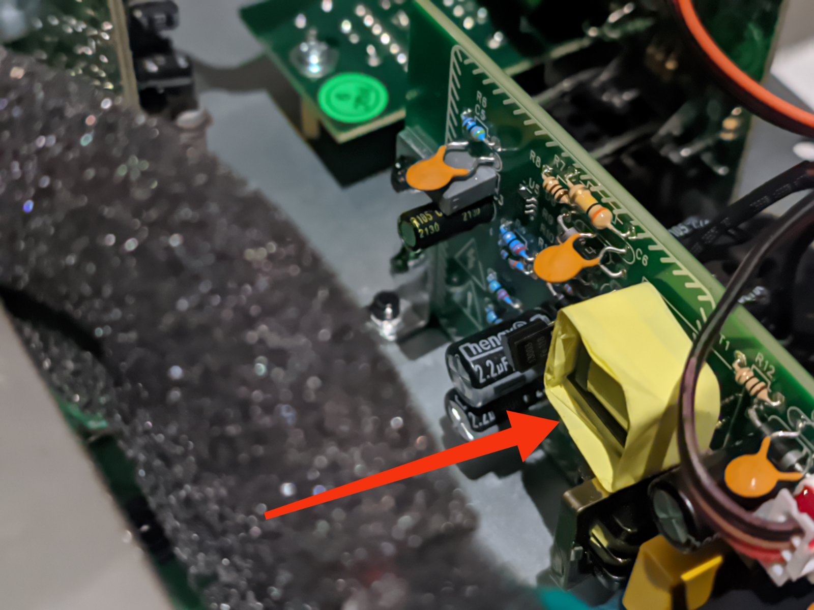

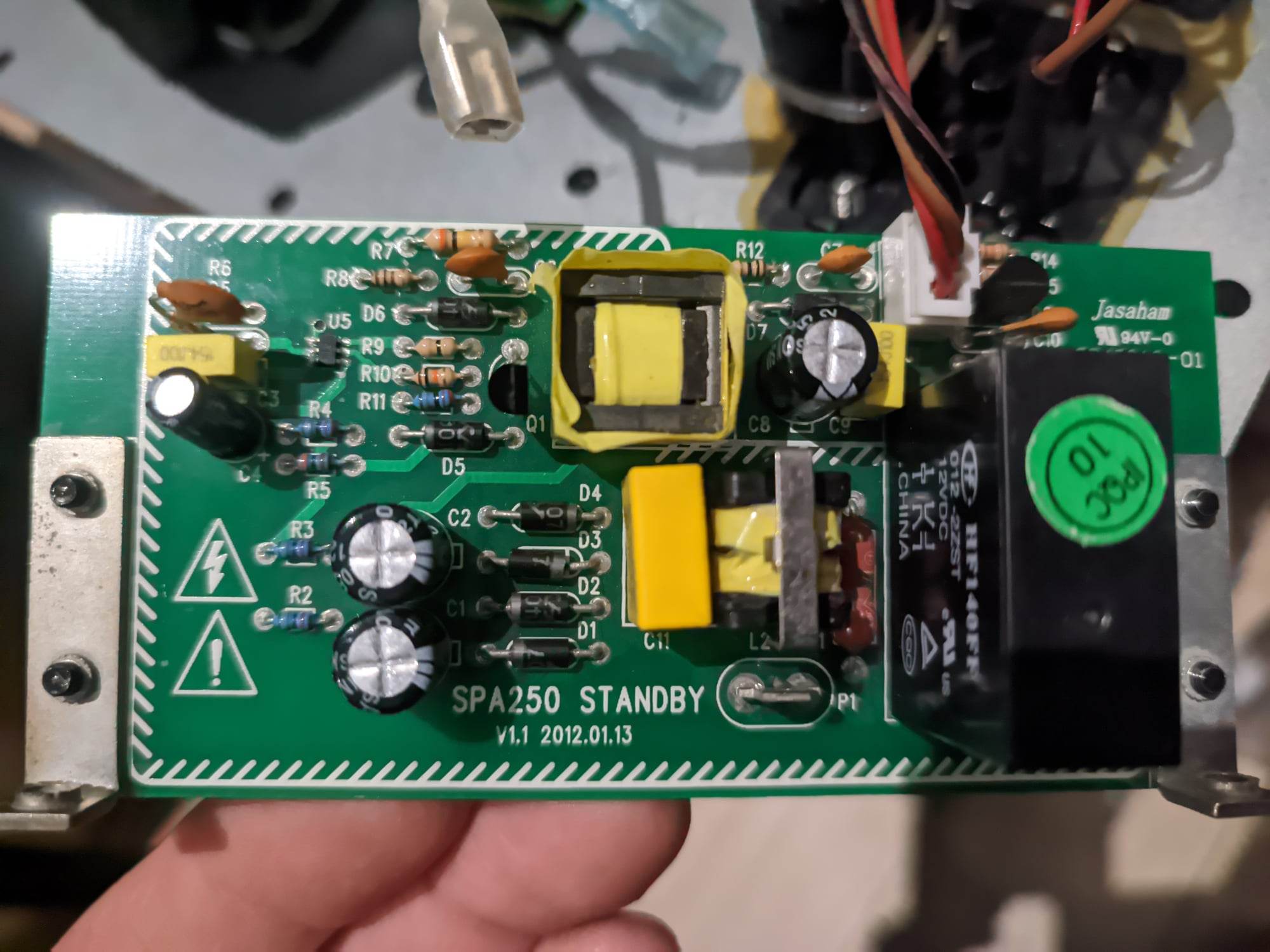

As discussed previously with EVMan, here are some pictures of the problematic "whining" mini transformer, in case anyone experiences it in the future (this is part of the STANDBY board section).
As mentioned by others here, yes I do not recommend that you tinker with the inside circuitry of the subwoofer plate amp, unless you know what you are doing (dangerous electrical components inside, as well as voided warranty if still within warranty-period).
I did it since 1.) The item already doesn't have any warranty and can't be returned anymore, and 2.) Even if it was working, the "whining" sound really makes the "working condition" unit unbearable to use (and possibly fail in the future, if there are other components actually causing the whine as mentioned by others in this thread)
My hunch is that the dark gray mini ferrite cores that are attached (loosely) to the mini transformer are the ones vibrating and causing the high pitched whine (pictures show the yellow insulating tape removed). I doot n know if they could be damped in some way or not. Experts can chime in on their opinions.
I did not bother to try and strip down the center windings anymore, as it was too cramped and it was of no use to me anymore.

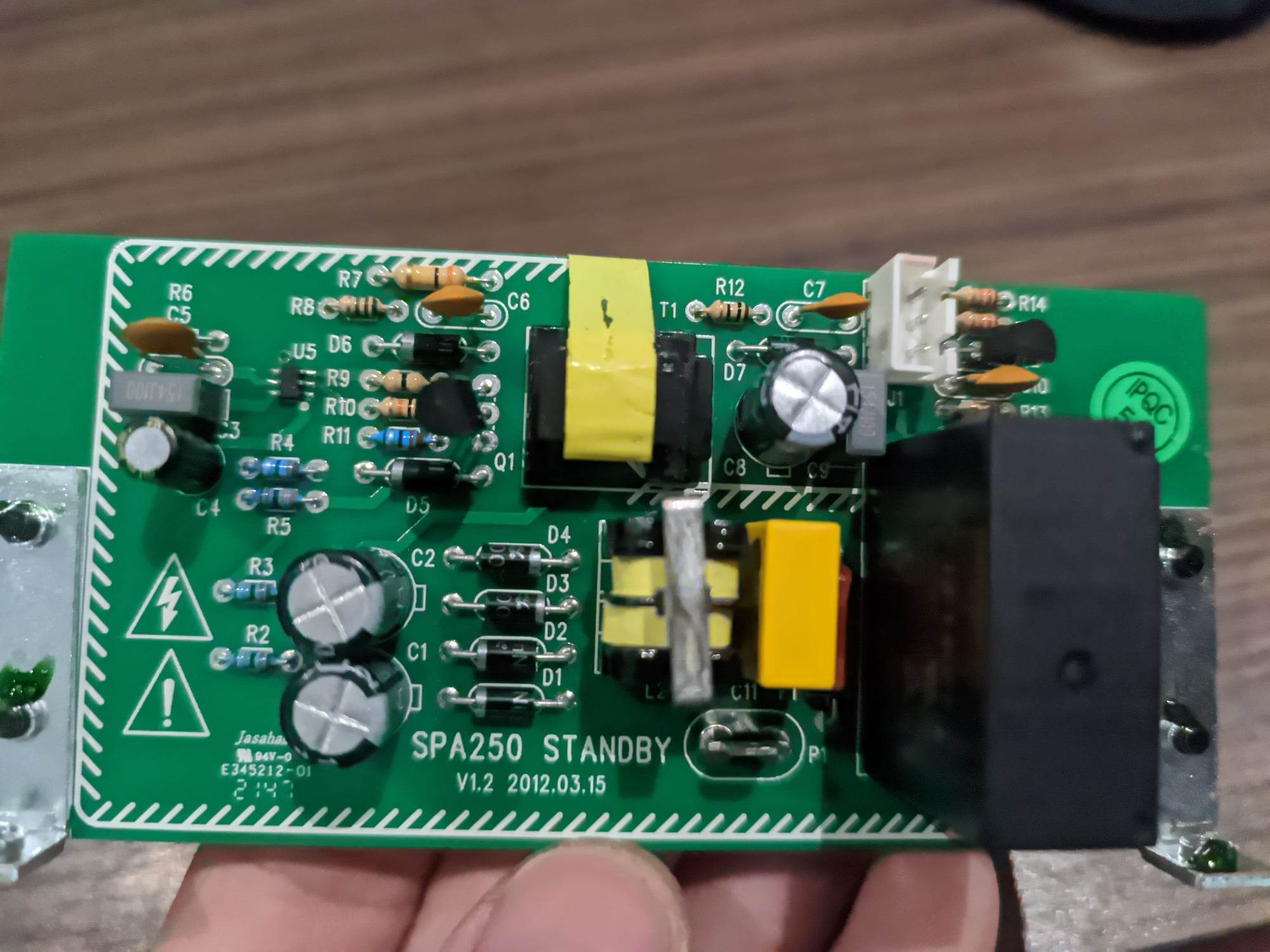

RKV- thank you for sharing. I traced out the STANDBY circuit card before sending my spare to you. I could not find good data on U5 or Q1. Because of this lack of information, the schematic is not published. However, the circuit can be broken down into three sections:
1) Input EMI filter-rectifier-filter
2) PWM circuit with flyback transformer primary
3) Output circuit with secondary, rectifier, filter with relay and driver.
Proper operation can be checked by measuring Line Voltage across P1 and P2. When Switched to AUTO (With music playing) or ON, the relay should actuate and the line voltage is present at P2 and P3. The line voltage is then applied to the main transformer. Use caution as lethal voltages are present. Troubleshooting this little power supply is made difficult by the lack of info. Although the pin out is different, the SG6848 PWM IC has very similar functionality. Q1 is probably a 600V MOSFET, but again, no data. C8 is the main output filter capacitor, It is subjected to high frequency ripple and currents.

Hi, How are you? My brother-in-law finally arrived yesterday night, and I was able to get the standby board from him!
I will try to connect it probably within the day or tomorrow once I get to have free time to do so (so excited and a little bit scared at the same time hehehe).
For now I compared your standby board with the original board that came with my unit. Yours is version 1.1, and mine is version 1.2. Upon careful inspection, I don't see any parts that differ, only the lay-out of some components (but still same values), so it is relatively the same. C3 and C9 had different components (brand) used, but the values are the same (154J100).
I'll report back to you what I have found (and hopefully working!!!)
Thanks again!
Good morning RXV. Glad to hear that you finally got the STANDBY board. As I noted previously, this amplifier has been through several revisions. The STANDBY board is no different; parts and suppliers change all the time. In this case, the functionality remains the same. The switching power supply generates “Always on” +12 Volts. This voltage gets routed off the board to the OFF-AUTO-ON circuitry on another board via the 3-Pin connector. The OFF position maintains an open circuit while AUTO-ON will provide +12V back to Q2. If this voltage is present Q2 will conduct and energize the relay. The energized relay applies the mains voltage to the big transformer on the heatsink.
Take your time and swap one connection at a time. Mount the board with the original screws and you are ready to try it out. A couple of options here: 1. You can connect a cheap speaker or dummy load (even a light bulb can work) and 2. You can apply power all at once or use a Variac or place a light bulb in the primary circuit. The STANDBY Board has a 1 Amp fuse installed next to the black relay.
Hopefully, everything works and you spend the rest of the day listening to music. However, . . . If the new board’s transformer still whines, there is (was) a problem in the OFF-AUTO-ON circuitry (on the other board), probably a dead short. The other possibility is that a new problem happened when you powered up without the ferrite installed. It might be possible overcome either of these problems by using a jumper instead of the 3-Pin connector. Good luck- EVMan

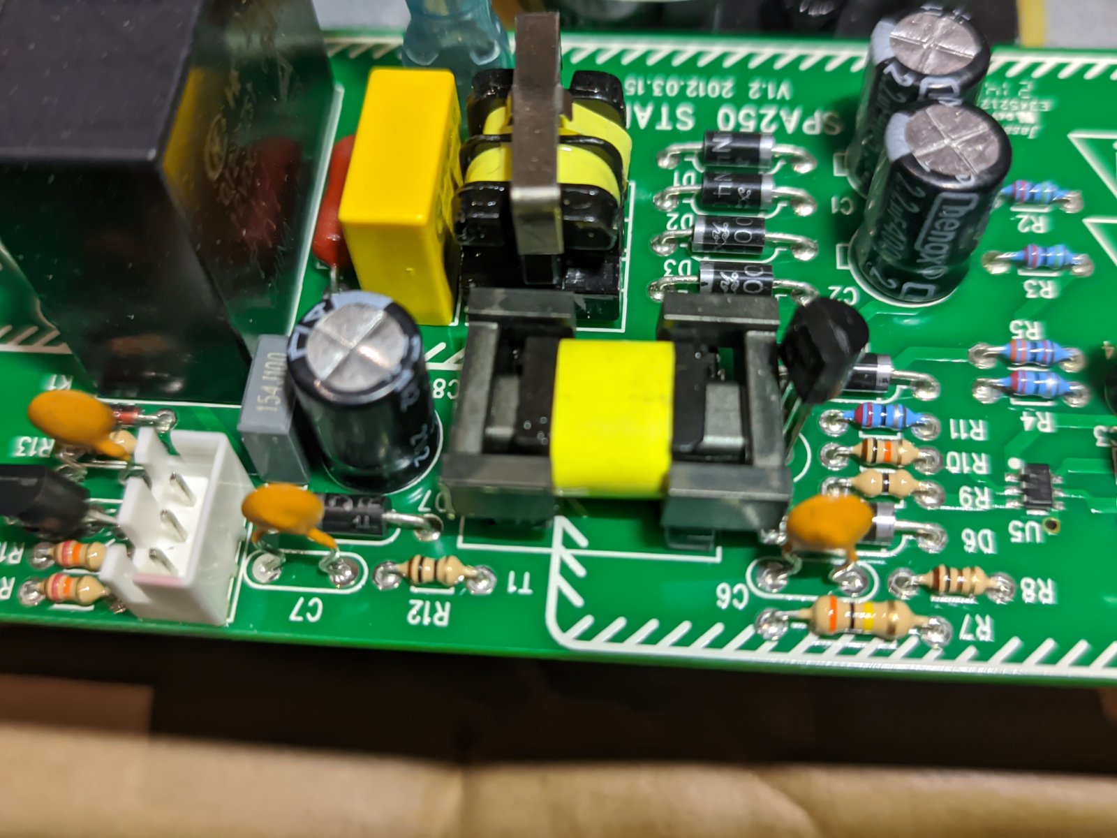

EVMan was very kind enough to send me his spare SPA250 standby board. You're the man, EVMan! Hehehe
His board is version 1.1 (2012.1.13), while my original one was version 1.2 (2012.03.15). Please note that my SPA250 plate amp was just purchased in 2022, so they probably hadn't revised the standby board ever since.
Version 1.1 is almost the same as Version 1.2, except for some minor relocation of components, as well as some components have different "brands" used (but same ratings). See actual pictures below.
Inserting (and using) the Version 1.1 standby board onto my SPA250 (which originally uses version 1.2) works fine without any issues at all.
So if ever one of you guys, for some reason, have a bad/busted SPA250 standby board, you could probably look for parts-out SPA250 parts in the marketplace and replace your old one with the working one. Plug-n-play (just 2 screws + 4 connectors for the standby board). Easy-peasy.
One thing to note, EVMan's standby board's mini transformer still emits some high pitched whining sound, but it is very very negligible (around just 1/10 of mine before), and it is inaudible once you close the rear plastic cover shut, so I may assume that all SPA250 boards have this "shortcoming" or semi-flaw with regards to the mini transformer (since they didn't apply any dampening or varnish to the specific component, probably a sign of using cheap parts). It's just a matter of if you are annoyed by it or not (and can hear it).

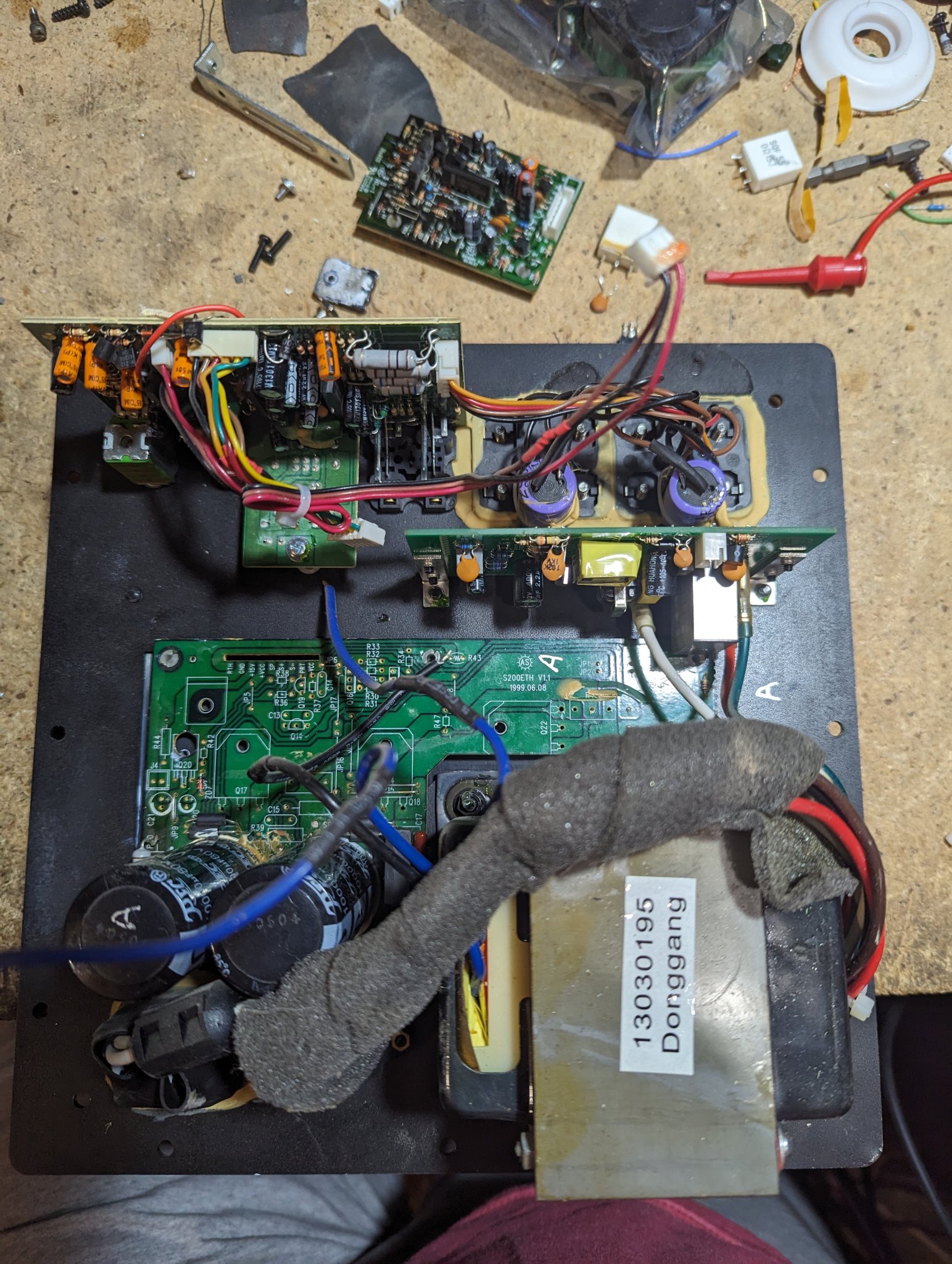

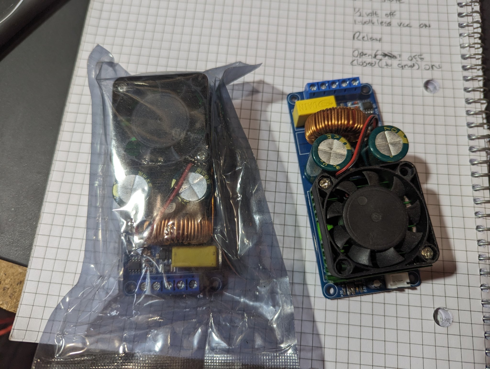

So I finally got some time to get back to this project and have spent the past couple days carefully testing the pinouts of everything.
But first... some pics!

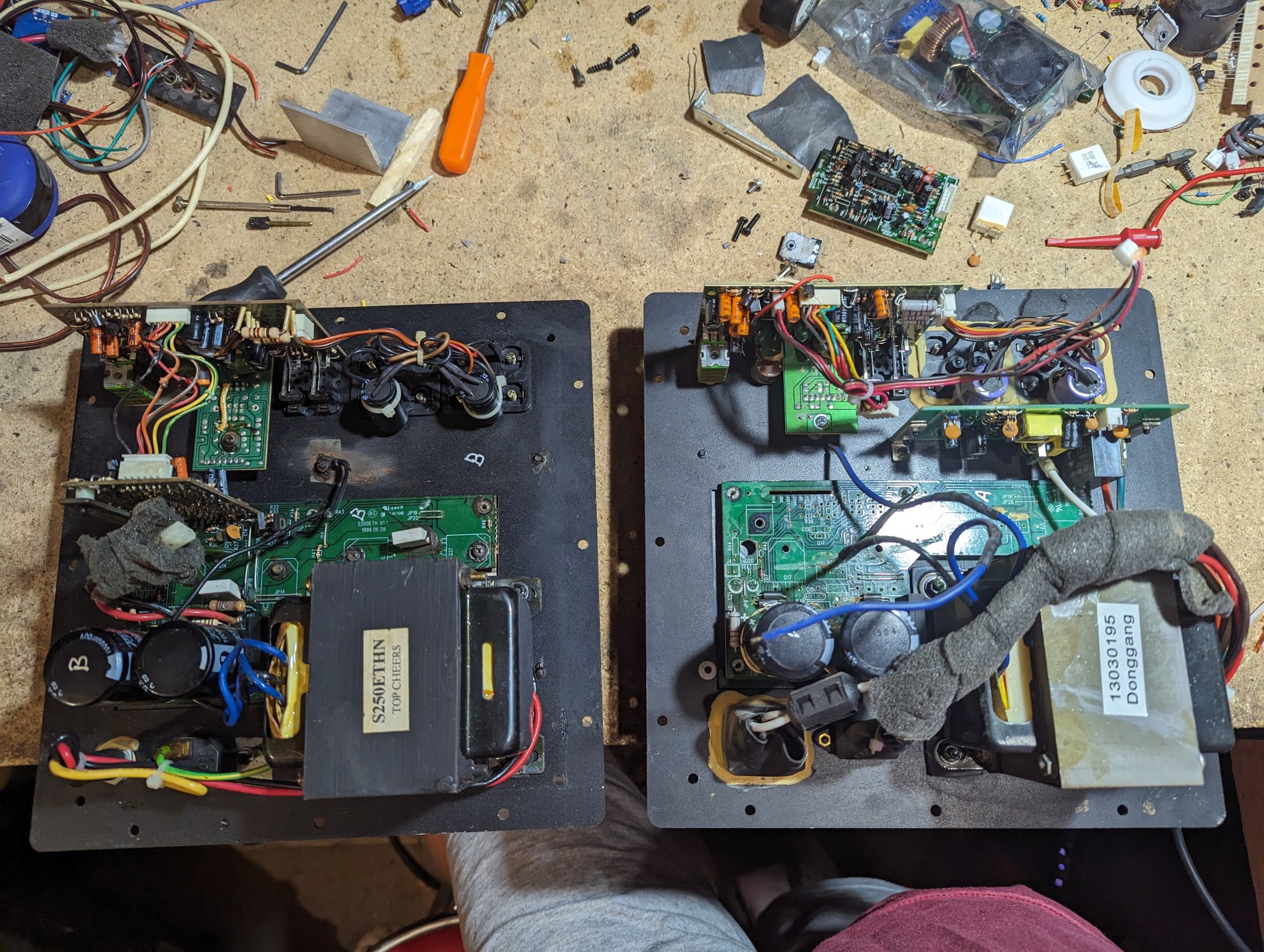

I actually have TWO versions of this amp. While they both look identical from the outside, and both share virtually identical looking amp boards, pre-amps, etc... it seems at some point during the production run that the auto-off functionality was drasticaly changed.
Here is ONE version that does NOT have a relay board. Basically the on/off functionality is solid-state controlled and the transformer is ALWAYS powered on:
Here is the OTHER version which DOES have the dedicated relay board. In this setup, the relay board includes a SECOND 12-15 volt power supply that keeps the pre-amp board (with it's signal detect circuitry) powered when the main amp transformer is powered off:
Here they are side-by-side for comparison:
You will notice that the one on the right (with the relay board).. I have already stripped all the amplifier components off the board.
I am getting it ready for these guys here:
The mini heatsink/fan will be removed and replaced with a thick piece of aluminum angle that attaches the amp directly to the original heat-sink.
So after 2 days of spending more time mapping these out then they are actually worth, I have what many are likely looking for: the pinout!
Bench-testing both over a 48-period timespan to ensure the on/off/auto work and that the pre-amp itself works on both:

REGARDING THE RELAY BOARD
This little guy is pretty simple:
1: (Red) Ground
2: (Brown) 12-15 volts output (from relay board) to provide provisional power to pre-amp when main supply is OFF
3: (Black) Trigger ON (pre-amp board sends the 12 volts TO the relay board on this line to activate the relay, which energizes the main xformer)

Whats Next?
So before I do anymore work on the Dayton amps, I am first going to perform a ton of testing on the mini class d amps I purchased.
Do they perform correctly at the voltage that the Dayton power supplies provide?
Do they have built-in soft start, or do I need to implement something?
How will the new amp handle the power-on scenario for each version of the Dayton amp?
For the version without a relay PCB
I may fabricate something similar to what the other amp has. It does not make sense to have the xformer powered on all the time. Only should be on when the amp is on. This would require not much more than an extra relay, spare 12 volt transformer and few passive components.
For the version WITH a relay PCB
Most the work is done for me here. Tap the new amp board into the DC output of the old amp. Bridge the audio signal from pre-amp into new amp and ensure I have a way to provide the pre-amp board with a quality 15-ish VCC (LDO or maybe a step down buck converter) from the positive leg of the main supply.
Thinking out loud
Be sure any relays we drive are buffered with a driver transistor for safety and a flyback diode to ensure we do not over-drive anything on the pre-amp board.
Fimd the best way to mount the new amp board to the existing heat-sink while keeping the MOSFETS on the new amp board in their orignial spots. MOSFETS are sensitive to capacitance and attempting to re-locate them (mounted directly to the original heat sink) is ill advised. Thus... fabricating a block or using thick aluminum angle that allows the new amp to mount to the old heat sink at a 90-degree is going to be required.
What kind of power can I expect? The Dayton supply is 58-65 volts. The new amp boards are good for 500 watts at 70 volts. Keep in mind: these are class-D, so the over-speced power supply the dayton amps had took a huge loss into account. Given the lower voltage, I figure these new frankenamps will be good for 350+ watts at 4 ohm.
I will keep everyone posted on the progress.
