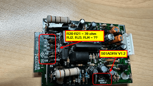

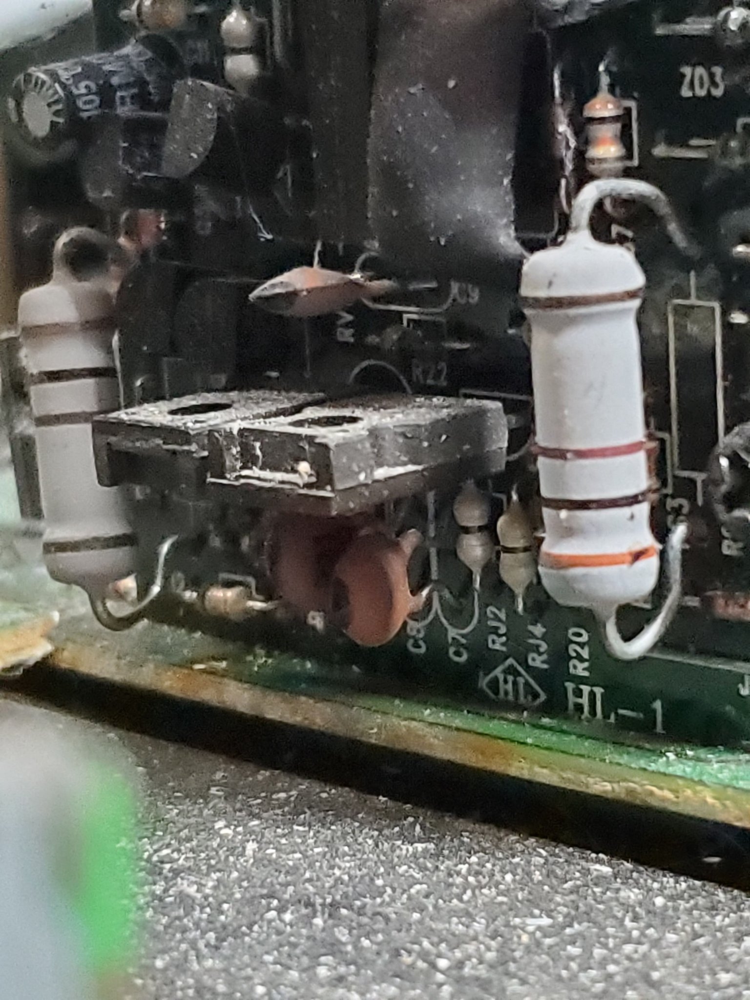

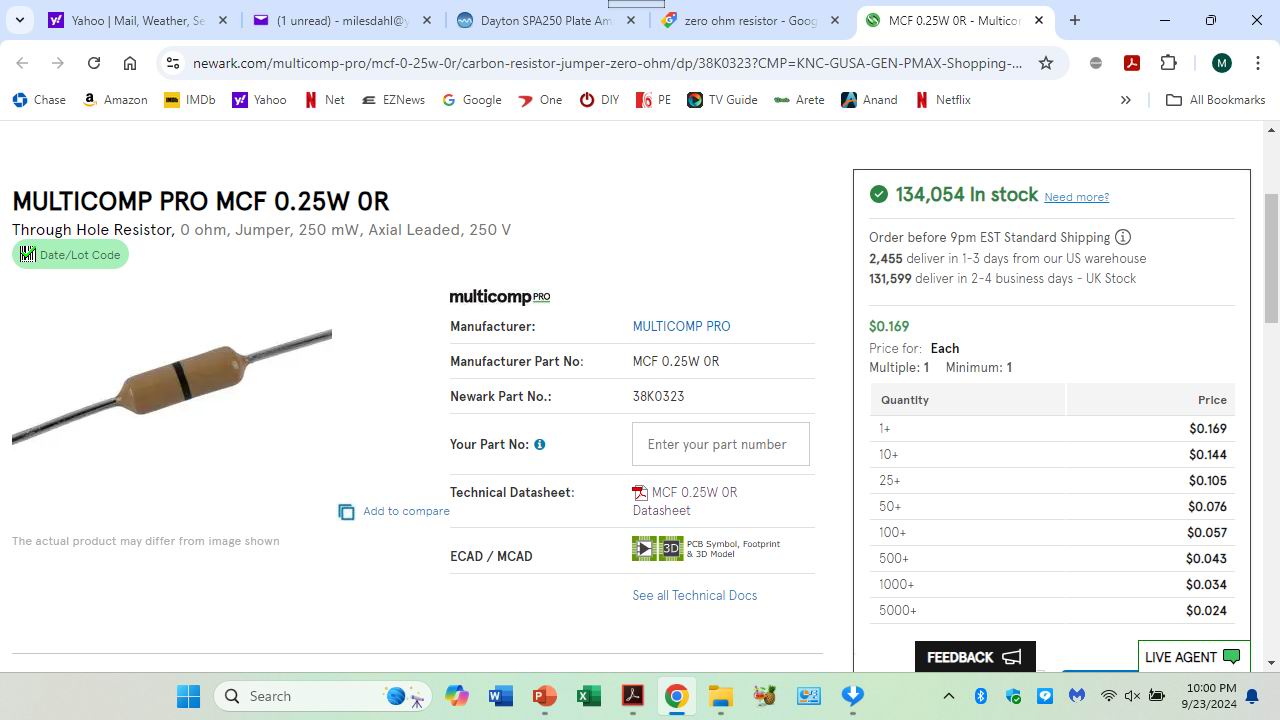

5) We were able to get a shot of the bottom of the 2nd stage preamp. RJ2, 3 and 4 are in fact zero Ohm resistors. Note the single black band on the resistor’s body. The second attachment is a catalog cut from Newark, but several vendors sell them. Looks like you will need two 39 Ohm and three zero Ohm resistors. However, the key question remains, “What caused the resistors to burn up?” Most of the time it is a bad transistor or shorted cap. Caps fail short, resistors fail open and transistors can fail open or short. BTW, S01ADRV = Amplifier Driver.
You don't need to use zero Ohm resistors in a repair, a jumper will do just fine. They are just (sometimes) more convenient in automatic PCB production.

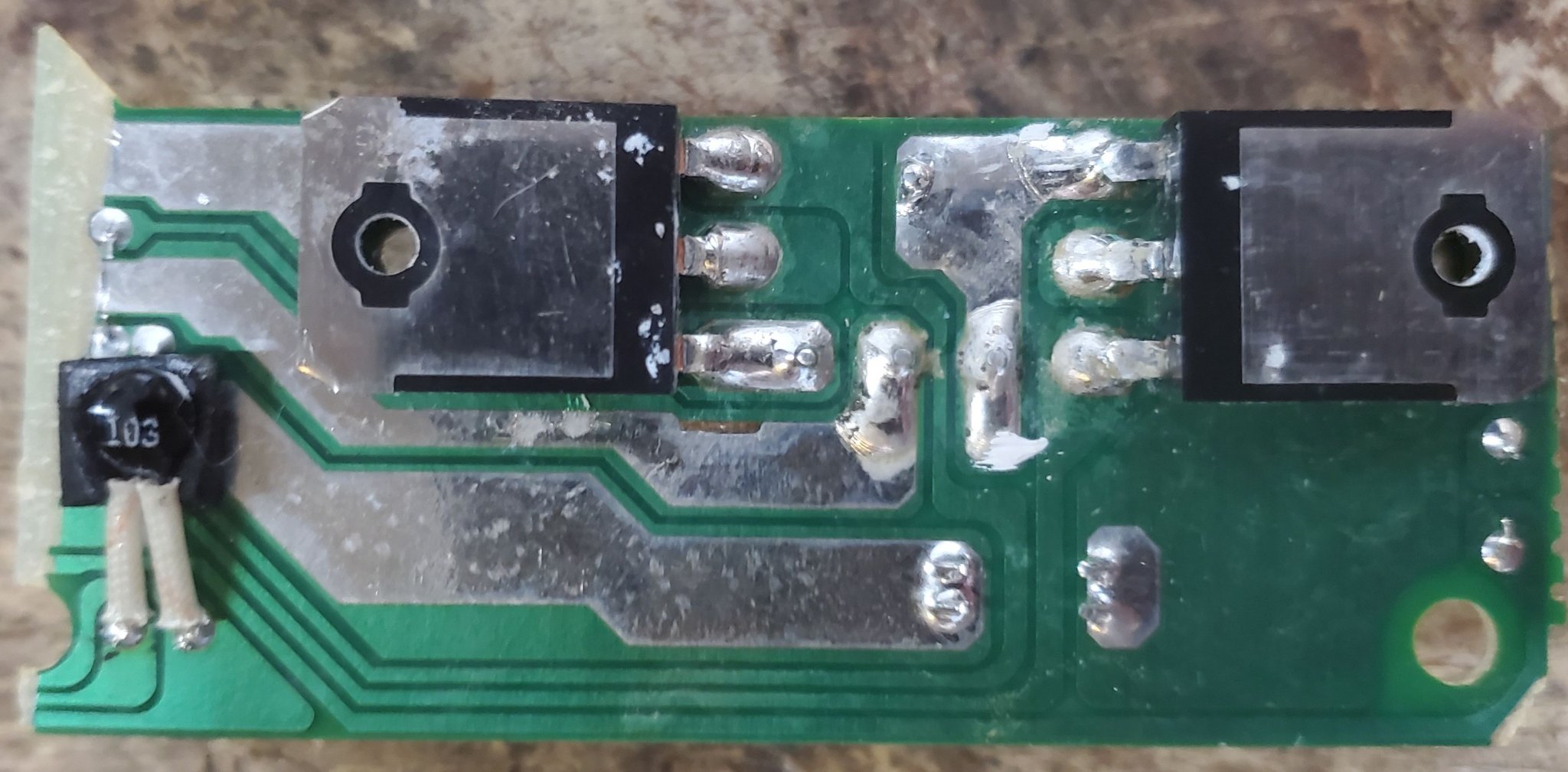

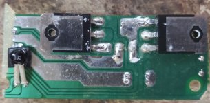

gustinotetro- Please look at C4. It seems to be bulging . . .
Gustinotetro- would you be kind enough to take a shot or two of this board from straight overhead at hi res? Many thanks- EVMan

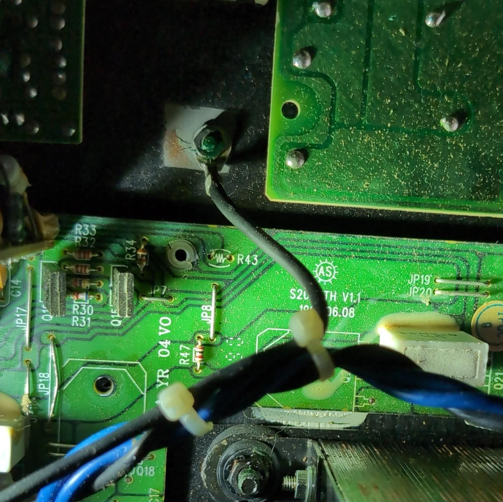

That is a new one for me. R43 is a nominal 10k0 thermistor. Any other problems? Suggest you check the semi-conductors in zones A1, A2, B1, B2 on the schematic and look for shorts. R43 is part of the protection circuitry. You can try a 10K, 1/2 W resistor and see what happens if you feel lucky. On a good day, this shouldn't be in circuit. Any other symptoms? If R43 is open, does the amp still work? EVMan

I mean the thermistor might not have blown, maybe the legs simply corroded and it fell off.
If you look closely, you should see if the legs are melted, corroded or cut off.
Maybe even a factory "modification"? These amps are known for their bad design, all failing after some time of use. They are build that cheap, PE can replace each of them once and still make money. That has been known for years know.
Honestly, it looks like the legs have been cut, the amp was salvaged from a 20 y.o. sub, that while in storage (for being faulty), got a bit wet on one edge and puffed up, I wasn't planning to use the amp as I have a spare external amp (Emotiva XPA-100) that I'm going to use when I've built a new enclosure for the woofer. It was just if I could easily fix it that I was interested in doing so, more for the spares bin than anything.
If the Amp is really 20 years old, you have an early model SPA250. These amps are not reliable- I have
been through four them myself and troubleshot a bunch more. If this amplifier is still in working order
(Sans R43), it would be a minor miracle. R43 forms part of the biasing network for Q11/ZD2. NOTE: R43
is a thermistor mounted underneath the board and pressed against the heatsink via a foam pad. It also
interacts with the other protection circuitry. This points to a couple of possibilities: 1) the protect
circuitry went bad or 2) the main amp has a fault and the protect circuitry is holding it off.
