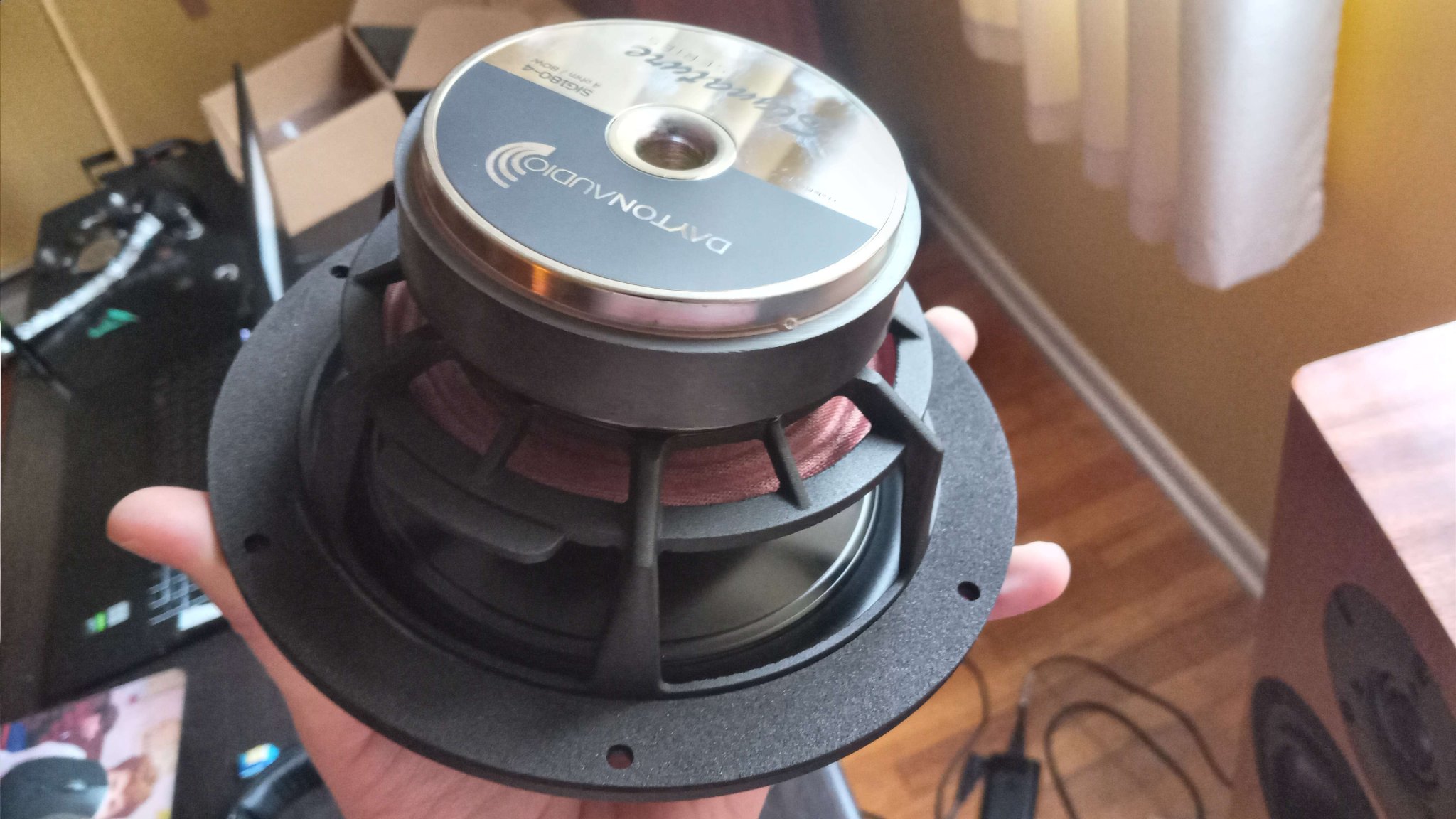

A friend dropped off some sig180's yesterday, he's a user here so I bet he'll see this.
They are very pretty in person, combined with their performance and price these seem like the go to woofer for a lot of projects, but we'll see what they do in a speaker box. These will be put in a two way with a wg300. I thought the print on the back was just a sticker but it appears to printed on in some manner, just an overall visually well executed driver.
