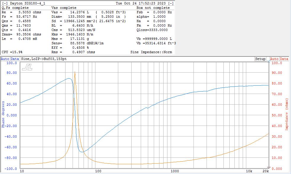

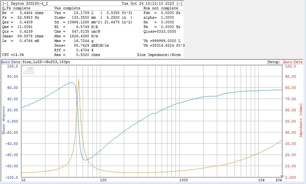

A high Qms is good if you need to damp a TLine ... damping rises the losses means Q goes down .. so if Qms is high you'll have more "headroom" regarding damping of the TLine .
This is an initial measure on the 180 from Jon Marsh on axis. I have 4 on hand but have not had the time to measure them myself yet.

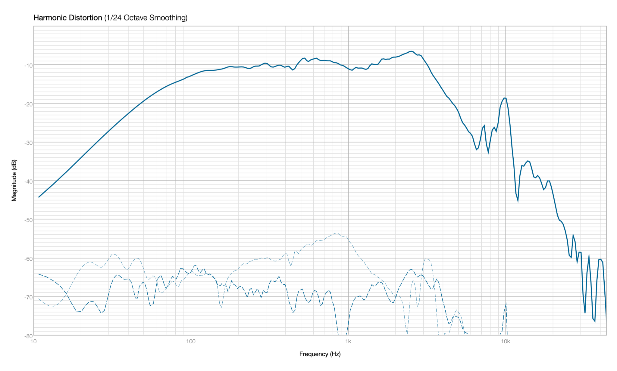

Distortion is pretty low but on what SPL level , 90dB at 1m ??
At around 1kHz , our hearing is most susceptibel for distortion (for an absolute level between 60 and 80dB) , but for a low crossover frequency there is some overlap and there is a chance to reduce the resulting distortion (dep. on rel. polarity) , don't know if this holds true for K3 tough ...
