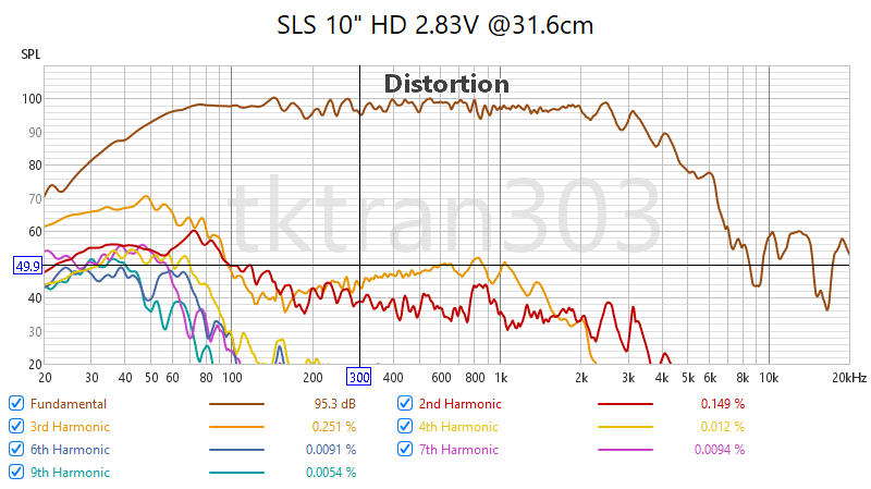

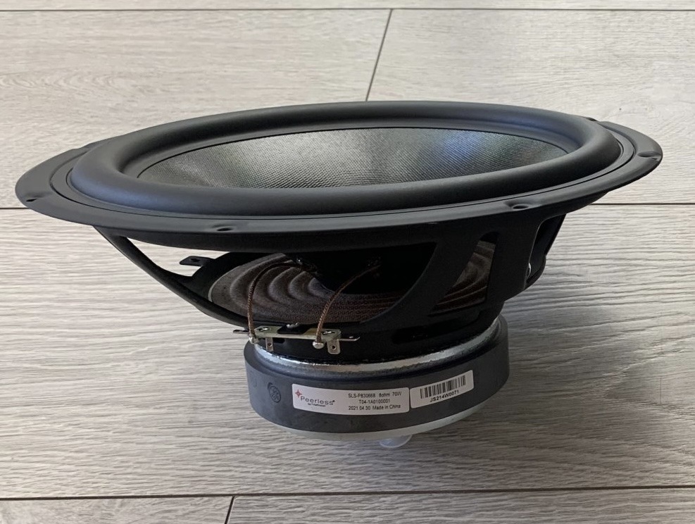

I honestly don’t see what’s so exciting about the Sig270. Apart from new and shiny.
let’s see how it measures independently.
You could have been enjoying this 10”- it’s has been around for decades
as used by Linkwitz, Krevskovsky, Carmody etc,
also a healthy x-max of around 8.3mm. US$60.

As far as I remember these SLS drivers are long out of production , more than 15 years . And please double the price for fairness since we don't have a time machine or Old Scotty's beam machine to get us these for the original price 🙂
SLS drivers are still available:
https://www.soundimports.eu/en/peerless-by-tymphany-sls-p830668.html
