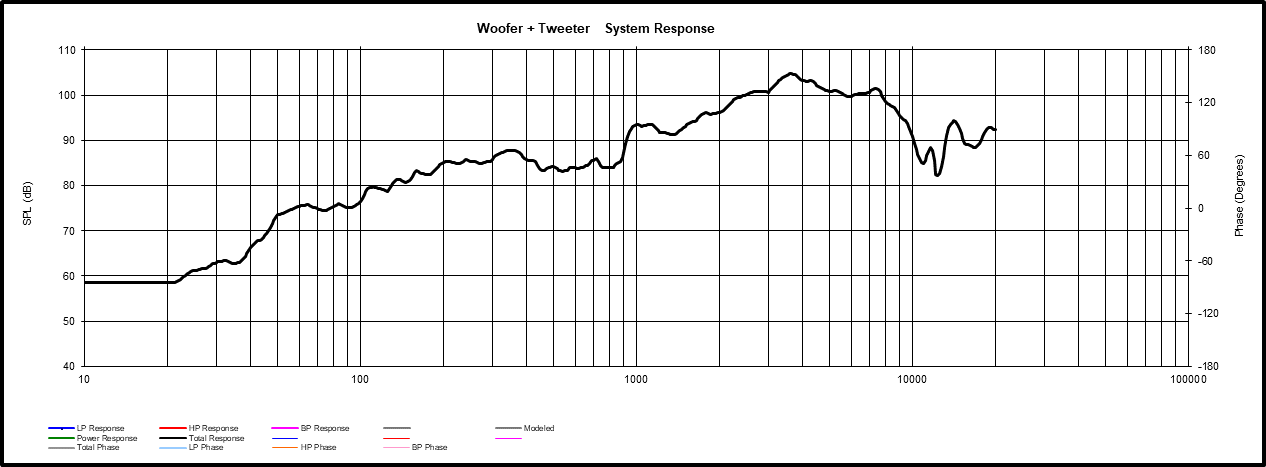

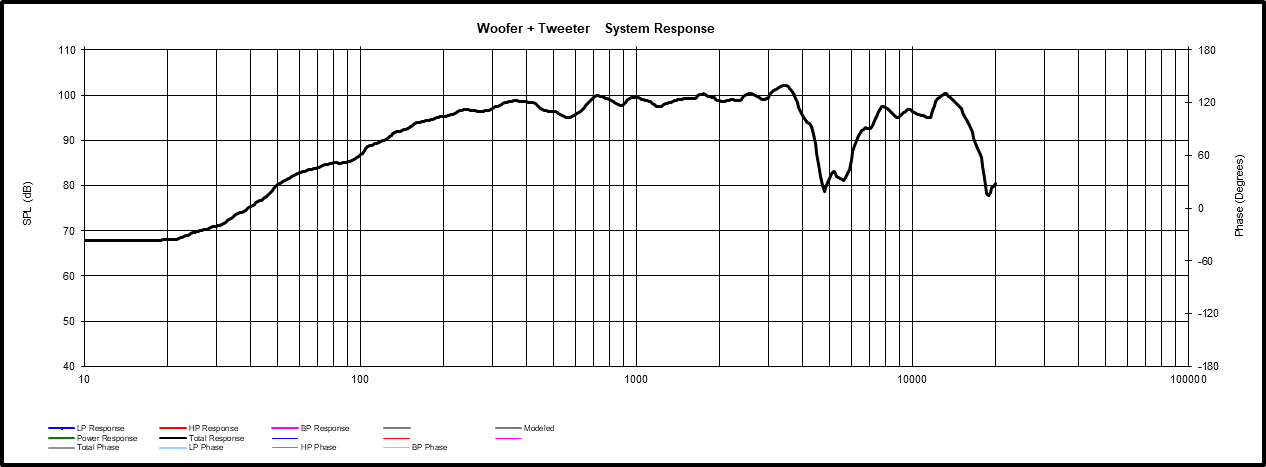

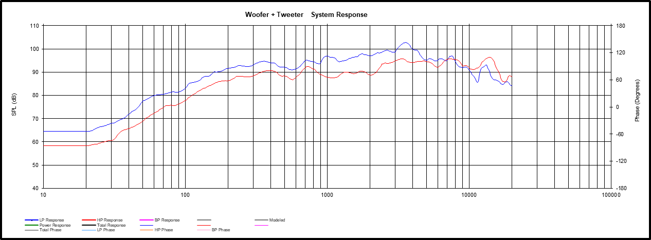

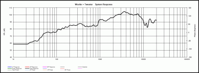

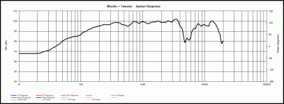

The range is the ESigma, not Sigma. I realise that sounds pedantic, but there's a reason: the current FExx8ESigmas replaced the previous (non 'E') FExx8Sigma series, which were physically very different.
OK, time for a dose of reality. Firstly, remember that the Fostex units are not designed to be rammed into a random vented box, especially with zero consideration given to alignment or anything else. While they will make noise that way, they will not do so very happily, and unless driven with a high output impedance amplifier, they will have little practical bass output below about 200Hz since they're horn drivers, and that's how they're meant to be used.
See the attached. Look at them in order. This is the FE208ESigma and FE108ESigma mounted on a baffle 25in tall x 12in wide, with 8in between the centre of the drivers. Don't say that's too difficult to understand, because if you can't cope with that, you're in the wrong hobby. I've deliberately not included box output as that isn't the major point of consideration here.
01 shows the response of the 208 (blue) and the 108 (red) on that baffle, if you were playing each by itself (not together).
02 shows what happens if you are sitting 2m away, when you put the same signal into each and play both together, with them wired in the same electrical polarity. Doesn't look very pretty, does it?
03 shows what happens if you are sitting 2m away, when put the same signal into each and play both together, with the 108 wired in inverted electrical polarity to the 208. Doesn't look much better, does it?
