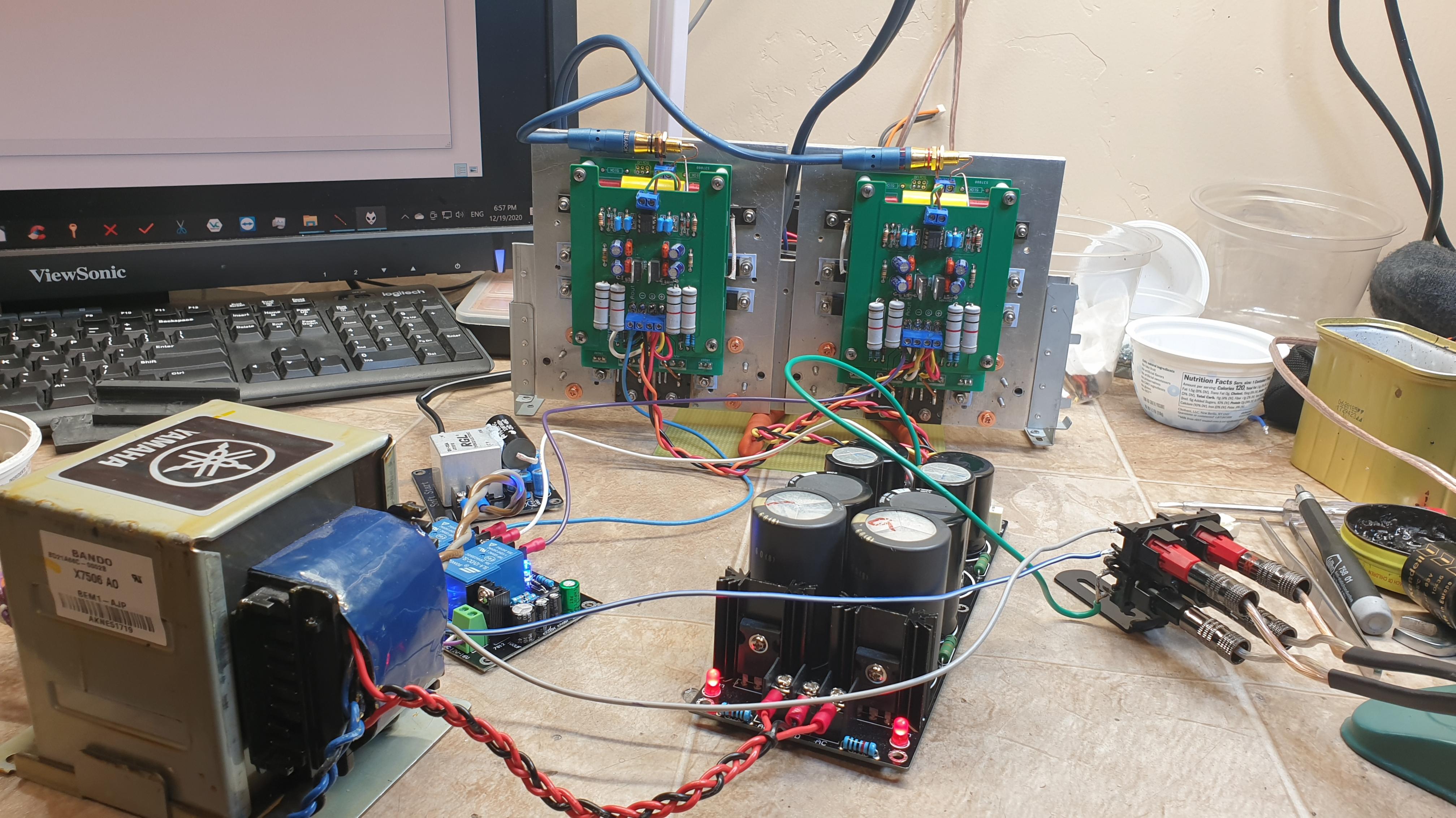

I'm preparing an "Open Air Edition" with the 2 "leftover" board replaced by the new Cu Edition ones.
It will be close to the original project, no NSCB stage added, the only variations will be:
- the Baxandall couple;
- the 24 KOhm in place of the 2 x 12 KOhm;
- the remotion of the trimmer.
It will be assembled on a cutting board, recycling a lot of components coming from a Yamaha old audio/video center (a wonderful 400VA transformer, heat sink, big value capacitors...) bought used for $20. So it should be not too difficult to try different values of components in order to adjust the idle current.
Today I received the 7pF silver mica capacitors so I have everything needed but the soft start and speaker protection that are on their way from China. So I'm working on this Open Air Edition but can't say when I'll finish, I'm always late.

The speaker protection and the soft start boards arrived today. So I had everything to start the assembly on the bench. Here is in the picture, it works good, no hum, only one transformer, about 60mF total capacitors. It runs hot.
I could not understand well the quality of the sound, it was connected to the speakers in the lab, low-end ones. Seems to lack in dynamic and deep bass, not because of the power supply, which is strong enough for the tests I've done. The detail seems to be good, the sound a little hard. Very different from my WHA-217 that is very exuberant in dynamics and never harsh in sound. Will see, during the second week of the new year, I will assemble it on a cutting board and try it with Acoustat speakers.
