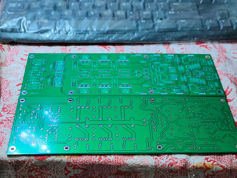

Welcome aboard andrewlebon.Joined the club🙂 pcb just arrived
Hello Berlusconi
greetings i dont have the components and the place where i live high
quality components are very hard to get .I am making a list and will
be asking what type of components are best for this amp as i have little
knowledge of electronics i will be needing a little help.

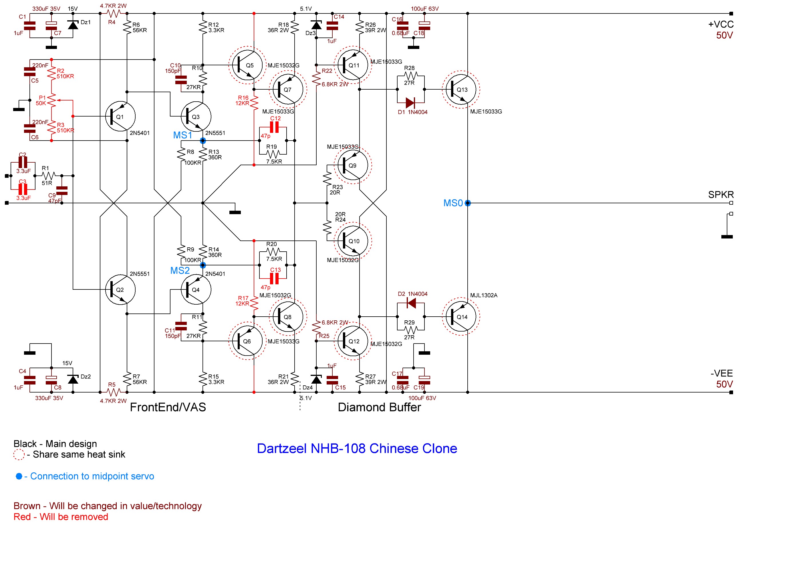

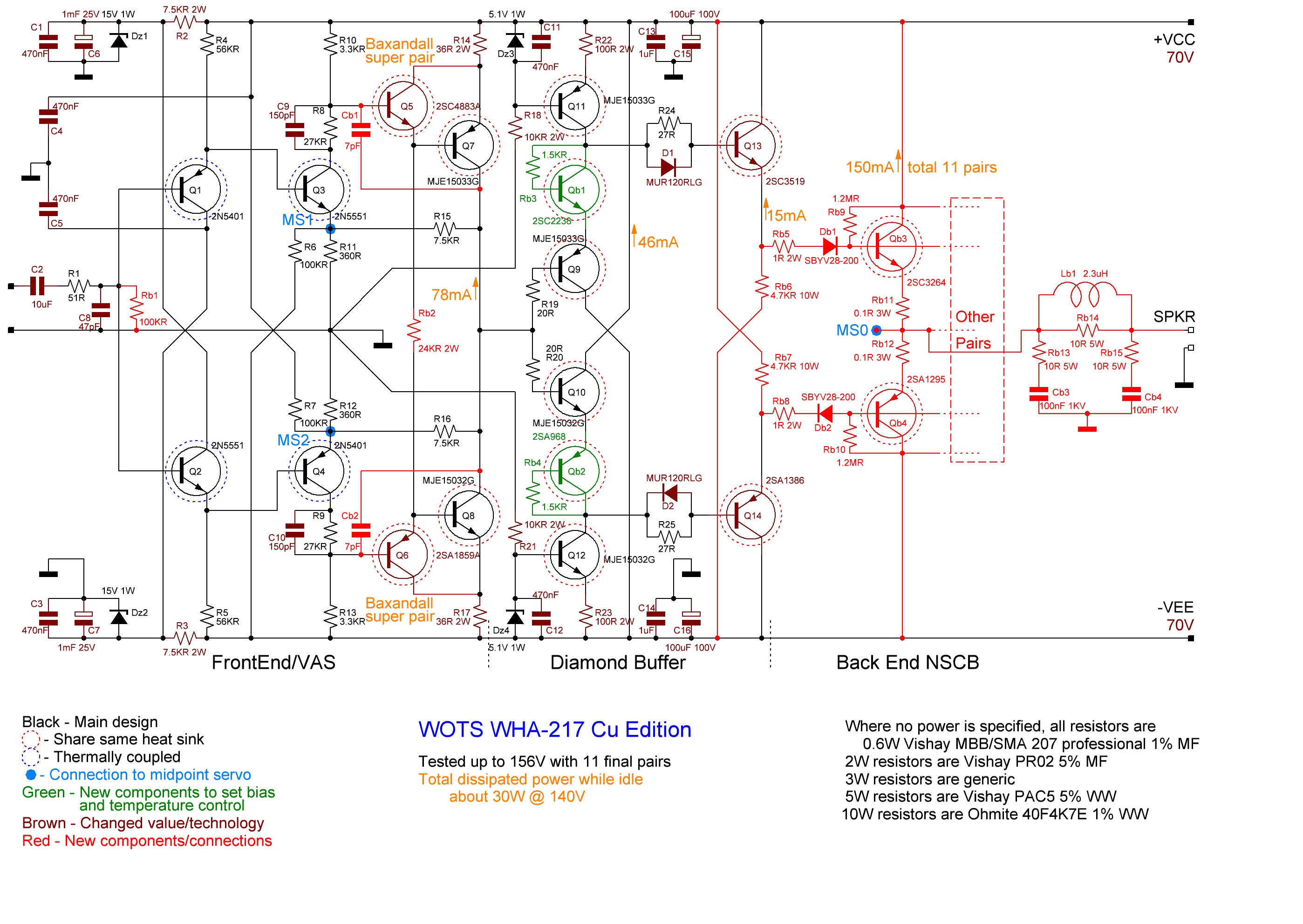

WOTS WHA-217 Cu Edition - 200W and more from the NHB-108 base.
When I started posting my experience with this amplifier I said that I didn't care about the originality of the circuitry because my goal was to find a job for my Sanken MT200 pairs and two toroidal transformers 50+50Vac 625VA each. So I searched for a board to modify, with no feedback loop from the speaker output. The only one I could find on eBay was the NHB-108.
At that time I didn't know that a thread about my choice was here!
I could accomplish my goal, I have posted my first WHA-217 some time ago and, at that time, I thought I had finished the project.
Then, receiving suggestions from some gents of you (first of all Analog_Sa, being the engine of this last activity of mine) whom I will never end to say thank you, I bought some other PCBs and "good" components, and I started a new adventure in order to improve even more.
I arrived, finally, at the WHA-217 Cu Edition.
Cu Edition stands for the fact that the board, that holds the PCBs and all power transistors, is now made out of copper 3.15mm thick. The previous assembly was made with a 6.3mm aluminum 6063 board, that needed a couple of fans in order to maintain a suitable temperature.
Cu Edition means, overall, a revision to the original circuit as follow:
- a Baxandall super pair is used in the VAS, as per 3SSS's suggestion;
- a 24KOhm resistor connected emitter to emitter replaces the 2 x 12KOhm on the first MJE1503x couple (mod confirmed by 3SSS too);
- all the resistors feeding the zeners are recalculated for 70+70V, in order to maintain the same current as of the original 50+50V project;
- the midpoint trimmer and resistors are removed since they were a source of a noise coming from the power lines, and the voltage micro-fluctuations made the midpoint really unstable; a 100KOhm resistor is placed between the center of the removed trimmer and gnd; the midpoint is now stable, with a small offset, around +/- 1mV without servo and the servo is now keeping the midpoint stably, very close to zero;
- the servo circuitry is not modified, I tried to place a long time constant at its output but it was worse because, when the midpoint reached zero, the time constant was still trying to correct the offset; so I removed any modification and kept it as the original.

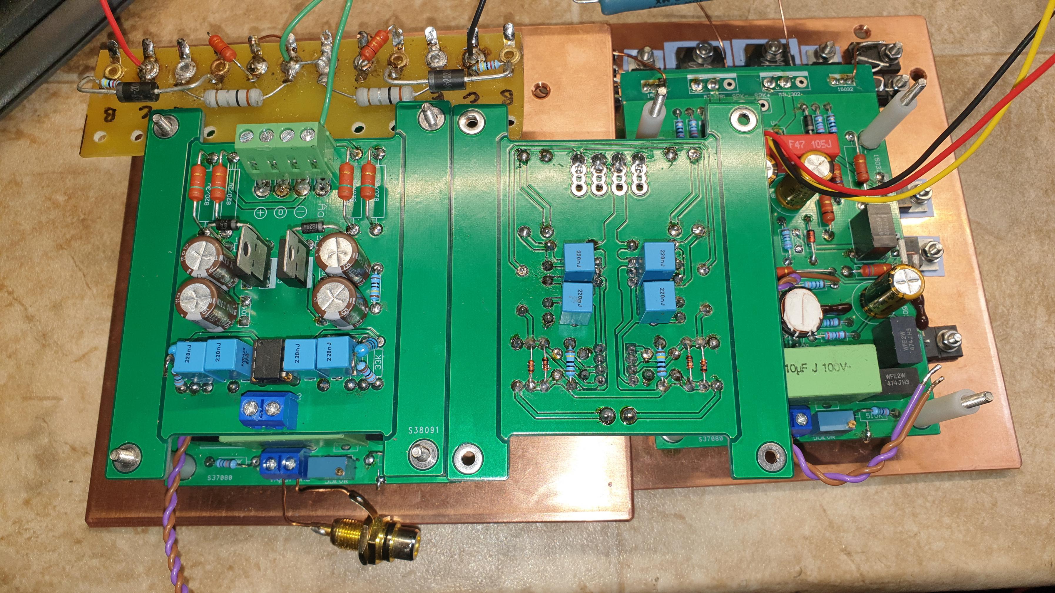

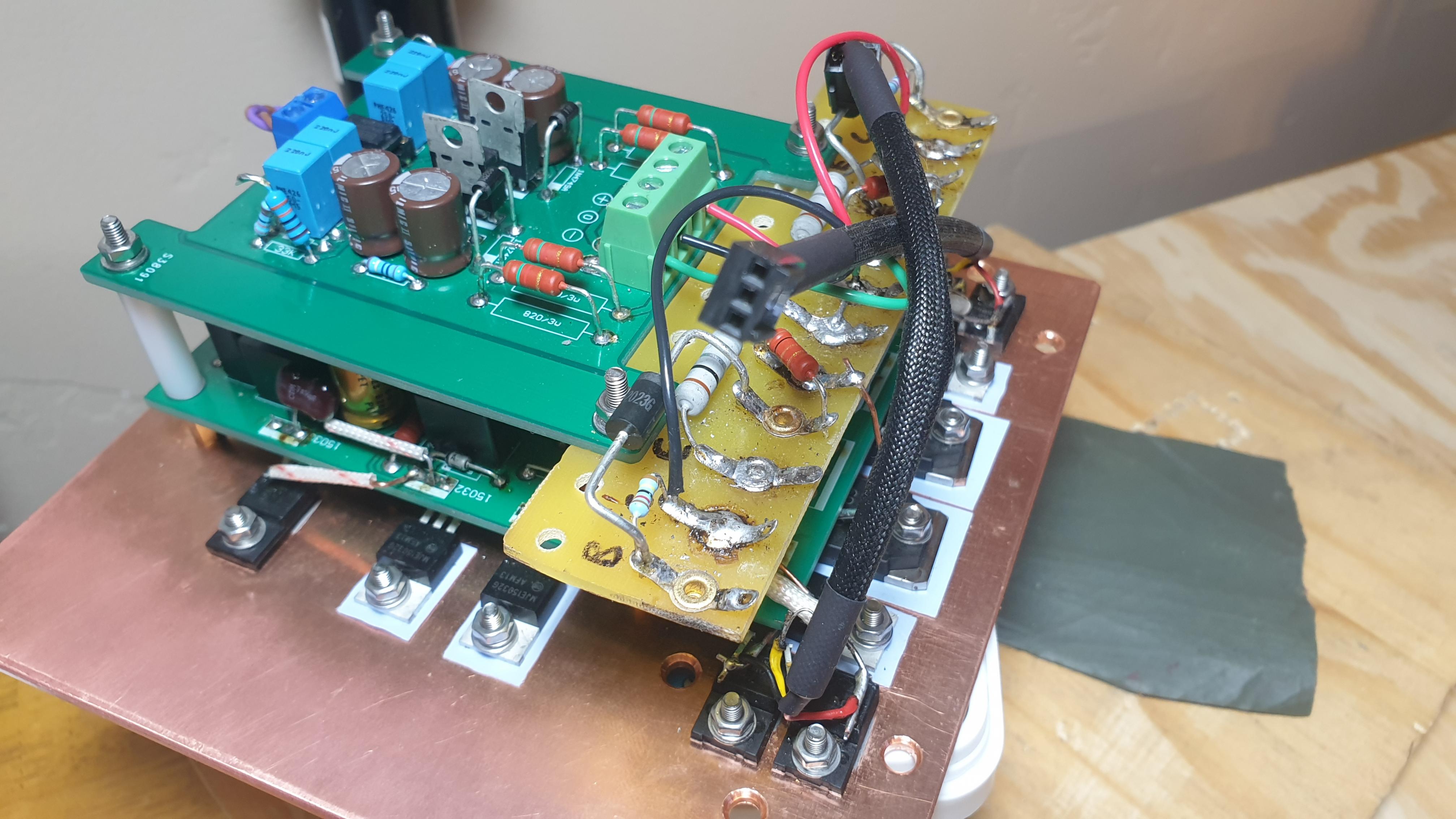

What I added to the original NHB-108, since my first WHA-217 edition, is a power stage working in NSCB.
I had to add also a bias/temperature control, now made with a pair 2SC2238/2SA968 (I had a close hfe selection but actually any TO220 NPN/PNP pair having a matched hfe greater than 100 will be good).
I didn't want to buy too fancy components. My choice was made as follows: everything has to be bought from official distributors Mouser or Digikey among available and active components at the moment of purchase, avoiding too expensive items.

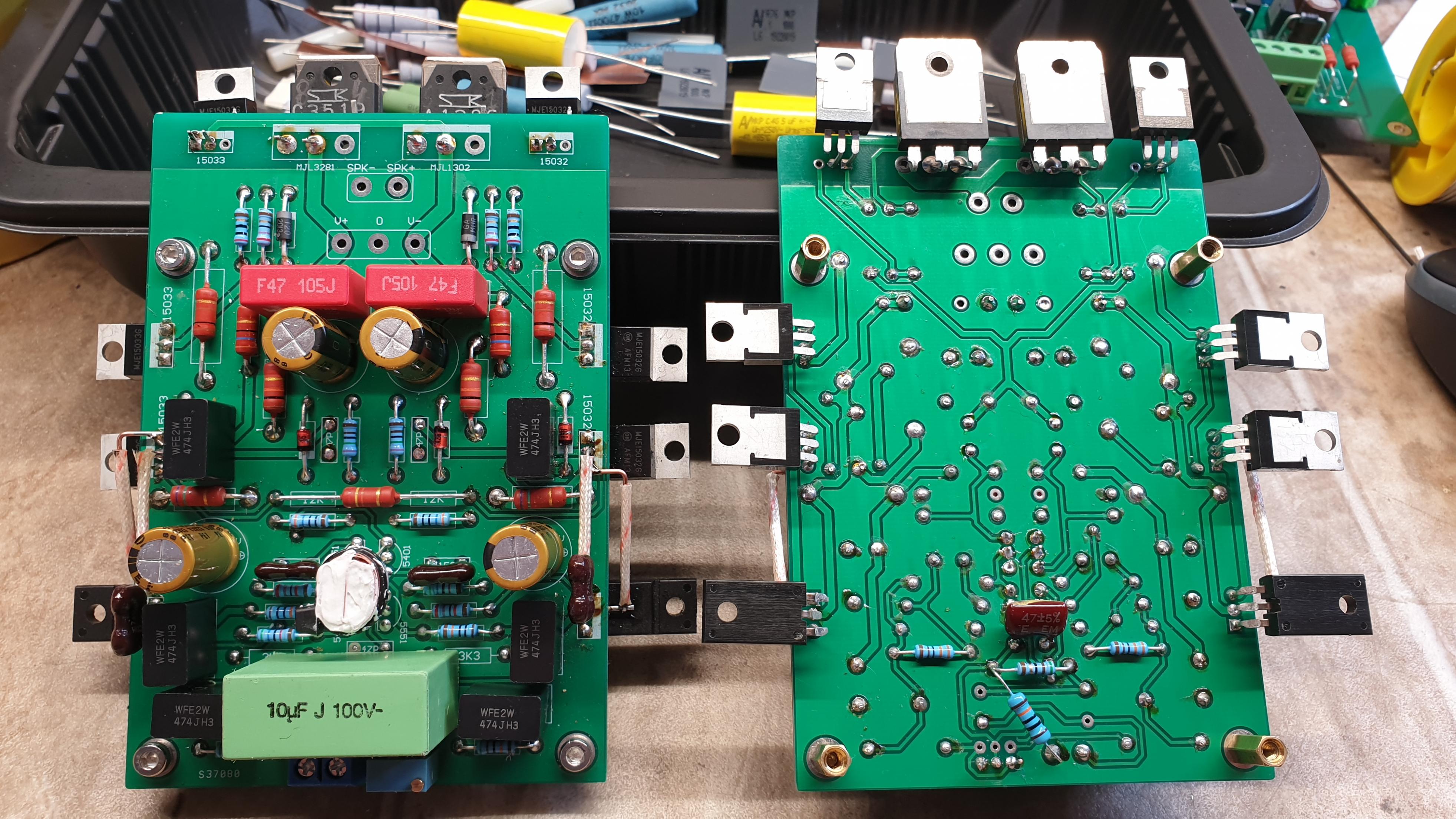

Dealing with components on both main and servo boards:
- all film capacitors are polypropylene but the input ones, being ERO MKT1822 (waiting for a job, in a drawer), according to all reviews super-super good for audio; being polypropylene capacitor bigger that the polyester original, in order to fit in the PCB, some capacitances had to be lowered with no problems;
- all electrolytic capacitors are audio grade (Nichicon Muse on main, Elna Silmic II on servo); all original ceramic capacitors are now silver mica ones;
- all small resistors are Vishay MBB/SMA 207 professional 1% 0.6W metal film; all 2W resistors are Vishay PR02 5% metal film, best matched in a bunch of 10 a value;
- bigger resistors had to be wire-wounded 1% ones since no metal film resistors were available for such a power.
I substituted the first MJE1503x pair with 2SC4883A/2SA1859A Sanken and the (original) final pair (now drivers) with 2SC3519/2SA1386 Sanken for the only reason that I had in my drawers a close NPN/PNP hfe selection.
I am so sorry but couldn't follow Domenico's good suggestion to use the NPN/PNP array in place of 2N5551/2N5401, once I looked thoroughly at its datasheet, I learned that the array is really tiny and I'm not equipped to make the eyes to the fleas. I coupled thermically the four transistors all together with thermal glue and a strip of 0.3mm thick copper foil.
Dealing with PCB:
- a correct gnd path does not exist, the gnd is made by the whole upper copper foil; too bad, nothing to do;
- the whole bottom copper foil is insulated; I connected it to the upper foil;
- there are 5 pad holes metalized made in order to connect tracks laying on two sides; since I don't really trust the metallization of the pad-holes for audio purposes, I put a lead inside any of them and soldered them on both sides.
Having in mind that my WHA-217 has to be connected to my Acoustat 1+1 speakers, which generate a lot of disturbance, I had to be very prudential.
It seems that the two Baxandall super pairs are ok but I didn't want to tempt fate too much so, where in doubt, I kept a conservative approach. It is the case of the CCSs: reading around I could not understand if a CCS made out depletion mosfet/resistor would be better than the one made out BJT/zener/resistor so I kept the original CCSs that are not that bad and work without any problem.
I couldn't find any good solution to avoid the zener diodes on the first stage, so they are in place.
And, yes, I'm using the servo that, with good components, is doing very well, far better than any electrolytic capacitor.
What I obtained overperforms my expectations.
This Cu Edition reveals everything in the signal. And the sound is very realistic, I had Karen Carpenter just three meters before me singing with her super clear, articulated and powerful voice, and then Dan Gibson's gregorian chants, Perpetuum Jazzile, and a lot of other music I cannot mention here, where I could immerse myself for a couple of hours. Differences between 1st version and this Cu Edition are not so tiny, a light veil now is removed and the realism is even increased, perhaps the Baxandall super pair does the magic.
Distortion? I really don't know, being a class B push-pull we cannot expect the monotonically decreasing Fourier graphic. I used the Microcap (thanks to Bogdan Borko) to sim my WHA-217 and the distortion is not low at all, trying to improve the distortion I simmed to draw over 20A then decided to come back to my original idea: Class B. We listened at the amplifier almost a whole day to watch television, shows, movies, and so on, with audio coming from the computer: no listening fatigue at all, you really mind turning it off late in the night to sleep.

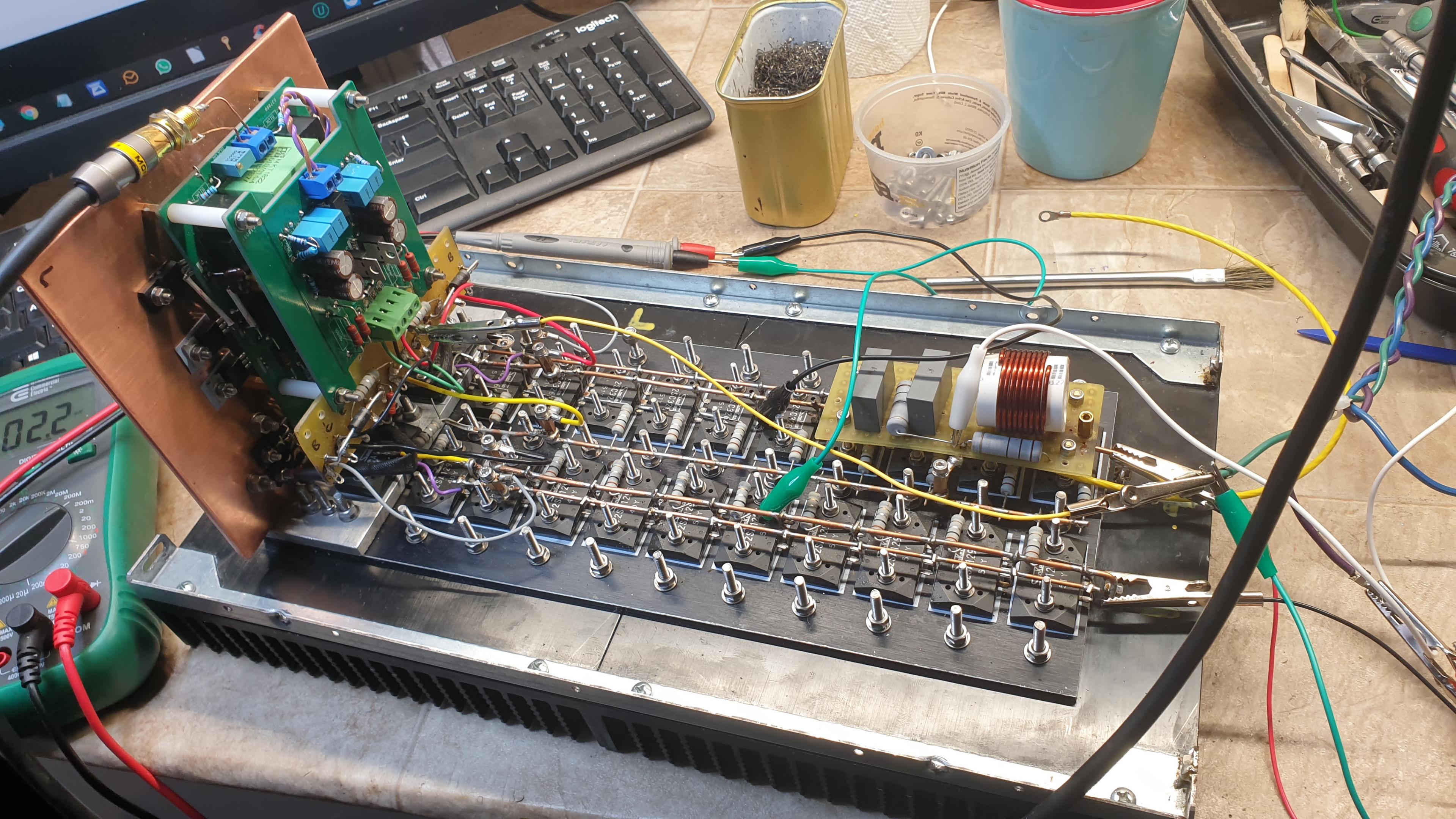

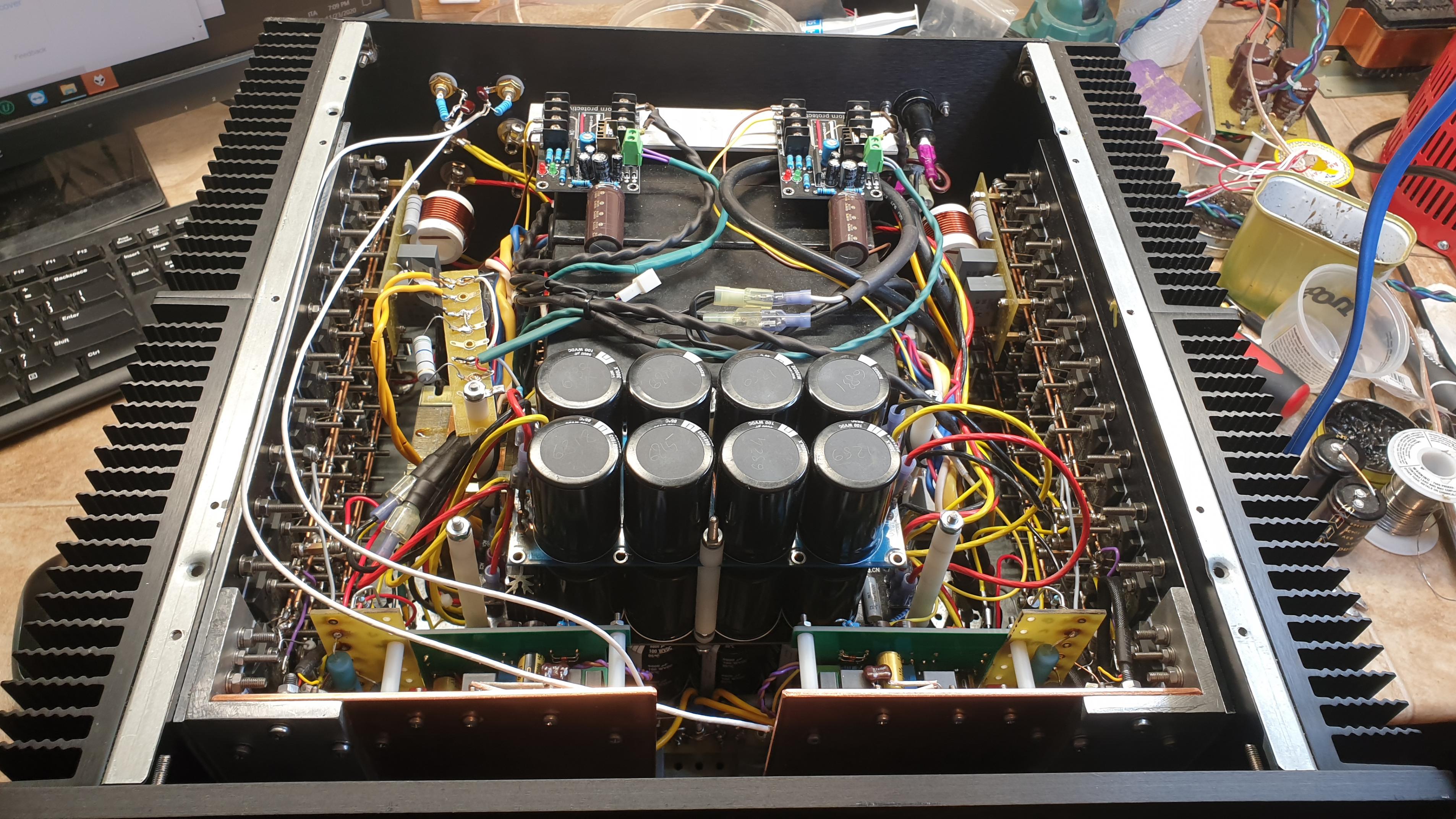

Here are some pictures: the original Chinese clone schematic and the WHA-217 CuE (11 pairs are used), drawn in a way that you can easily see differences, and some other pics taken during the work.
By the way, the two fans are still in place, the temperature is almost the same as the one with the aluminum board. So the super expensive copper boards are not worth it. All the rest YES!!!

Wow, marigno, grazie mille!
Thank you for taking the time and effort to write such a long and informative post! I had great time reading all of it. BTW, nice touch with the color-coded schematics 😎
I do not have a 100% clone as well and wanted to try the Baxandall(-ish) super pair tweak for some time now 🙄
PS: Yours is a truly impressive build!

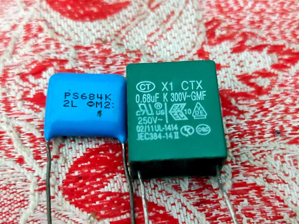

Better no. The green one is supposed to be connected as a filter on AC power lines as an EMI suppression capacitor; about the blue one, I cannot identify it. You must use polypropylene capacitors, they are bigger than polyester ones so, in order to fit them in the PCB, you must reduce their capacitances. Take a look at my last post what was my choice.
About the servo, if you are using it: capacitors MUST be polypropylene 5% tolerance or lower. Take a look at my pics, you must fix some components on the opposite PCB side.
WHA-217 CuE Component list 70+70V
Thank you for your appreciation!
About the Baxandall super pair: you should!!! It is a simple mod.
