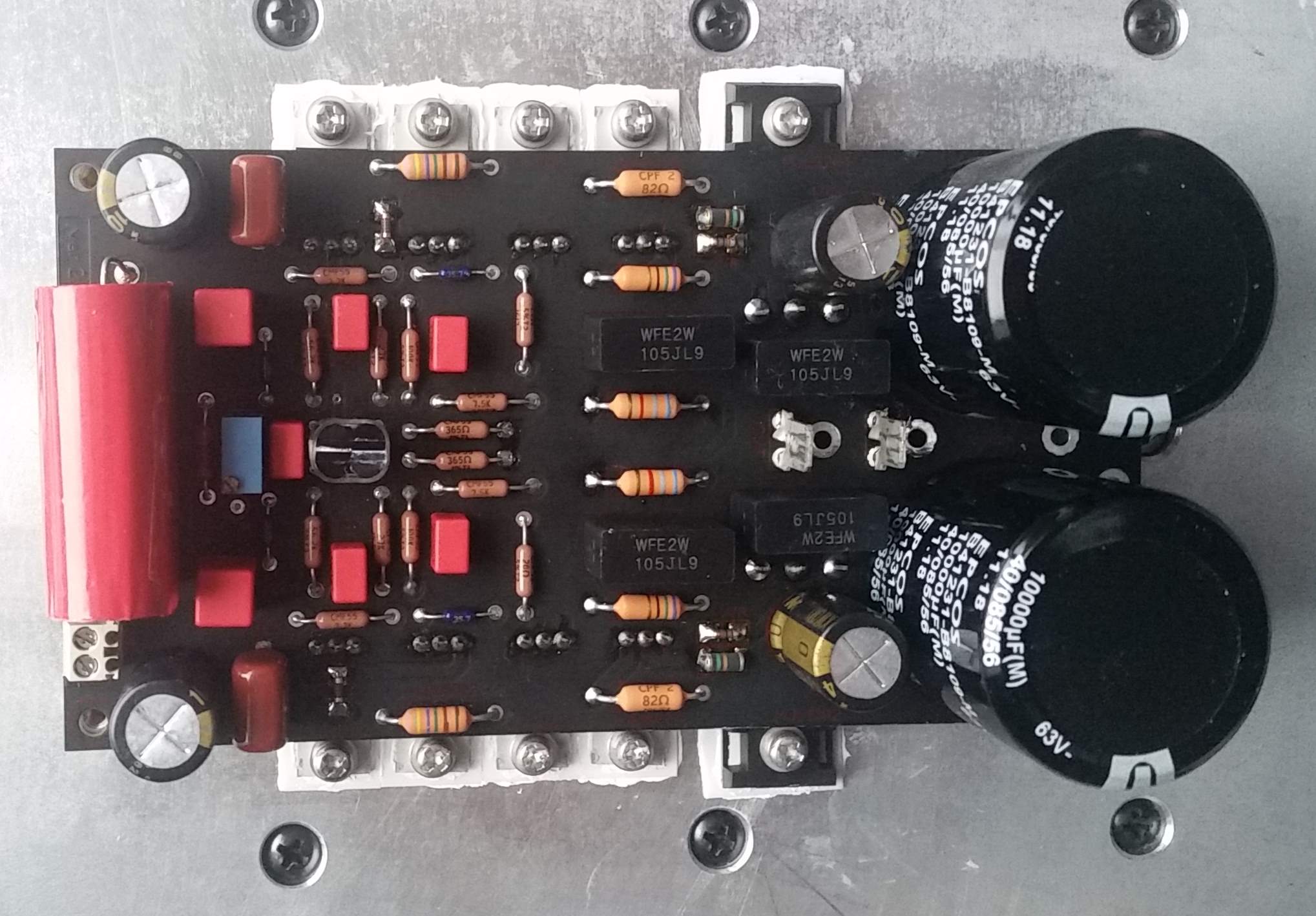

However, I can see furter improvement: Another board suggested by Paroxod4 and built by "garrbage". I am shure this board is the way to go further towards even better sound. I'm not sure but as far as I can understand, this modifier board addresses important issue: inductance of wirewound resistors.
I hope our friend "garrbage" may provide us with more information about this board.
Uh, what?
The board has one obvious advantage: it places the large electrolytics exactly where they are needed. Not sure whether it solves the only real issue of the "original" layout - the poor grounding, which does not separate the input grounds and instead uses the lazy ground plane approach.
Btw, not sure if this has been discussed in the thread, but the original 108 does not connect the speaker return to the ground terminal on board but instead to the capacitor bank. It makes a subtle but worthwhile improvement.
