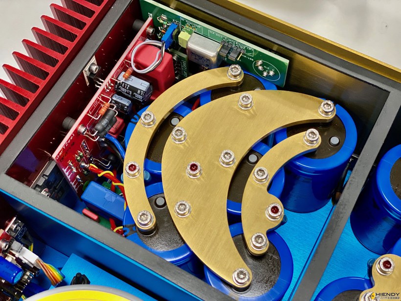

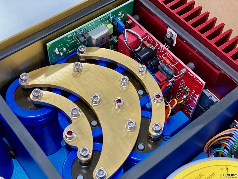

Yesterday I leaved the amplifier hot with offset Left ans Right channel close to +-16mv
This morning amplifier cold ( 20°C)immédiatly after power on L-107/R+140 degreasing 2 minutes later L-79:R+110 degreasing and stable when I come back 45 minutes later.🙂
I could say the copper heatsink is a very relevant solution concerning the stabilisation of the offset Thank you very much Parodox4 for this :up:
I tried this afternoon to achieve offset zero it is not so easy because the two channels offset seems to be linked you touch one the other move :scratch1:
Iwould like to know why if anybody know I thank you.
Nevertheless at this moment L-5/R+5mv 🙂

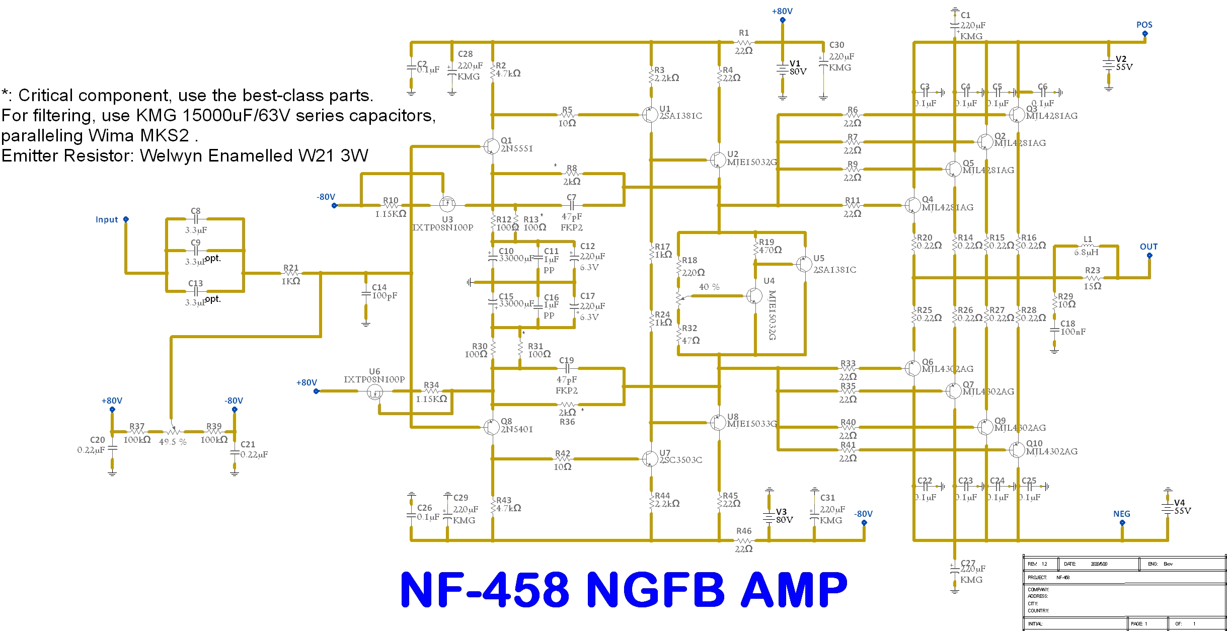

Finally, I decided to contribute what I have done, NF-458.
NF-458 stands for Non-Feedback 458.
Some Disclaimer:
1. I have no intention to imply or claim that this scheme has ANY relationship to DartZeel's any product, especially NHB-458.
2. It is my personal iteration of non-global feedback design, which may or may not be similar to NHB-458.
3. I have no intention to imply that NF-458 is identical to NHB-458, it is reader's own decision to consider whether NF-458 is or is not identical, or similar to NHB-458.
4. All information posted here is hosted just for discussion purposes and provided AS IS.
5. In no event shall the author, I, or any other 3rd party, be liable for any special, direct, indirect, or consequential damages or any damages caused by any form of this scheme.
