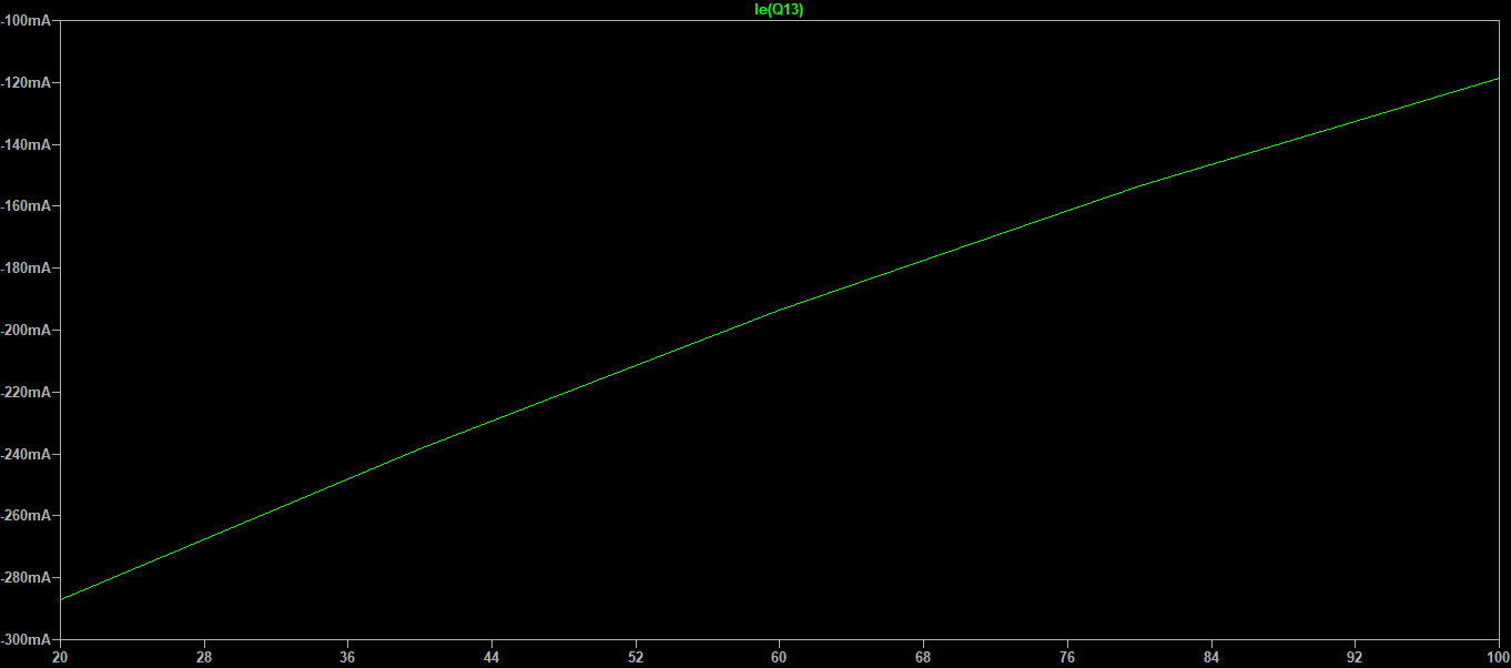

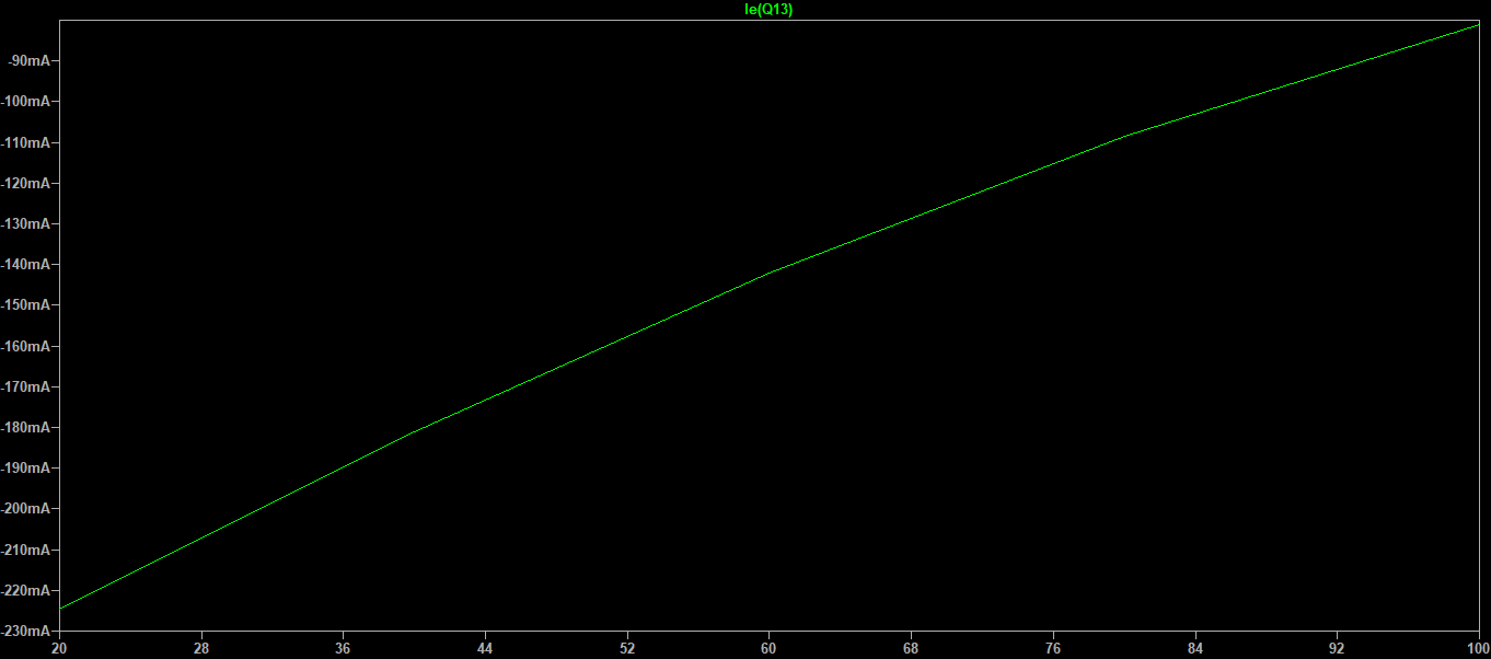

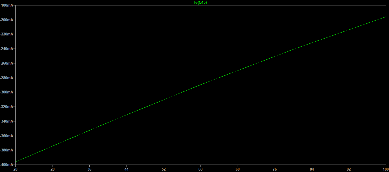

I'm waiting for a case from Modushop, and I had an idea and had to make some sims:
Increasing the base resistors for the drivers increases the idle current too. Not sure what adverse effects there might be. Tradeoff is that decreasing base resistors on the outputs lowers output impedance, but this increases it slightly, but should be 'safer'. Maybe some 150 Ohm trimmers instead of the driver base resistors could be an interesting experiment..
Comments welcome!
Below are some sim plots of idle current vs chip temperature (drivers/CCS/outputs) with varying base resistors on the drivers.
Standard 20 Ohm resistors:
50 Ohm resistors
100 Ohm

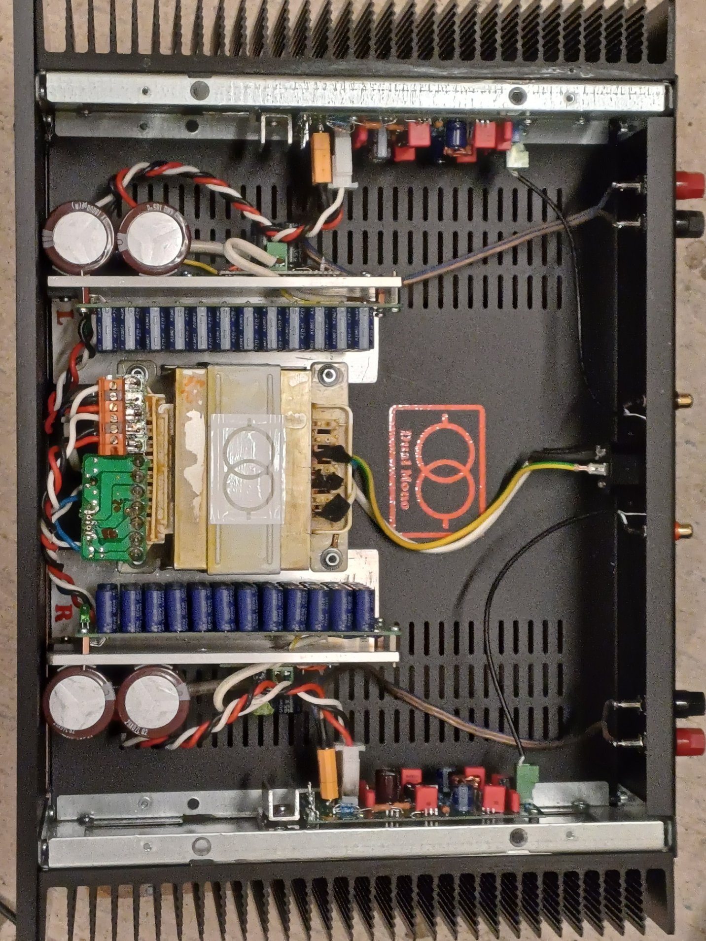

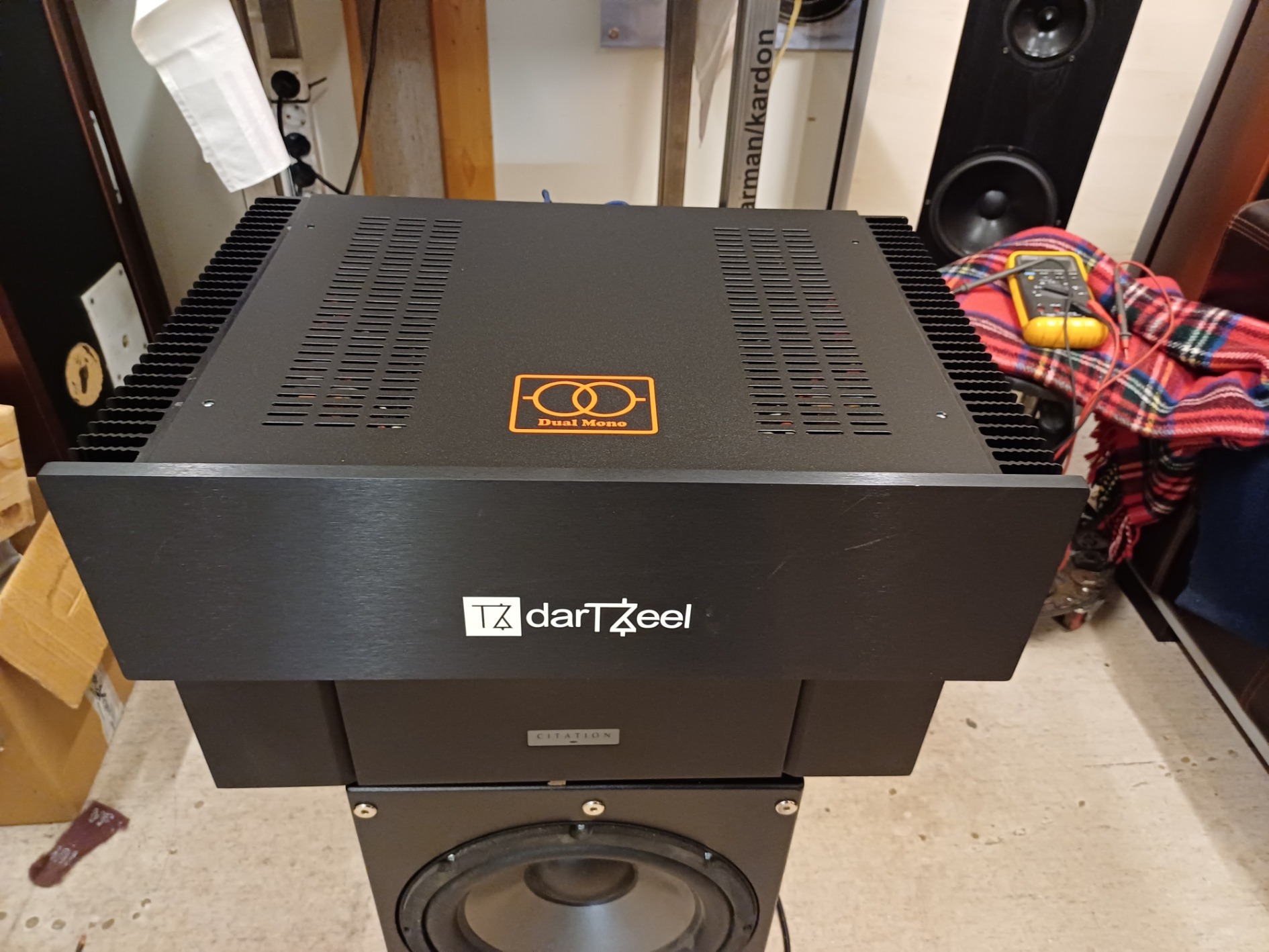

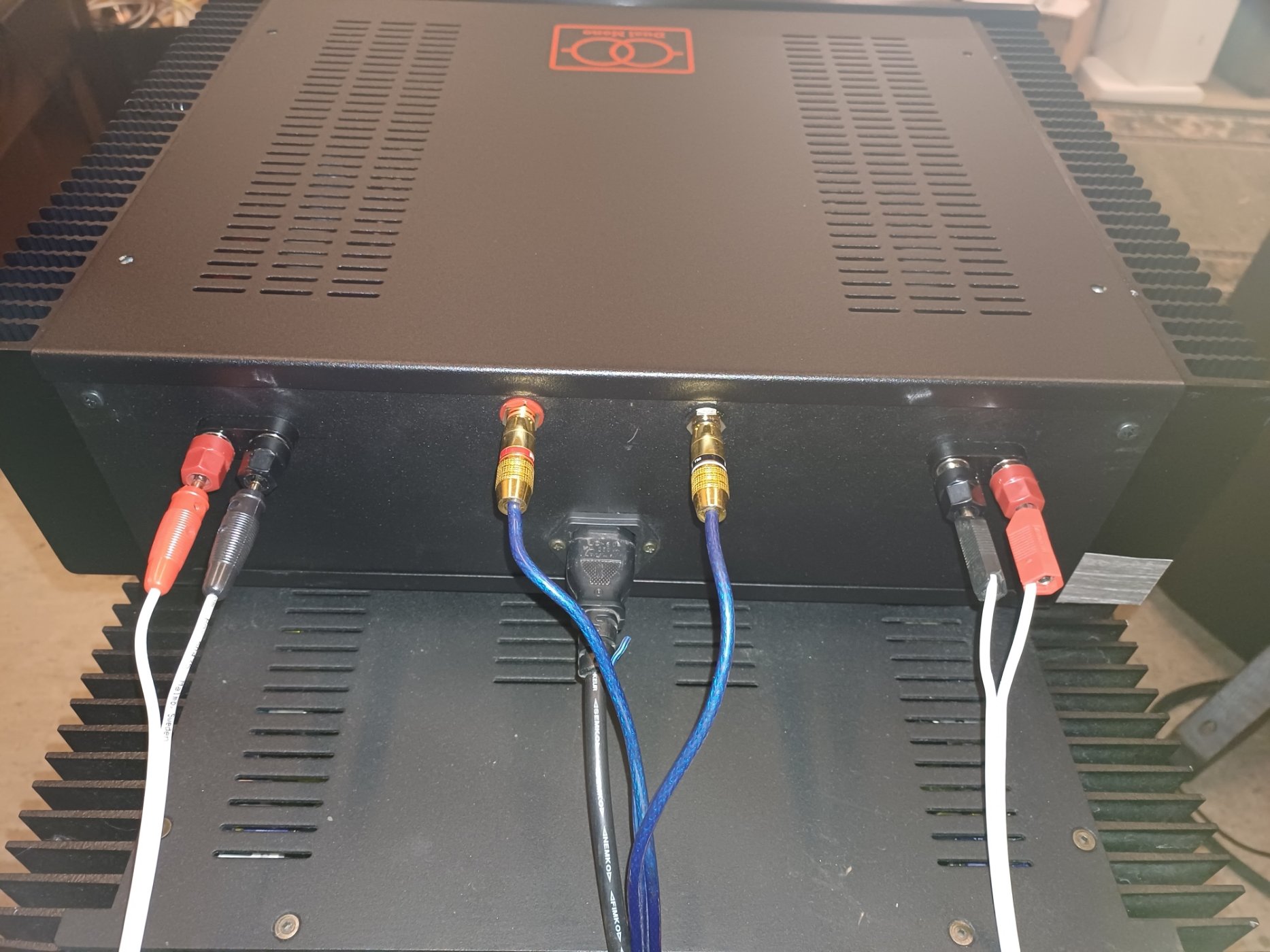

Now it's boxed and decal-tuned (have a decal cutter at work). There are still some minor things to finish up, and maybe play around with the resistors/idle current some more.
Another way to do that could be adding a 'spreader resistor' between the VAS transistors, just a few ohms would increase the current significantly.
After that it's time to put it in the living room and try it for tweeters in the active system. The transformer is from a Onkyo surround receiver, and I was able to split the secondary windings to get 4x22VAC and have about 29V rails after the ripple eaters.
Some pics:
