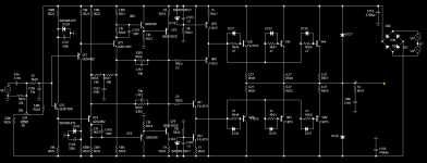

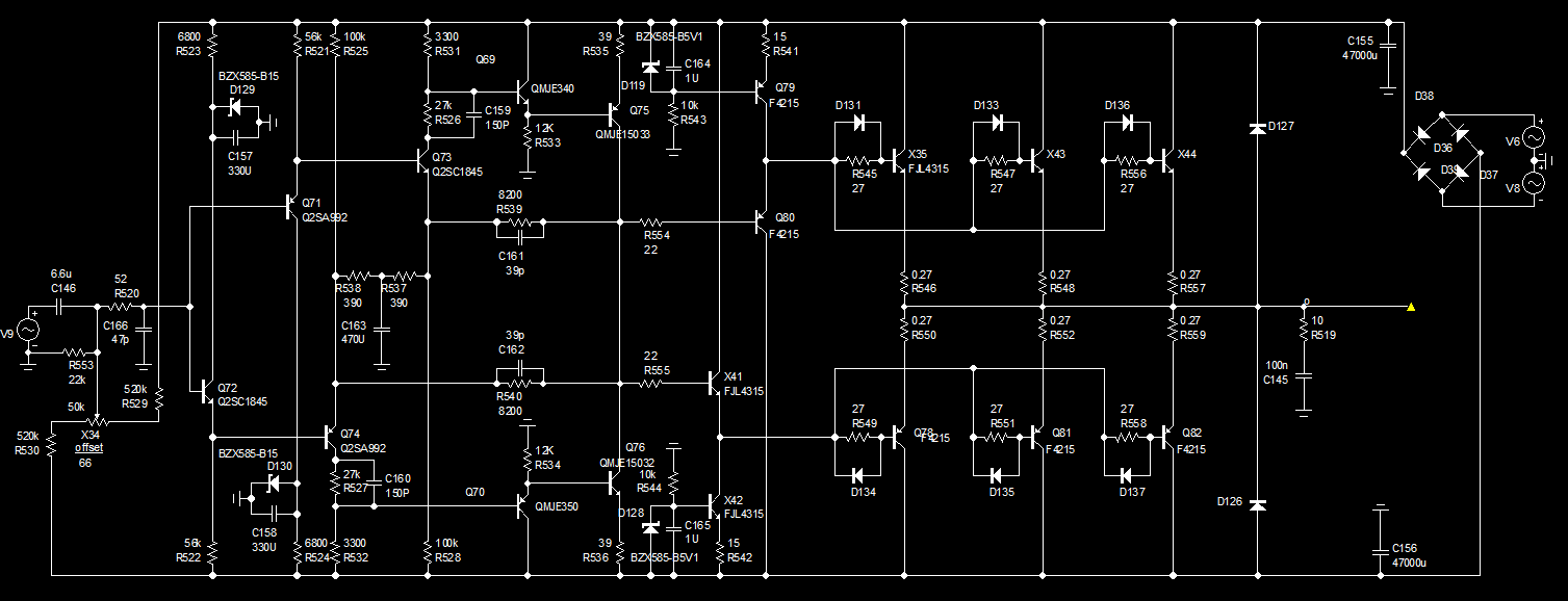

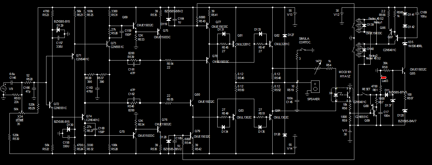

This is a schematic of the Dart. double transistor with protection only simulated by me on microcap12
And this with triple. Note that the driver bias must be increased by double
I was thinking about multiple outputs the other day, -maybe it would be possible to run multiple output pairs with just the base resistors and skip the emitter resistors because they increase output impedance? The base resistor 'mirrors/emulates' an emitter resistor times the hfe of the transistor, so matching them for Vbe and hfe could make it feasible? Could even be possible to do some fine tuning on the base resistors to even out the current sharing between outputs?
An example is the 27 ohm base resistors act as 0.27ohm emitter resistors if the hfe is 100.
With emitter resistors only the change in Vbe affects things, but with base resistors the change in current gain and the change in Vbe work together for even more asymmetry (gain rises with temperature). Its the dynamic imbalance that causes problems, not the static imbalance - no amount of static matching will stop dynamic imbalance from developing if the thermal feedback is too weak. And in general its asking for trouble to design circuits that expect stable values of hfe - hfe isn't well characterized and varies with device, temperature, current, collector voltage and history - its like expecting an electrolytic capacitor to have tight tolerance...
Yes, it's a odd workaround, but I guess bias stability is not critical, since it's very 'overbiased' compared to a standard AB output stage. Variations in the bias current will just vary the class A operation area a bit. The output stage is not exactly following the mainstream design 🙂 Seems priorities have been elsewhere, seems it's been 'bodged' together, and still received some nice reviews, that makes me curious..
I have finished one board and played around with it a bit on the bench. What I found out so far:
-Scope test look fine, square wave is super clean, and clipping looks ok too.
-Very sensitive DC offset. I'm running it on bench supply, and as soon as I touch one of the rail voltage setting s bit, the DC offset runs away. After adjusting it with a warmed up amp, it's more than 100mV off when starting cold. All the small signal transistors are thermally connected glued to a small alu-piece and copper tape around them.
-Idle current is actually pretty stable, much better than I initially thought.
-Diodes don't seem to matter as much as I thought for distortion. Only on high levels/currents do they give some negative effects in measurements.
-Distortion is pretty good on low levels as long as the output stage is in class A. Only H2 and H3 visible, and they are about -70dB
-When it's cranked up a bit or with a 4ohm load, the distortion goes up a lot, and has a wide spectrum of overtones, distortion level maybe 40-50dB below signal.
-Adjusting the base resistors for the outputs seems like a feasible way to adjust idle current, even if the effect is less than I thought. Halving the resistance (22ohm in parallel with the original resistors) increased the idle current abt 100mA. I guess there is a Vbe compensation from the drivers. Decreasing the resistance also (in sim) decreases output impedance.
-I found that 'balancing' the base resistors can reduce distortion and modify the harmonic profile. When they are 'balanced' H2 and H4 goes down significantly (up to 10-20dB). Also some of the higher harmonics are affected, mostly even harmonics. I guess the hfe-diff between NPN and PNP are balanced out with base resistor tuning. In my case adding a 100ohm trimmer in parallel with the NPN base resistor allowed me to balance it out. If this is better or even audible is another matter.

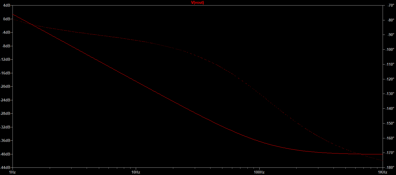

I did some sims of the amp, and found something that I don't think has been discussed before. It seems the PSRR of the amp is really poor at LF with the 6uF input cap. Basically what this means is that if the rails sag a little bit, it translates into the output, and bass is poor. If the rails are super stable with mega caps, there will be very little rail sag even at LF, but all caps have rising impedance with decreasing frequency..
Here are some sims, first with the 6u input cap:

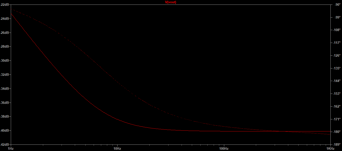

And 20u:

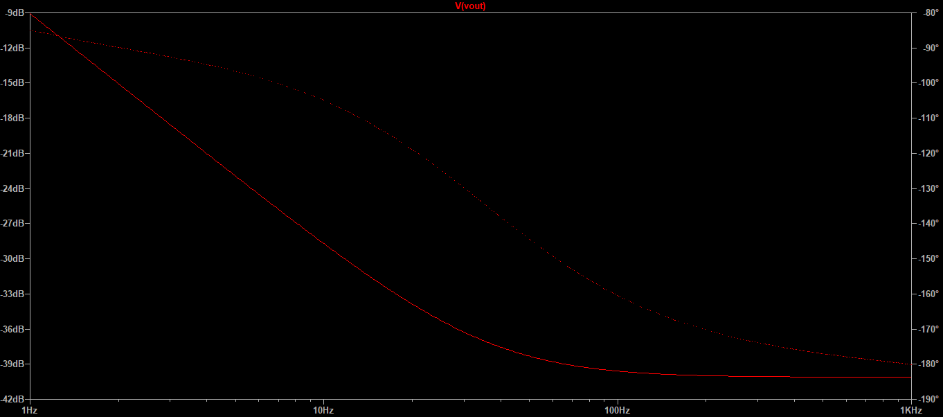

And finally 100u
This is simulated with 1V ripple on the positive rail only. The effect is cancelled if both rails sag at the same time, but they never do, they always alternate depending on if the amp is drawing from the positive or negative rail.
In my mind 20uF looks like absolute minimum, but more is better.
Source impedance was set to 200 Ohm, but that does not seem critical.

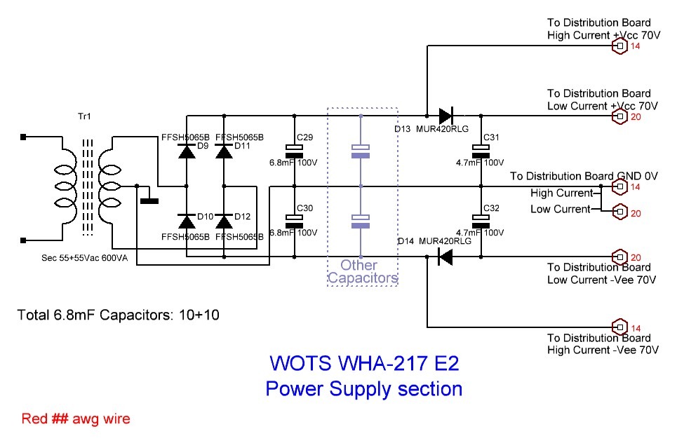

You are right, This happens even in my variant WHA-217 E2 (around post #2107), for this reason, I used 10x6.8mF capacitors per rail/channel and decoupled the VAS from drivers/buffer using a diode per rail, trying to synthesize a sort of stabilizer for the VAS, and it seems to work. Somewhere in an old post of mine, there should be an analysis of the behavior of the diodes setting the quiescent current.

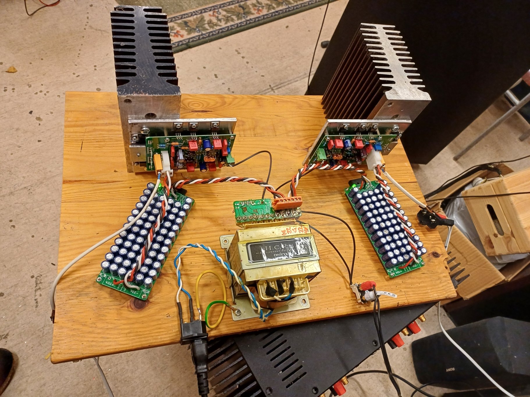

First sound today. I made a 'plank amp' for testing, minek here on the forum made it an art, but this is not a beauty, just a way to connect everything and test it.
The transformer has dual secondaries, so it is basically dual mono, but sharing the same primary winding. Cap banks are abt 4x16mF, cooling is more than sufficient for the 30V rails,
I have 50Hz hum, and it seems to be related to supply ripple, not ground loop, but I need to check it more still. Not a lot of harmonics it seems, but mostly 50Hz. I quickly measured between rails with the voltmeter on AC, and got a 130mV reading. DC offset seemed ok too.
I listened to some music on my 'garage speakers' which are decent sounding 3-way Yamaha's going down to 4ohms in the bass.
As expected, I was not impressed with the bass control, but mids and treble sounded pretty good. I would say 'airy' mids and treble. Sounds a bit like a tube amp (I have very limited experience with them though), both the good and bad I guess. This was without the diodes mounted.
I need to play around with it a bit, diodes, base resistors etc. Need less hum and, if possible, better bass control.
Any thoughts on changing the 'driver CCS' zeners and resistors to get the output swing closer to the rails, but keeping the current the same? As it is now, it clips abt 5V below rail voltage. Seems like a 'free lunch' but usually there is a catch.
