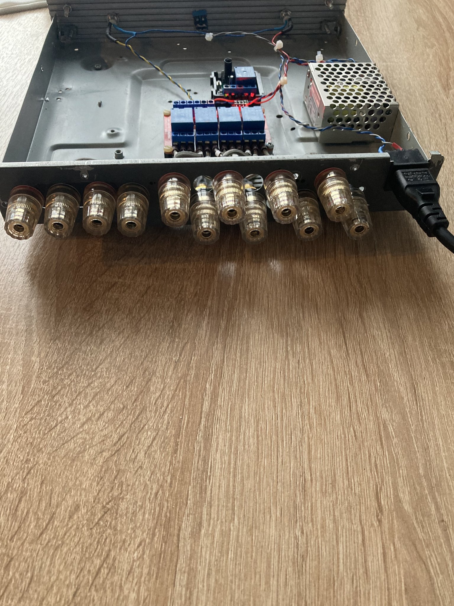

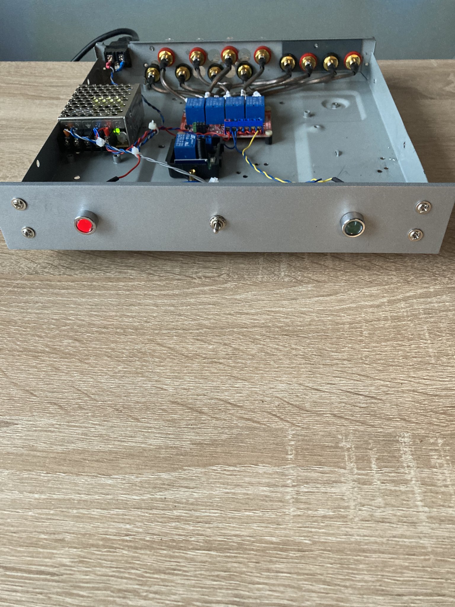

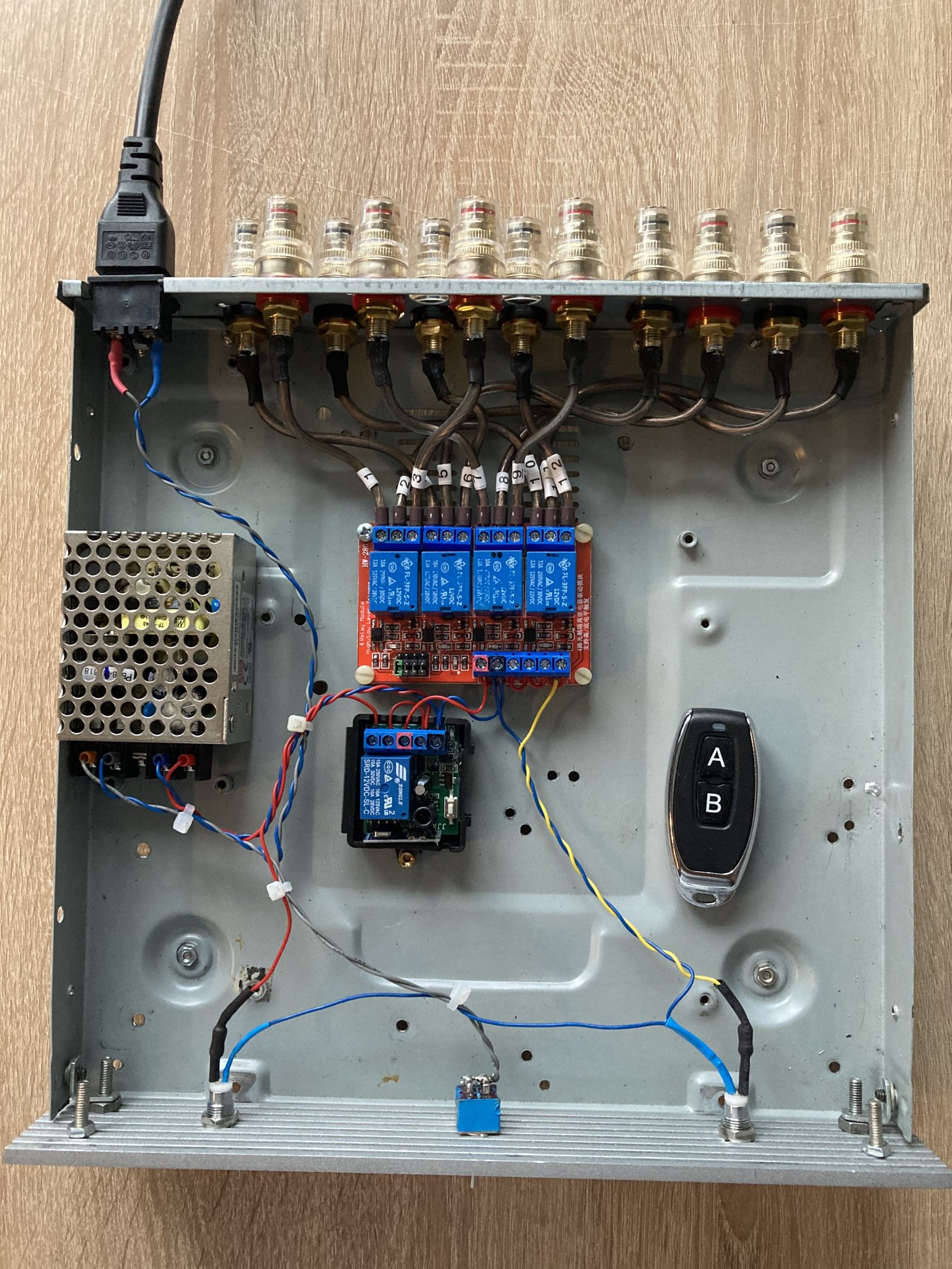

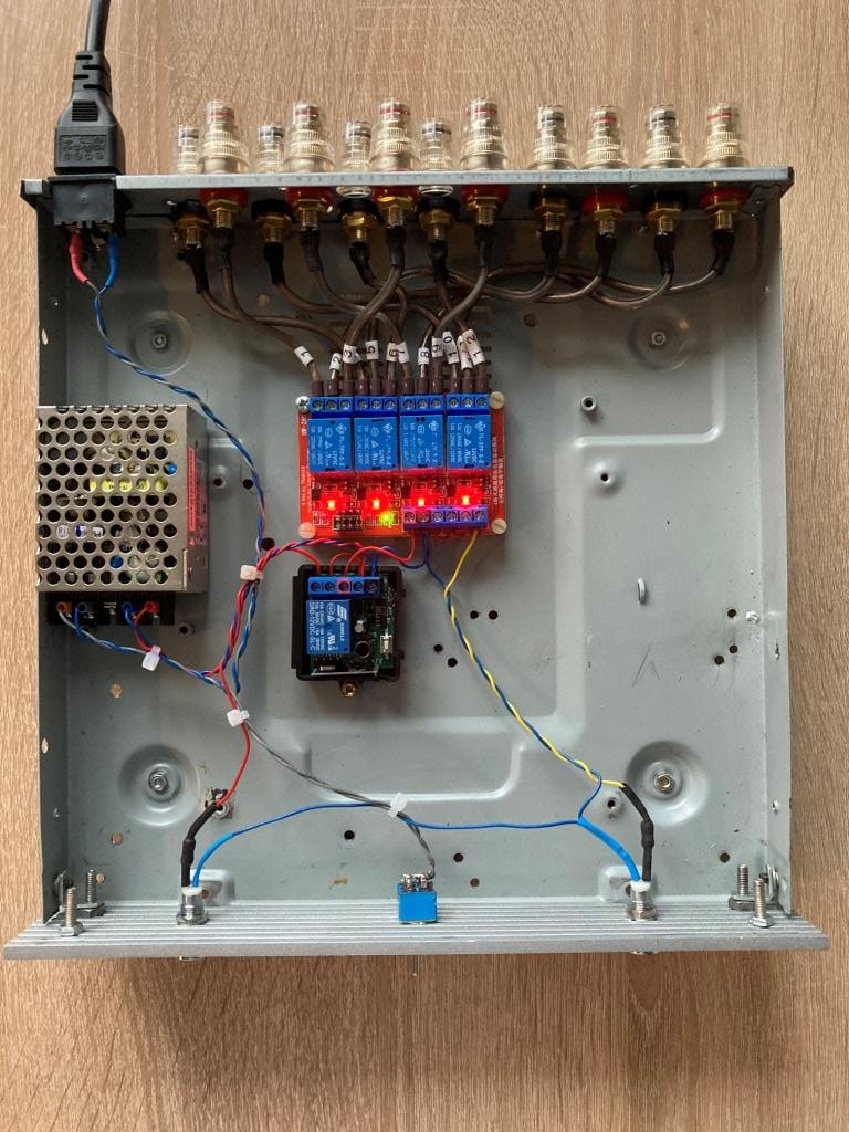

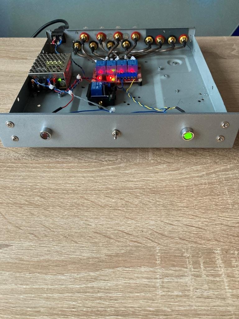

I made such a switch with a remote control, it is very convenient to compare 2 amplifiers for one speaker or 2 speakers with one amplifier. The switching is almost imperceptible to the ear. There is no need to switch cords. The cables are all the same, even the Cardas interconnects. I am writing this so that they understand .If you assemble Dartzeel, then try to make the main board as in the original. If you experiment, then we no longer call it Dartzeel.When I finally decide on the amplifiers, the switch will of course be disabled.
Can the switching be automated, thus allowing bind testing?The switching is almost imperceptible to the ear.
When the controller is turned off, one output is constantly connected; mine is Dartzeel. When you turn on the controller with the toggle switch, it also remains on, the red LED lights up (this is Dartzeel on the remote control, marked B). But when I press A on the remote control, the output switches to A60 (green lights up LED) in my case. The only need is that I use one pre-amplifier, which needs to switch outputs from the remote control, too, there are 2 of them. I got the hang of it and switch both remote controls at the same time.If you press B back, Dartzeel will connect again (red LED)

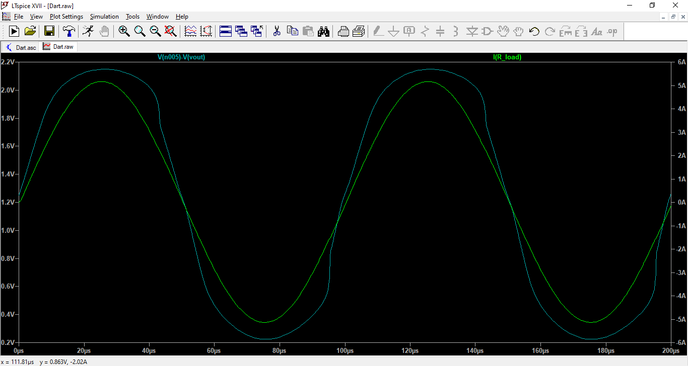

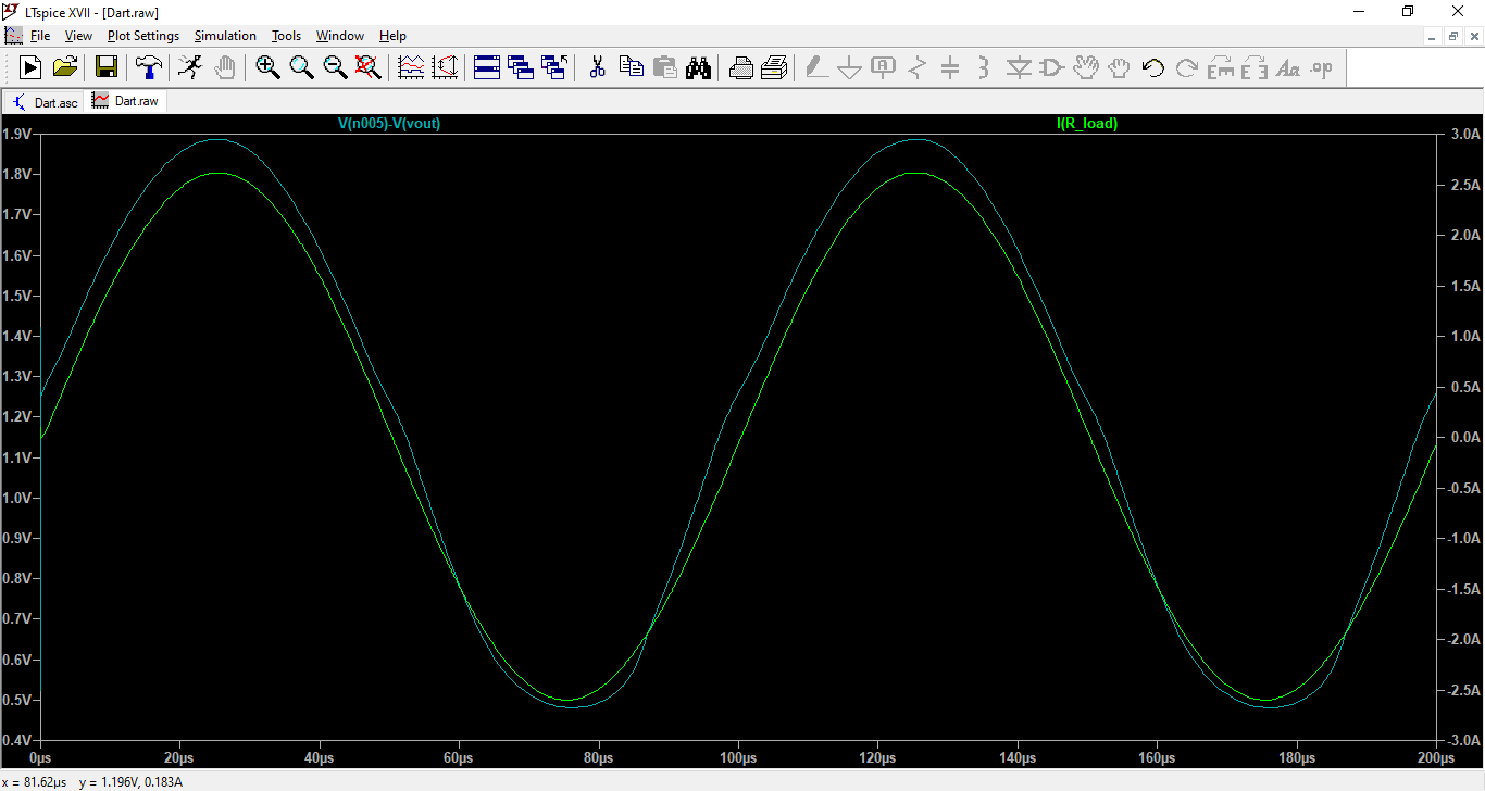

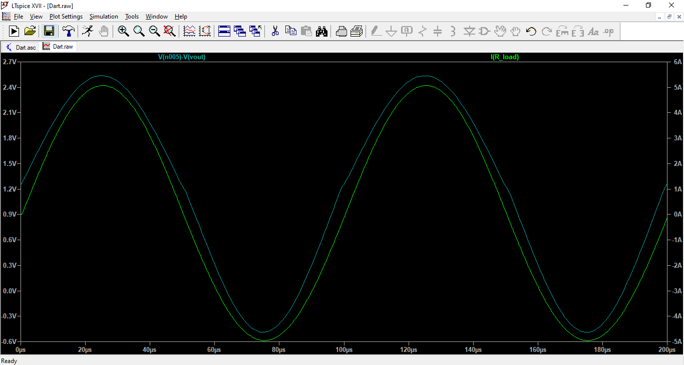

I have done some quick sims of the diode setup in the output stage. As mentioned earlier in the thread the VAS has feedback, so most of the distortion is generated by the output stage. I think the diodes have a major influence on this, so I thought I would just compare VAS voltage with output voltage, assuming VAS voltage is correct, and the diff is the distortion generated.
10kHz 1V input. The current through the load is to the right in the graph, diff voltage between Vas and output to the left
This is a sim of the standard setup with 4004 diodes 4 Ohm load
Comparing it with 8Ohm load:

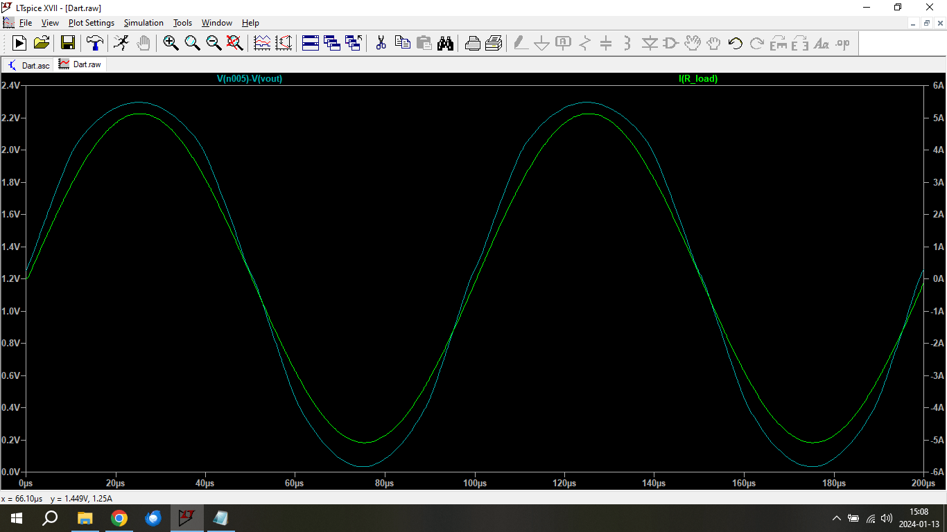

Here is resistors only, no diodes, 4Ohm load:
Here is an example with shottky diodes with resistors in series, 4ohm load
Thoughts on this.. ?
The 4004 diodes seem to be a bit 'sticky' before they 'release' from conduction, surely that could explain bad sound at high levels. 8 Ohm load with lower currents look better No diodes looks nicest. There is some deviation around crossover, I'm guessing due to Gm doubling and mismatch between PNP and NPN characteristics? I tried to balance it a bit with different resistor values on the upper and lower half, and it seems a little bit nicer then.

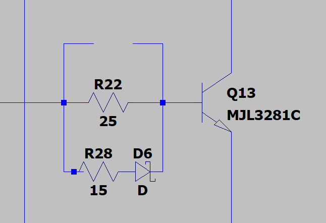

Schottky diodes switch cleaner, but also switch on quite early, so I added the resistors to smooth it out. Possibly two Schottky diodes in series would work similar to the original, but with cleaner switch-off.
I think the 4Ohm test is relevant since reactive loads (speakers) will increase the current significantly even with 8Ohm rated speakers.
After reading through the whole thread, I'm still not sure if I'll build this one or not. I do have a lot of unfinished projects anyway..

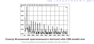

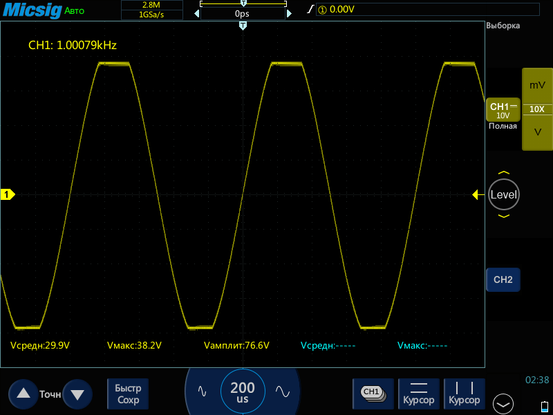

I have already published here the graphs of the Russian guys who made this amplifier. Once again I’m publishing the original and what the guys cloned. I’m not good at this, look and compare experts. If you think that Dartzeel does not have enough high frequencies, then stop trying to make it. I (4 other music lovers) compared Dartzeel and A60 on music, we didn’t feel the difference. Or is the A60 just as bad? The whole paradox is that this scheme has been in development for the second decade, but it is also sold for quite a lot of money and people buy it.
This amp has fascinated me for years, with it's bad objective measurements (distortion), and generally positive subjective listening impressions. After listening to some tube amp with similar distortion, and thinking it sounds ok, -or actually pretty good, I have become less obsessed with distortion numbers.
However, in this thread and others, there seems to be some people complaining about tightness of bass, and also that it sounds harsh at higher levels, so I'm just trying to do some sims to understand why.
I know the output stage without feedback has high output impedance and will probably make the bass sound uncontrolled, and maybe the diodes switching makes it sound harsh at high levels. Maybe schottky diodes would be worth a listen in those cases.

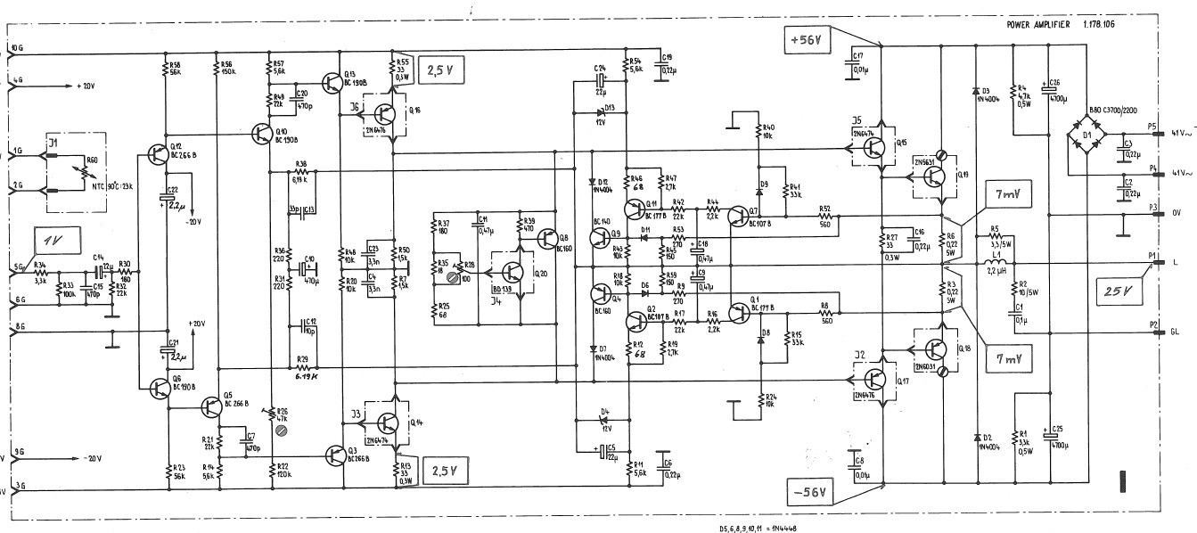

Experts, I am attaching a diagram of the Revox B750. I don’t see the similarity. Dartzeel is not like that.
That s the same amp, the difference is that Revox use a shunt compensation, wich is inexistant in the Dartzeel, as well as a global NFB loop that enclose the output stage while Dartzeel enclose only the VAS with the OS being NFB less, you can also check the B750 MK II wich is slightly modded but is still using the same base schematic as the B750.
