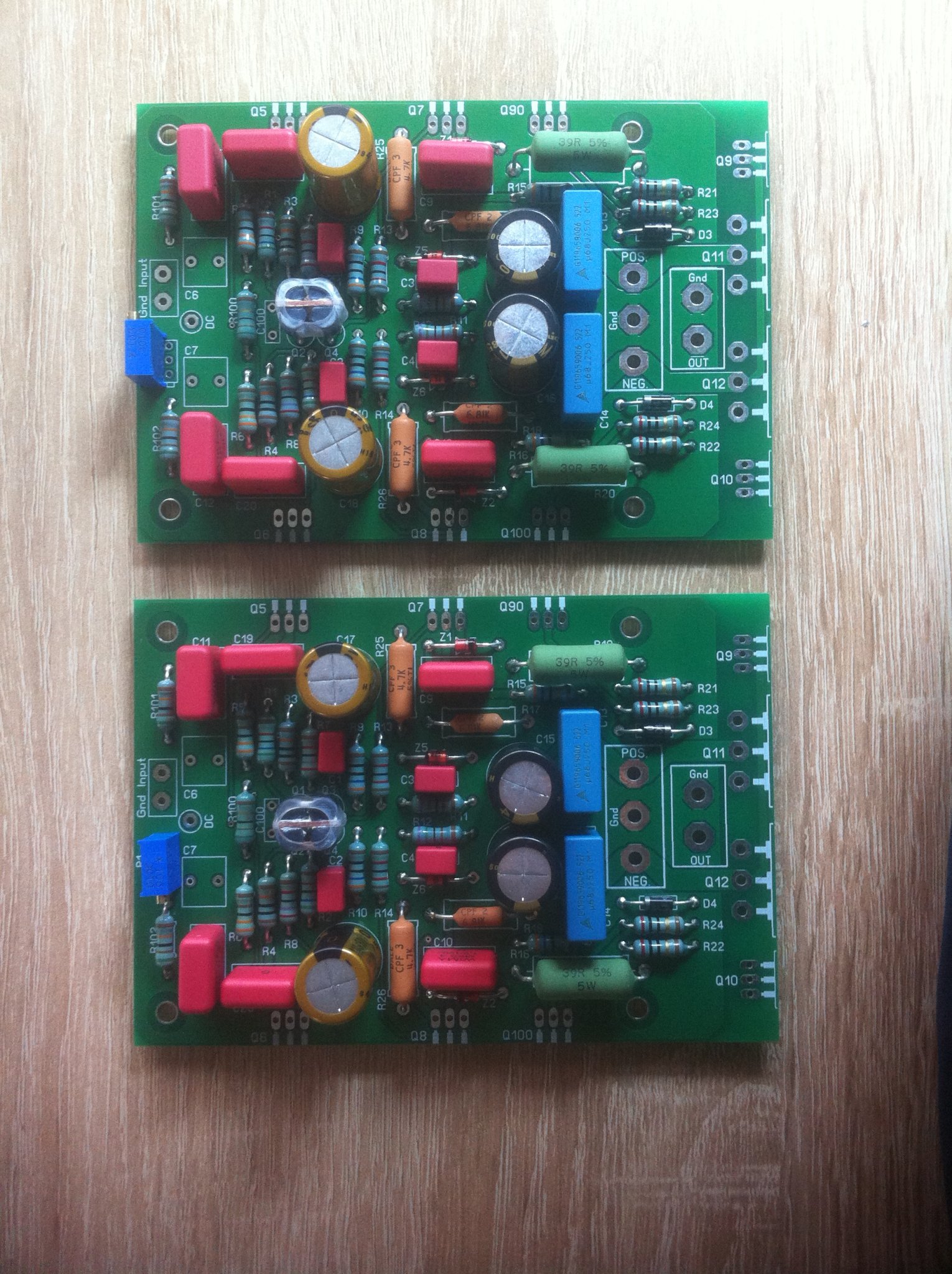

marigno Thank you. My Russian friend gave me the same recommendation. I was embarrassed that when cutting a track, power through a 0.1 ohm resistor will receive not only the output transistor, but also Q10 (according to the diagram). This is fine? Soldering the collector from the board of a powerful transistor is problematic.

However, let's try a different and less invasive approach: short the input and measure the current on a power rail (Itot). Now lift only one end of both the base resistors and only one end of both the diodes paralleled to those resistors; then repeat the measure (Iboard). The final stage drawing will be the difference Itot-Iboard.

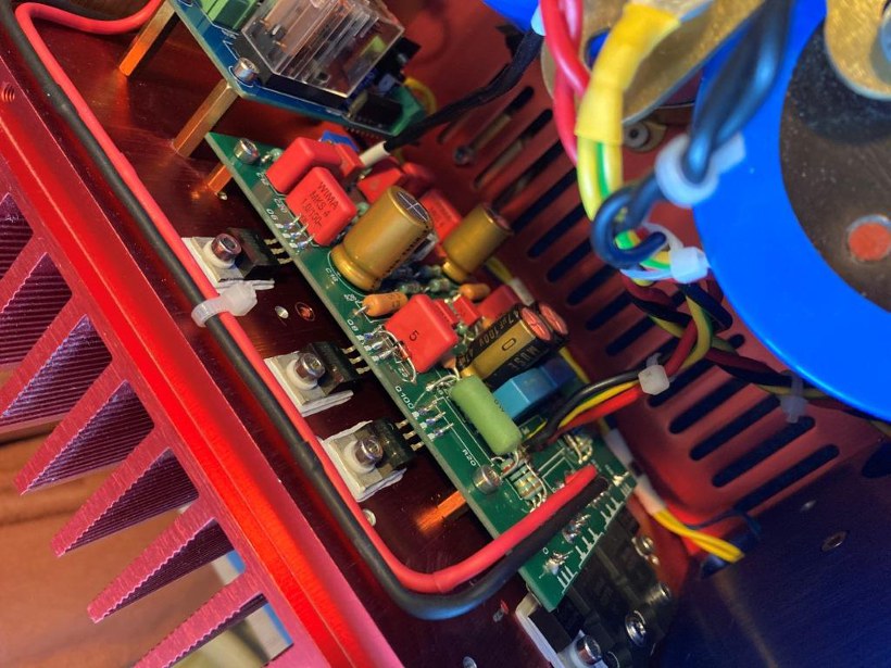

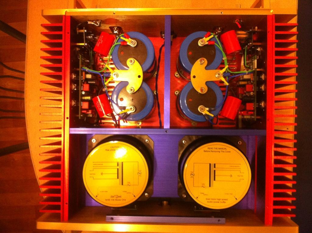

marigno Hello. Small report. I cut the POS track and Q11 (on the printed circuit board), that is, power + to the collector. I soldered a 0.1 ohm resistor there. The voltage drop is 29mV, which means a quiescent current of 290mA. Resistors R23-24 installed by 10 ohms (in parallel 2x20 Takman). I measured the voltage drop again, it became 40mV (400mA). Removed 0.1 ohm and soldered the jumper. I drove the amplifier (the constant voltage at the output after adjustment became more stable 0) for 4 hours, under loud music. As a result: the temperature of the amplifier after the run is not higher than 50 degrees (maximum on transistors). The heating of resistors R19-20 (5W 39 ohm) is a bit confusing, their temperature is 60 degrees. In general, the sound has changed for the better. Lighter and freer or something, the bass approached Accuphace. Satisfied with the result.🙂

marigno Thank you. I stopped on my option and I will not do anything else. The temperature of 50 degrees is normal at the power that I usually listen to music. Previously, it probably didn’t rise above 35 (why it was boring). The original voltage has 56 volts voltage, and the rest current is less (R23-24 resistors by 27 Ohms according to the scheme), but according to reviews on the Internet, the amplifier warms up strongly. My acquaintance wrote that with an increase in the rest current (in my case, when powering 45-46V), you can raise, the distortions are reduced by 20 percent. He made experiments and measurements. Well, the radiators allowed to do this. Thanks again for the help. It is good when they teach and prompted without rudeness and moralizing.

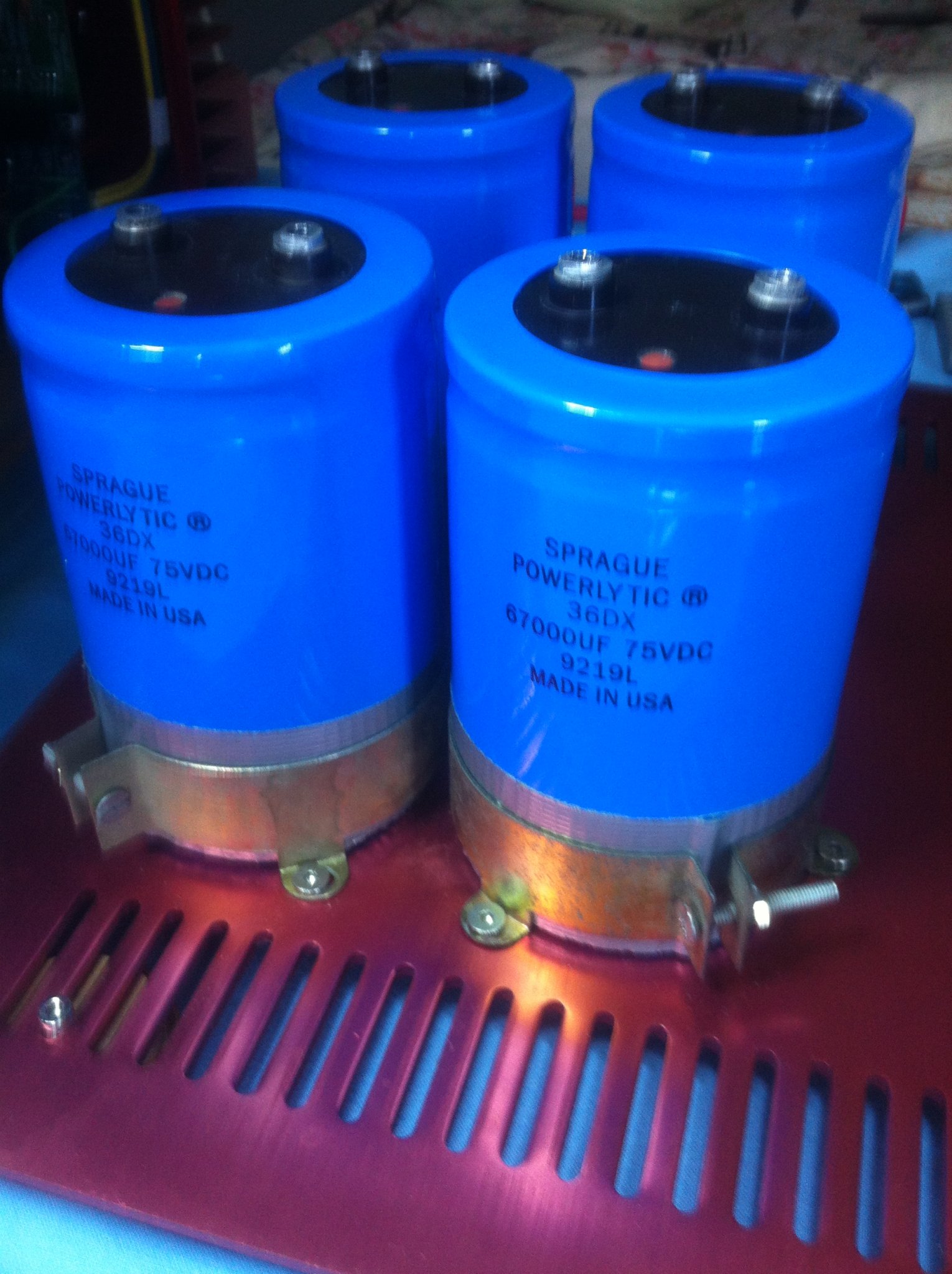

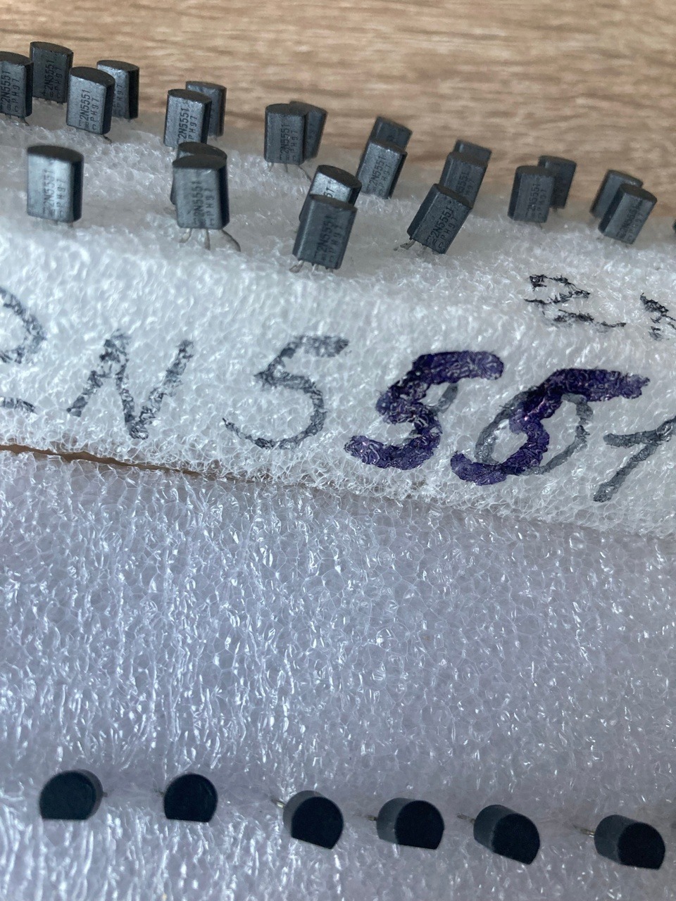

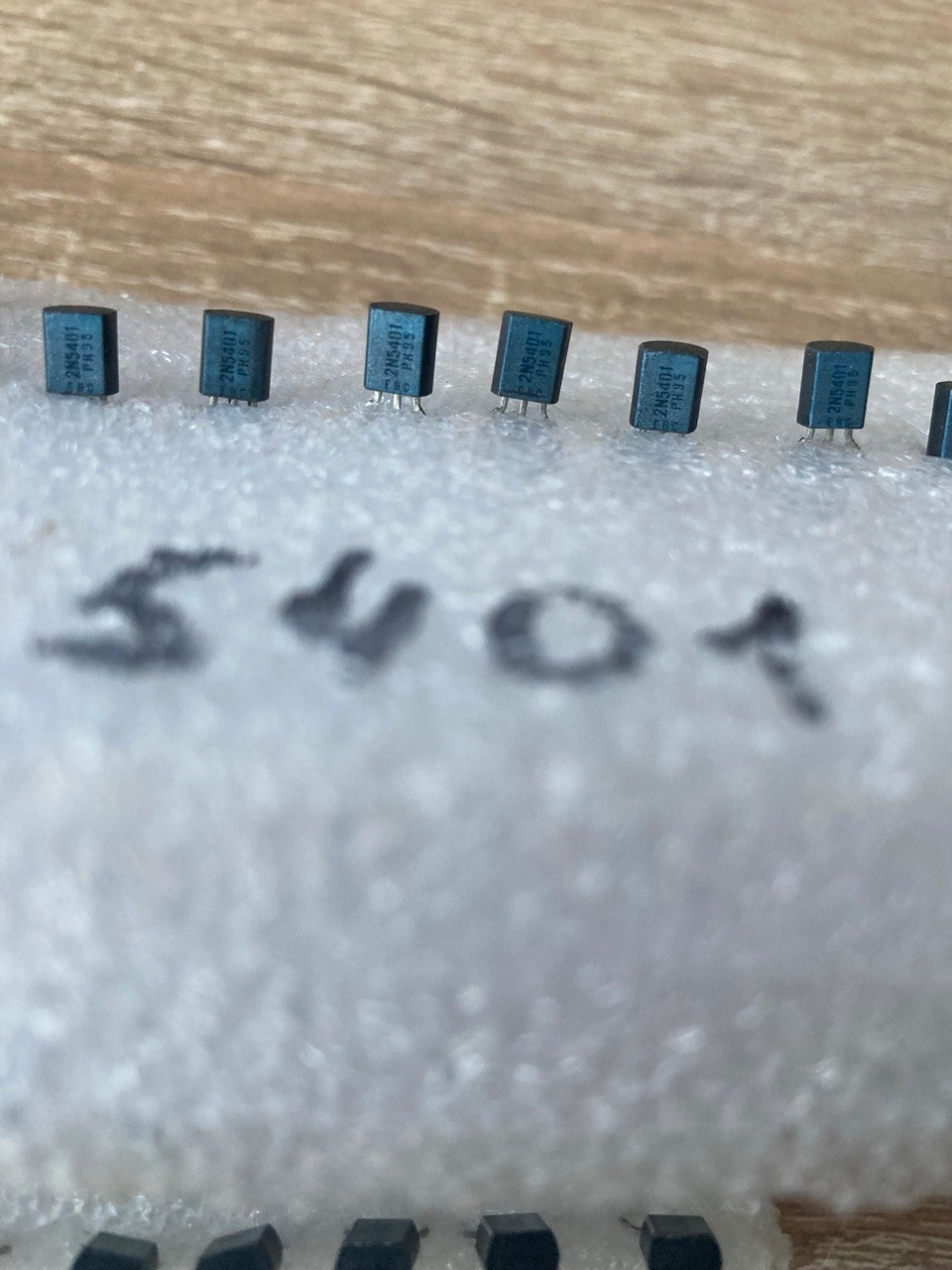

Hi. I used custom boards that are 1:1 to the original. The passive elements are original in accordance with the table that is published here. But the resistors were used by Takman Ray, the capacitors in the Sprague power supply are 67000 μF (in reality 75000) x 4 = 300000 μF. The transistors at the input are Philips, further 15032/33, 4281/4302.I increased the quiescent current by as much as the power supply of the amplifier and radiators allowed. See my messages above.
The ones heat shrinked together?.,,The transistors at the input are Philips......
Do you remember the model?

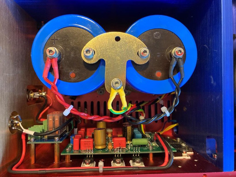

I can purchase a transformer with 750 watts 40v 0 40v but there is only one available.
Would two separate bridge rectifiers fed by one transformer get me a bit closer to real double mono?
Hello. The heat-shrinkable input transistors are the same, only original Philips ones. I think one winding for 2 channels is not good even if it is a 750W transformer. The concept of dual mono is lost. It is better to buy 2 transformers 250-400 W. The power supply is 40 V, already a maximum, after the rectifier 56 V.
