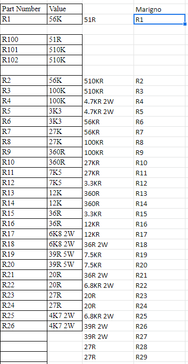

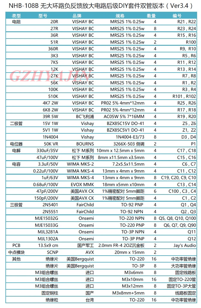

Here is the list of components of the scheme here enclosed.

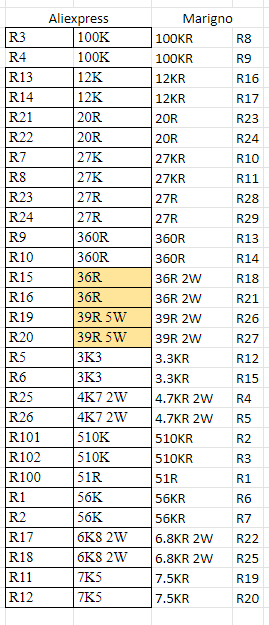

I'm having hard time matching the component list from Aliexpress with your components list @marigno The values match 1:1 but not their names/labels and in a few places the ratings don't match (yellow). Same goes for caps, so my guess that different clones use different component names. What about the ratings mismatch?

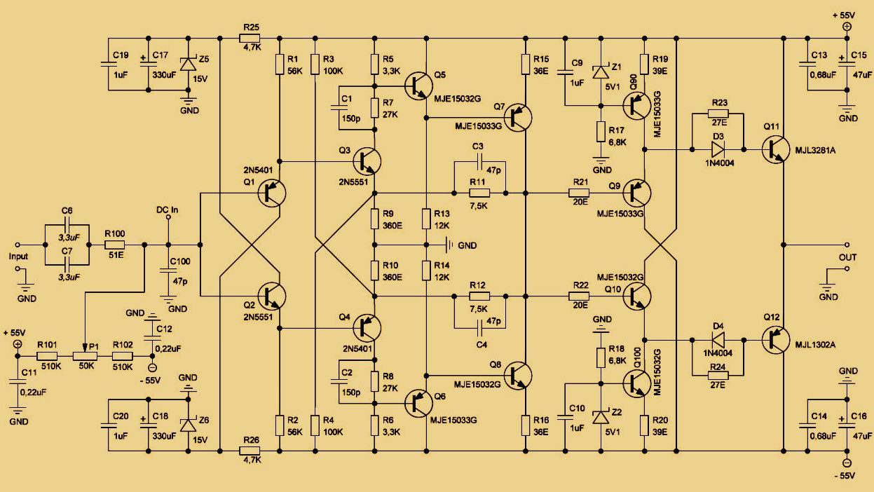

I worked hard on the NHB-108, in order to add a buffer capable of 200W. So I had to re-draw the scheme myself as a starting point for my project. The schema I posted is the original, but the component index is proprietary mine, because I used the renumbering function. I didn't care about the rating of resistors, I calculated it by myself, so, for example, the 39Ohm resistors dissipate 0.6W in heat, then a 2W ones are sufficient. The 36Ohm resistors dissipate 0.23W @+/-70V, something less @+/-50V, so I would choose something stronger than the 0.6W standard for the project, perhaps, at that time I couldn't find a good 1W ones, same to say for the two 4.7KOhm powering the zeners, which dissipate 0.26W, while the two 6.8KOhm dissipate 0.3W. You can verify all ratings by calculating them by yourself, I always do.
@piotrkundu: Because of the considerable difference in hFE between NPN/PNP MJE15032/MJE15033 transistors (lots of fakes on eBay), I strongly recommend you choose something better, you don't need such powerful devices. I used the pair 2SC4883A/2SA1859A, but they are obsolete and impossible to find. The pair 2SC4382/2SA1668 Y selection is the closest solution, check them on B+D Enterprises, which sells on eBay too as "bdentric" or a similar seller name, a reliable seller). Q5/Q6 could be 2N5551/2N5401, I used the pair TO126 TTA004B/TTC004B, they don't need to be mounted on the heat sink. In quiescent condition, the branch Q7/Q8 dissipates 8W, to say 4W/device, while the branches Q9/Q11 and Q10/Q12 dissipate 12W each, to say 6W/device. Keep it in mind when choosing new devices (check their SOA). C10/11/12/13 MUST be silver mica ones, check them on eBay. A very good solution for the final pair Q14/Q14 could be the 2SA2223A/2SC6145A multi-emitter pair, Y selection; you find on B+D Enterprises.

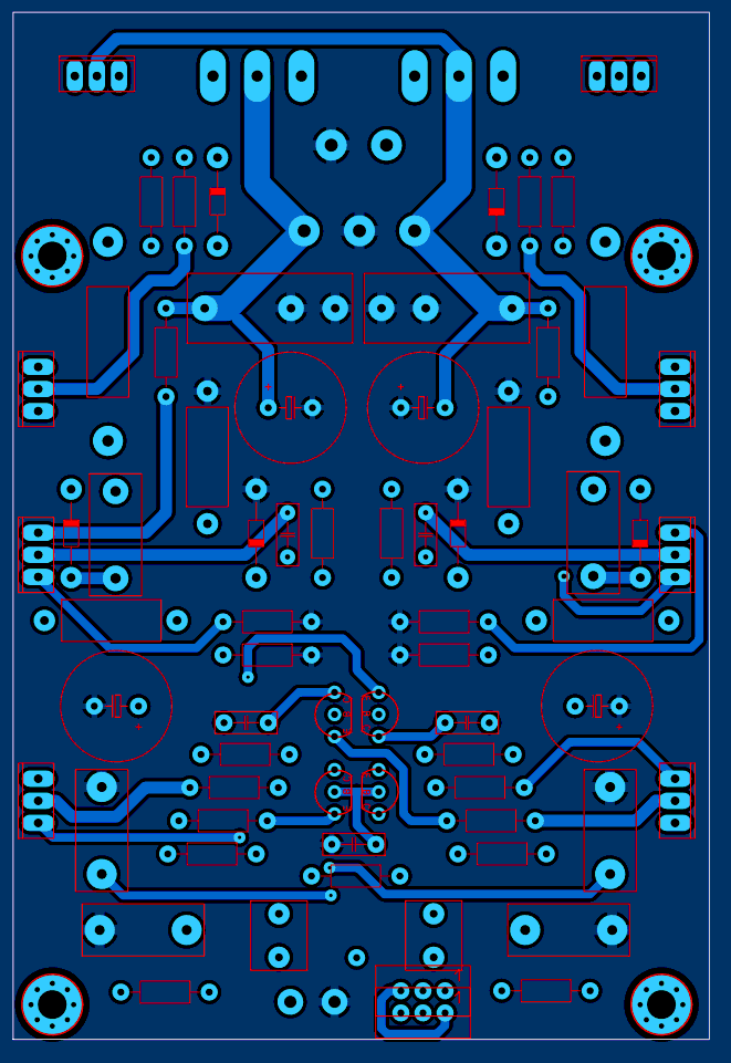

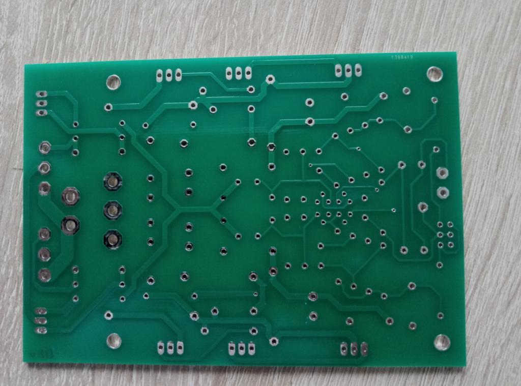

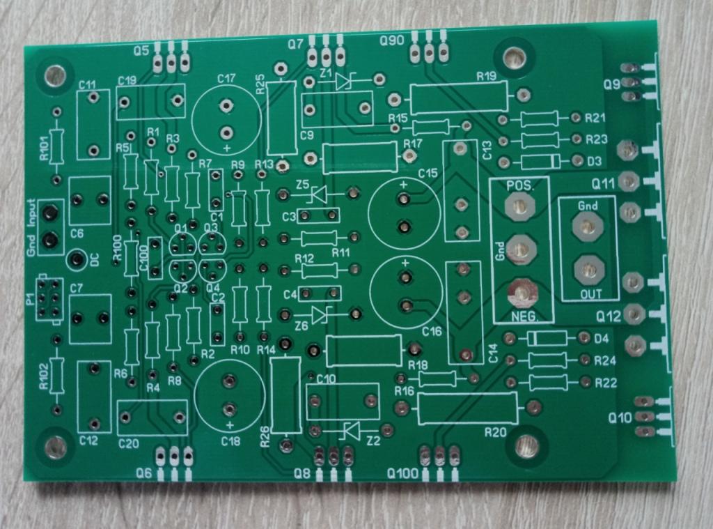

Hello,
I red a lot of the normal NHB-108 clone (China) and I think its worth to try and build one. In the moment I draw the layout for the PCB to make it possible to change or add parts if necessary and make an own PCB.
Now I read about this mod and due to the above it maybe possible to change some parts on the PCB.
So, @marigno, if you or even someone else has ideas for this - please tell me - I'll do what I am able to......

I forgot about PCB: I do not have any suggestions for the original NHB-108 scheme. If you want to proceed with the WHA-217, there are a few mods that you can make directly to the original PCB, and you need a small added board (take a look at my post about the WHA-217 E2). A new PCB with a single-point current feedback would be the best solution.

On the other hand, I would like to revive my old idea of a paragon follower working in NSCB, made on the 108's base, modified to WHA-217. Just some minutes ago I ordered a couple of 108's PCBs. Will see. This will be interesting for @overheater who, despite his nick, has a cold!
@Paroxod4: Yes, you are right. You want to measure how much current the final stage is drawing. So you have to disconnect one collector and insert a 0.1Ohm resistor. You cannot use a power rail, as you say in the next post, because you would measure the total drawing of the whole board, wich is not negligible at all, more or less 320mA without the final stage.​
