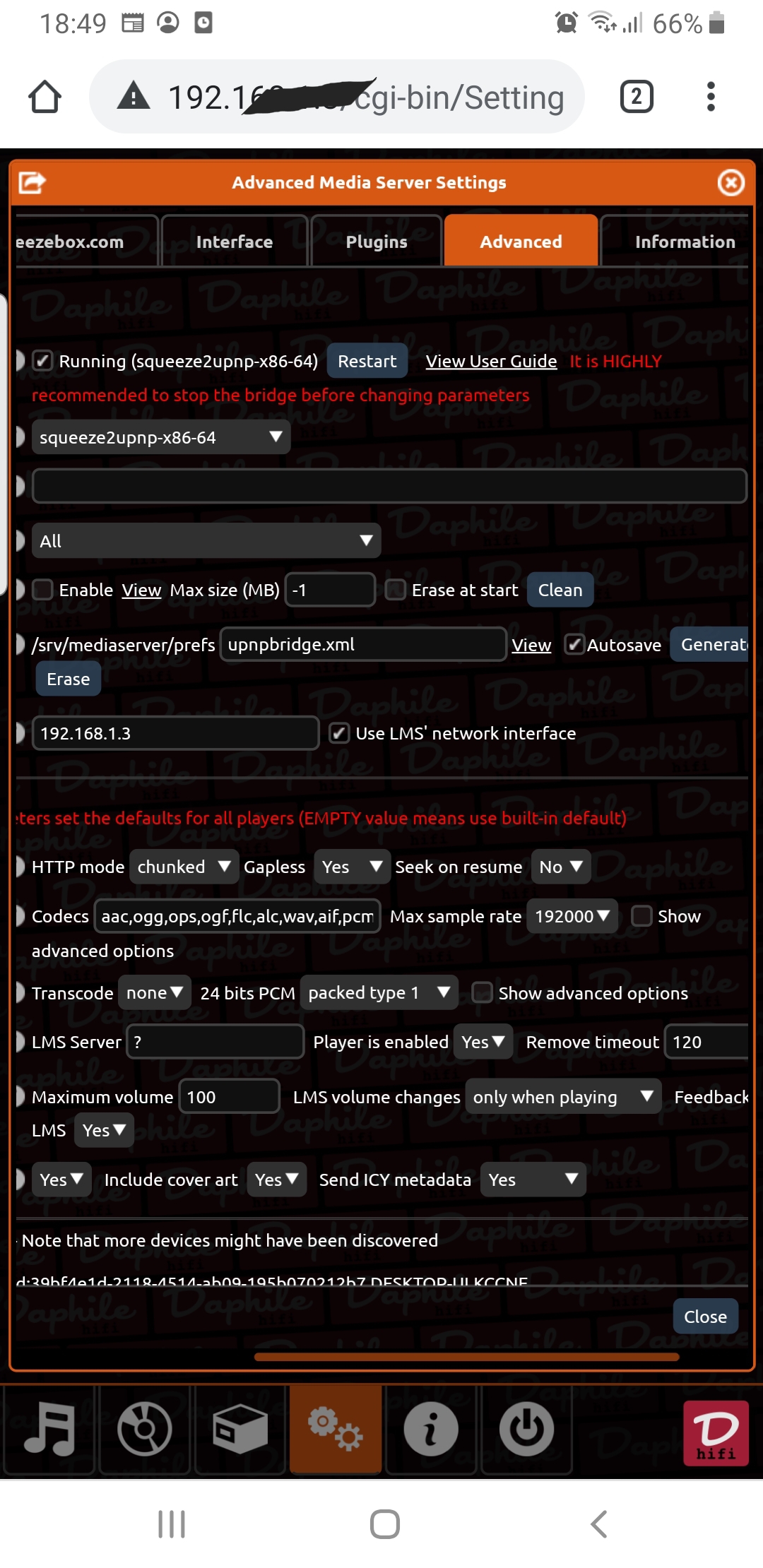

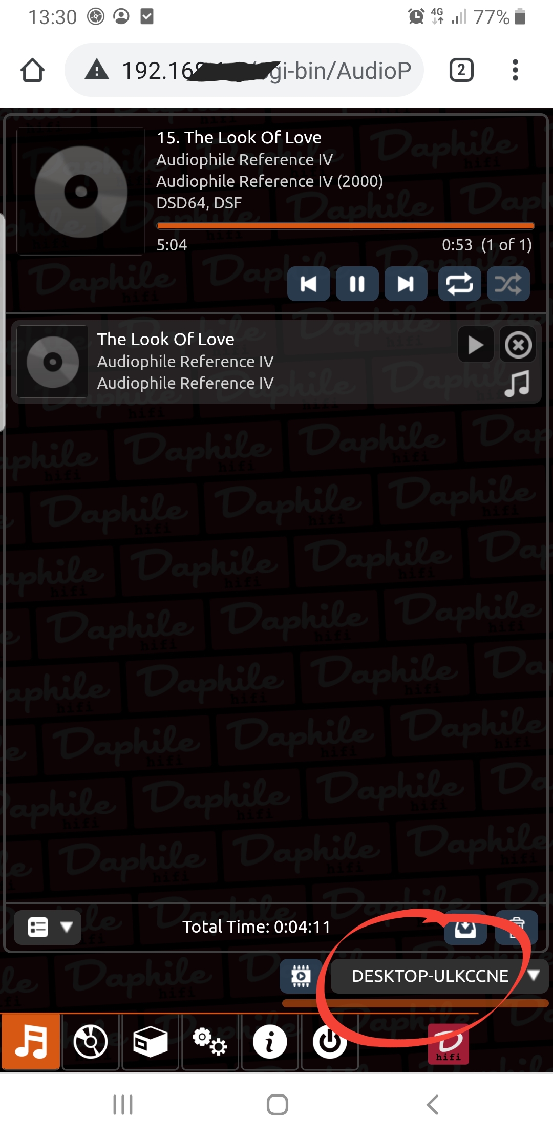

@DRONE7:
No debugging info.
Daphile (rt latest version) on Laptop and Jriver27 (shared key) on fanless Nuc.
At first, Daphile's output to Jriver well, then (15-20 minutes) no sound, while Daphile still displays Jriver as Player, I can change song from Daphile then song's name in Jriver changed respectively, but no sound (and seems no playing on Jriver). Daphile keeps working normally. Without UPnP Daphile, Jriver does well too.
Thank you so much.
p/s: ... command line output ?? No

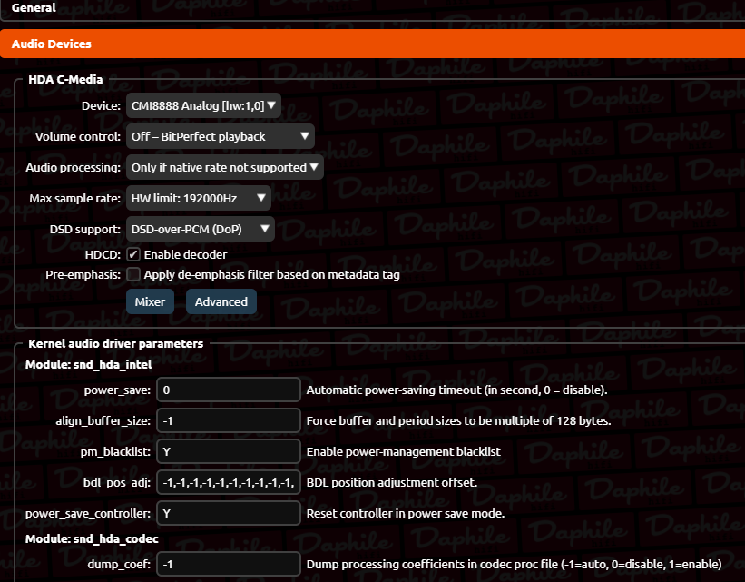

My system is a NUC, Pentium, 8Gb RAM, Pink Faun HEA I2S bridge to a Metrum DAC, using RJ45 ethernet cable for I2S. Ethernet cable tested and working.
Daphile running latest beta version, it runs, detects the correct audio device yet no data flow to the DAC and therefore no sound. My DAC works, I just disconnected the other I2S feed but seem unable to get this one working.
The I2S bridge is connected via the M.2 slot, and is detected by Daphile, tracks are playing.
Anyone who knows more about this setup, is there a mute button/toggle somewhere?
Mixer settings:
all ticked on, using just front, all switched off, makes no difference.
Anyone here with a hint?
FYI. Many thanks

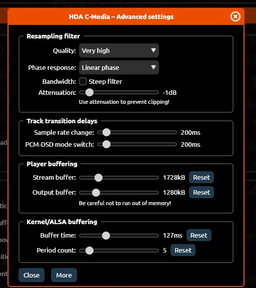

HI there,
Thanks for your support!
The device is selected and showing in the lower right corner, in my experience so far if the device does not work or is not installed tracks do not play.
I just checked, everything is working perfectly with my previous setup; NUC connected via USB to singxer SU1 connected via HDMI to a LVDS to RJ45 convertor into the Metrum RJ45.
triplechecked the ethernet cables and those are fine too.
See attached screenshots of my settings
