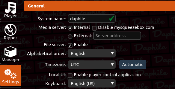

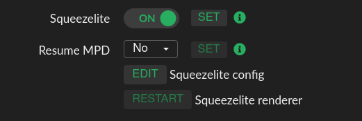

I have the Allo USBridge Sig (not the signature player)
USBridge Sig - Ultra low noise RPI
That is a full-blown streamer OS + RPi, like daphile + x86 PC.
Configure Daphile as the LMS File Server and MoOde on the USBridge Sig as the squeezelite player.I have what I hope is an easy question that I have not been able to find the answer too.
I really appreciate you taking the time to add some screen shots as well as answering.
I'll give it a try in a few days once I get done putting my amp together, and can move on to the next part of the journey...
-Josh
