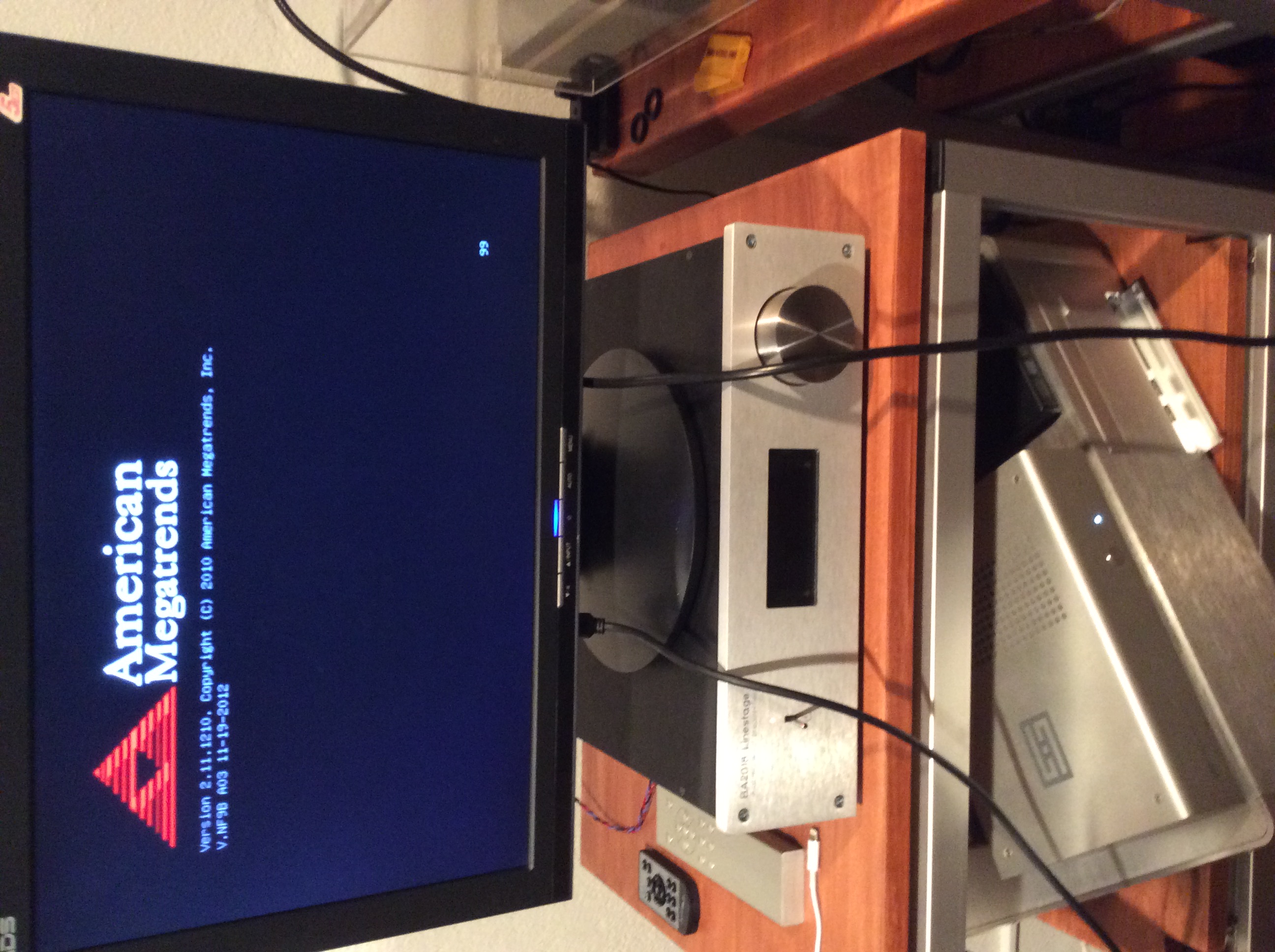

I suspect my server's motherboard is fried, but would appreciate your opinion. The motherboard is an ASRock N3050B-ITX, which has been in service for about 4.5 years and has worked fine during that period. RAM is 4 Gb. The Ethernet connection at the server is via a powerline extender. The server is plugged into a Furman AC-215 surge protector (but not the powerline extender). A month or so ago, I went away for a long weekend and shut the server down. Upon my return home the server refused to boot up -- it would hang at the first screen (see photo). I installed a new thumb drive (on which Daphile is loaded) but did nothing more, and a couple of days (and many attempts) later it booted successfully. I assume the original thumb drive was not the problem, since the server would hang before loading Daphile. A few days ago we had a power surge and around that time the server again went offline; the result is the same as before (again, refer to the photo). I don't know if the surge is relevant, but them's the facts.
So is it likely my motherboard (or RAM) is toast? Is there another plausible explanation?
If the motherboard needs replacing, any suggestions? The standoffs in my server case (which I'd like to continue using) are arranged for ITX motherboards. I could always drill new holes and install standoffs, but given a choice would choose not to.
Thanks in advance for the feedback.
Scott

4.5 years is a long time for that poor little Bios Battery...
Before all else spend a dollar and replace it with a new one..😉
If you can boot into the bios screen currently then make a note of the settings on each tab as a quick reference if you need to reapply them after battery replacement.

...as the man says @Drone7...
If you don't have any TEST Standalone media (CD-ROM or USB flash memory stick) you can create a USB 'test' environment standalone tool by building a LIVE USB bootable disk... I'm just giving you a suggestion here out of many: Linux Mint Installation Guide — Linux Mint Installation Guide documentation
You can run Mint from the stick and/or you can install it on your 'server' machine (this way you'll find out whether the HDD might need replacement)... Draw your own conclusion.
