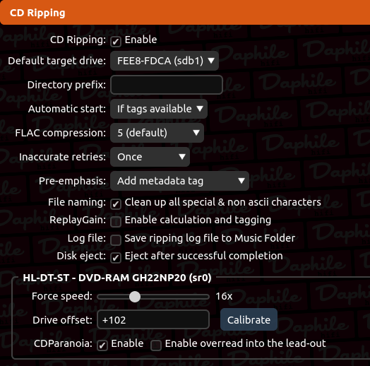

Hi All;
Just built a small test PC with the following specs;
ASRock J4105
2 X WD Blue 1TB SSD
1 Pioneer BDR-209DBK
8G of Crucial Laptop RAM
Daphile works fine but even with multiple calibrations etc. for the BD-ROM (offset is +667 as all of this model seem to be) I cannot accurately rip a CD to completion. The last few tracks are always inaccurate and the last track doesn't rip at all. This is across multiple CDs.
I have also tried a somewhat older LG DVD ROM (GH24NSCD) but Daphile doesn't even see it.
Matt
Any ideas? What optical drives are others using?
I use an external LG drive via USB.
Screenshot attached...
I am assuming you have tried with the 'Enable over-read into leadout option'?
