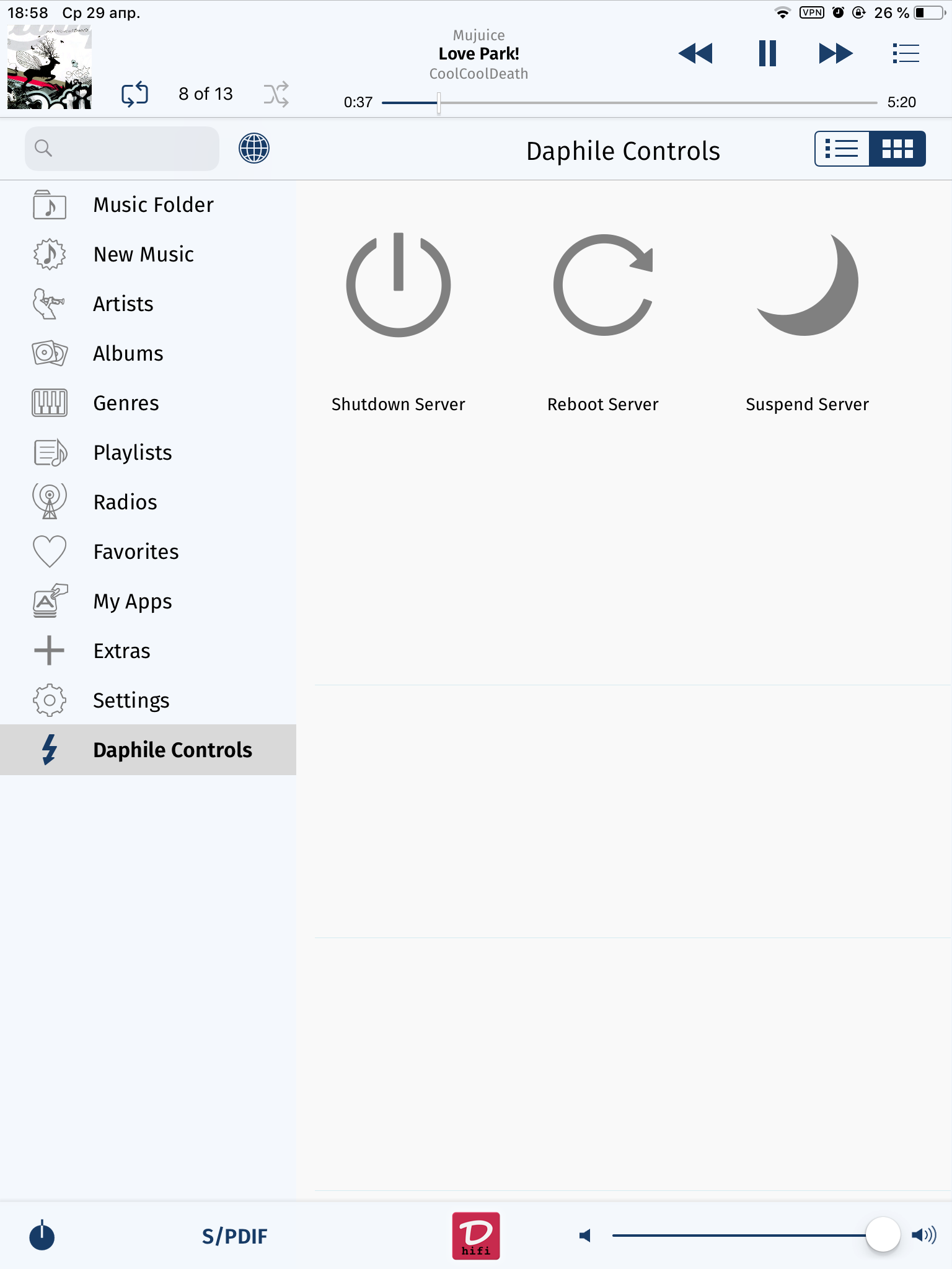

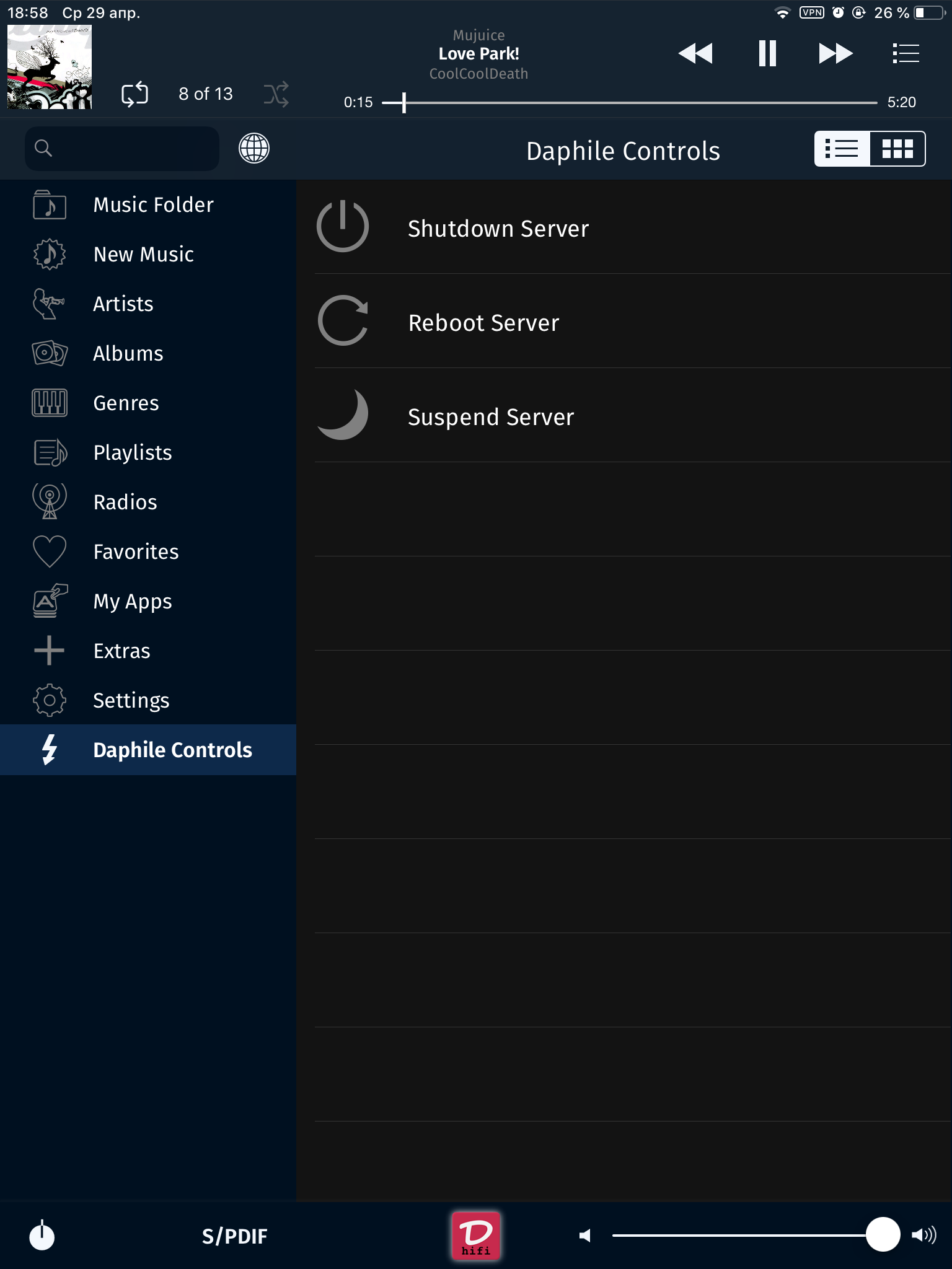

Hey, I wrote a small plugin for Daphile server to control the power state (shutdown, reboot and suspend) with any controller on device (I persenally use iPeng). Maybe it will be useful for someone else except me. I placed plugin in Extras menu by default.
Link to my repo (You shoud add this in the end of page with plugins on server): https://dl.dropboxusercontent.com/s/dfprmucpwg1dlpy/pluginrepo.xml

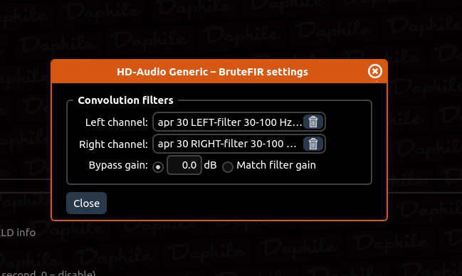

Hi guys
First time Daphile user and I really like it! Hope you can help with this: I’m trying to upload two filters I created using REW to tame a 55hz peak, then once I upload the two filters as wav 16 bit mono each (left and right channel) to the brutefir plugin and it’s ok when I close the window and then check back the filter files are still there, then I save and restart Daphile but then upon looking for the filters they have disappeared from the brutefir plugin, there must be something wrong or I make some sort of mistake, please note I upload the filters from my tablet fole manager, please please, can you help?

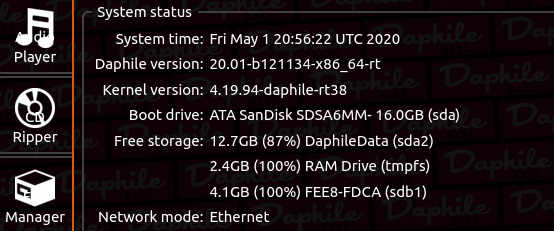

@Stefanel631805
Thanks for sending the files. They install and are still present after a reboot. 🙂
Attached image is after restart.
Thanks for taking the time to help me
So this seems very strange, I’m running the latest RT version from a usb stick, maybe that’s the reason?
which version are you using and did you install it on the internal hd?
Also very curious to know why I can’t even tick the convolution tiny box in the eq box and what us that tiny icon left of the eq icon at the bottom right of the screen
@Stefanel631805
Is your Daphile installed to the usb stick or just the download written to the stick ?
If the latter then every boot is fresh and changes are not kept. To install to usb you have to add another usb stick and run the install from the first using the second as the target.
You might want to read the daphile install documents
https://daphile.com/download/DaphileInstallation.pdf
Yes, I have Daphile installed to the internal media on my HP thinclient (it has 16GB flash)
The latter...so that explains the issue
I’ll do a final installation on another usb stick
