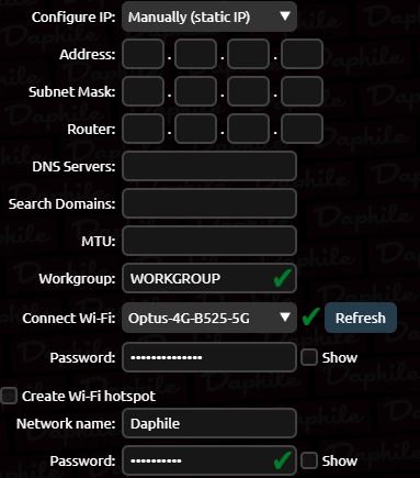

I am not very familiar with setting to the static address, can you tell me which info I need to add to the attachment.
my daphile IP address: 192.168.8.120
what subnet mask no?
router is this router IP address?
What is DNS server?
what is Search Domain?
what is MTU?
CPU power setting
Set Clk to Maximun
what else?

Are you aware of an app called Fing? It is available for Android and crApple iPhone, and is a network sniffer. It is free so download and check your network IP addresses.
In order;
192.168.8.120 (Did you use Fing to get this? The '8' is unusual but acceptable.)
255.255.255.0 (Normal subnet mask.)
192.168.8.1 (Check this with Fing.)
This is the internet provider DNS server address but you can use 8.8.8.8, the Google DNS server.
Don't worry about the 'Search Domains' or 'MTU' so leave them blank.
That should do it for the static IP address.

Thks it worked BTW what's the advantage of static IP address faster to address Daphile s/w?
also what about what parameters to change, eg set the speed to max on the CPU.
