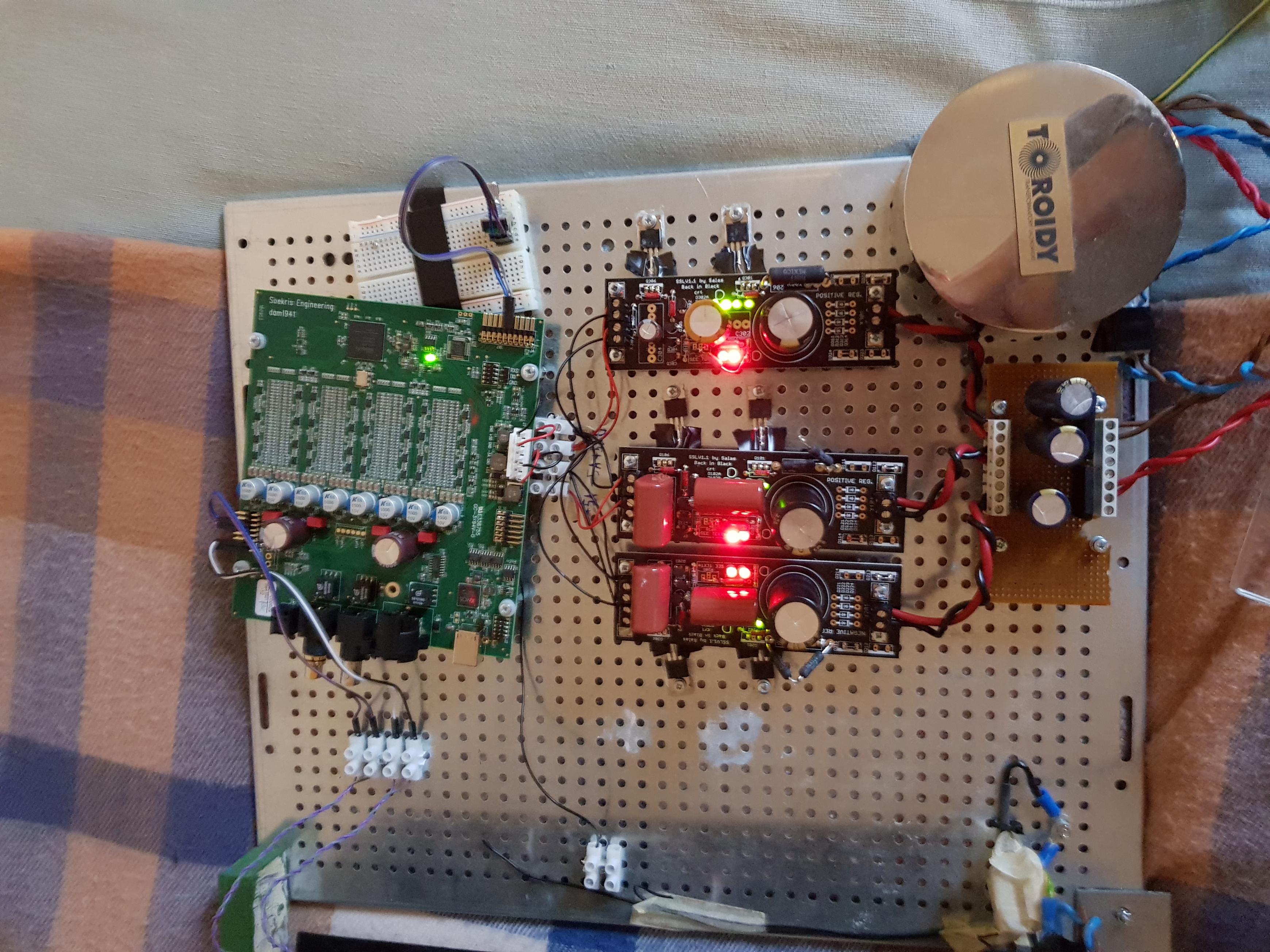

In analog section (+/-5V) 5.6R resistors allow for 100mA current and in the digital section 1.5R for 370mA.
The build guide for that supply states that you would need to take Peak Current Consumption plus 50-150mA for Shunt Current..
If I take a look at the DAM1941 specs:
- digital section = 350mA (DAM1941) + 150mA (display board)
- analog section, both rails (+ and -) have 85 mA max consumption.
You are not running into problems with your 100mA and 370mA configuration? It does not provide the advised amount of shunt current on top of the DAM1941's peak consumption...?
You are correct, I missed the info about shunt current. That would explain why the second device in PS is not warming at all after PS is hooked up to the circuit, mostly in a digital section though. Analog section seem to be pretty well balanced.
I will need to increase heatsinking in the digital supply and then adjust the resistor.
Other than that, the PS keeps the voltage at proper levels and seems to runs fine.
