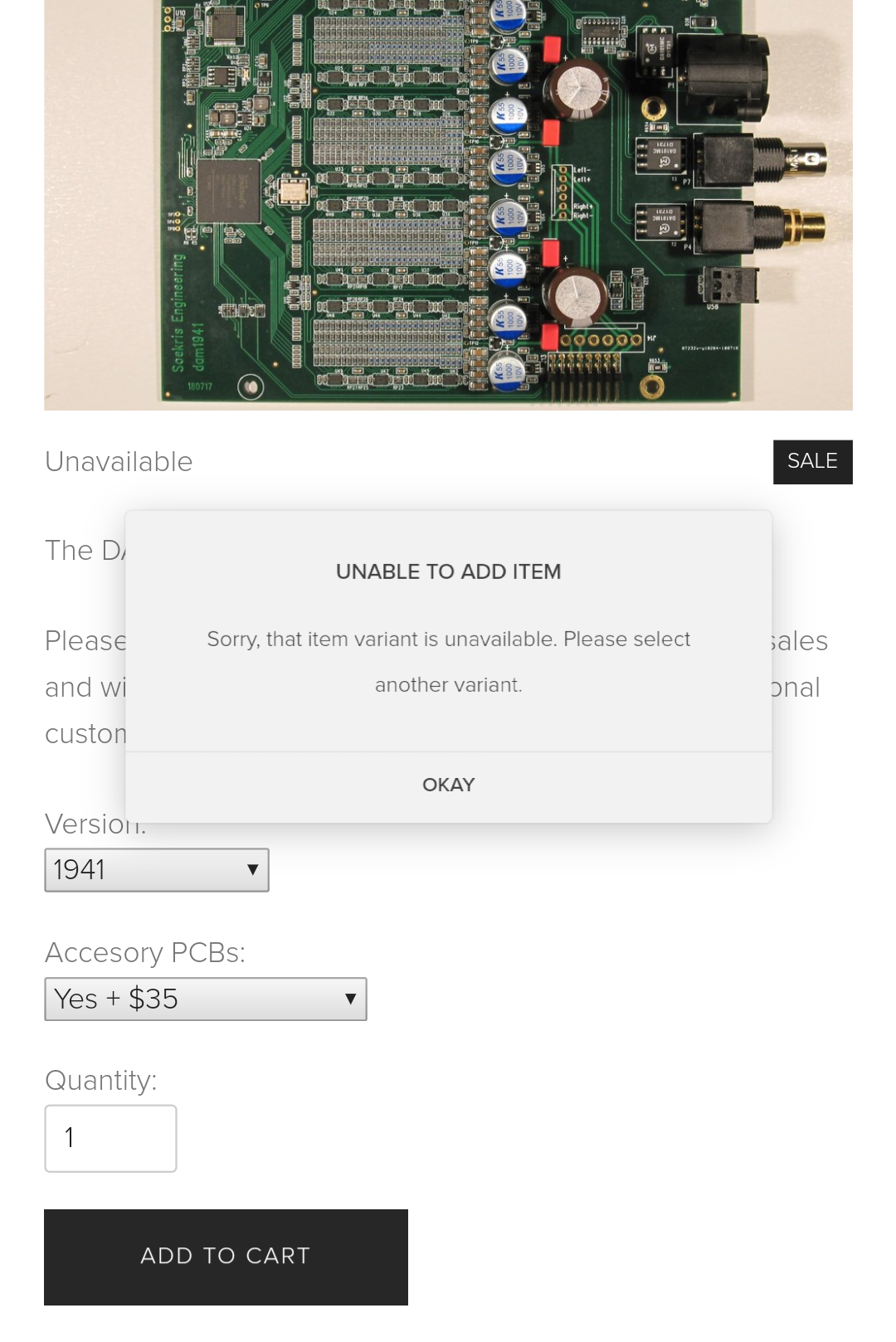

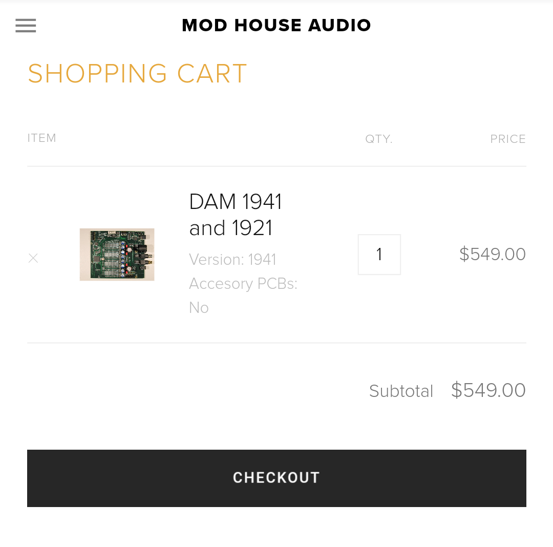

Interested in purchasing a DAM1941 for Cyber Monday, but none of the accessory boards are available at Mod House Audio. Is that an error? Will they be available at a later date?
Seems to be up now ?
The DAM1941 is available if "No" is selected for "Accessory PCBs". Price is $549 and I'm able to add it to my cart.
But if "Yes + $35" is selected for "Accessory PCBs" then the DAM1941 is shown as unavailable.
See attached screenshots.
