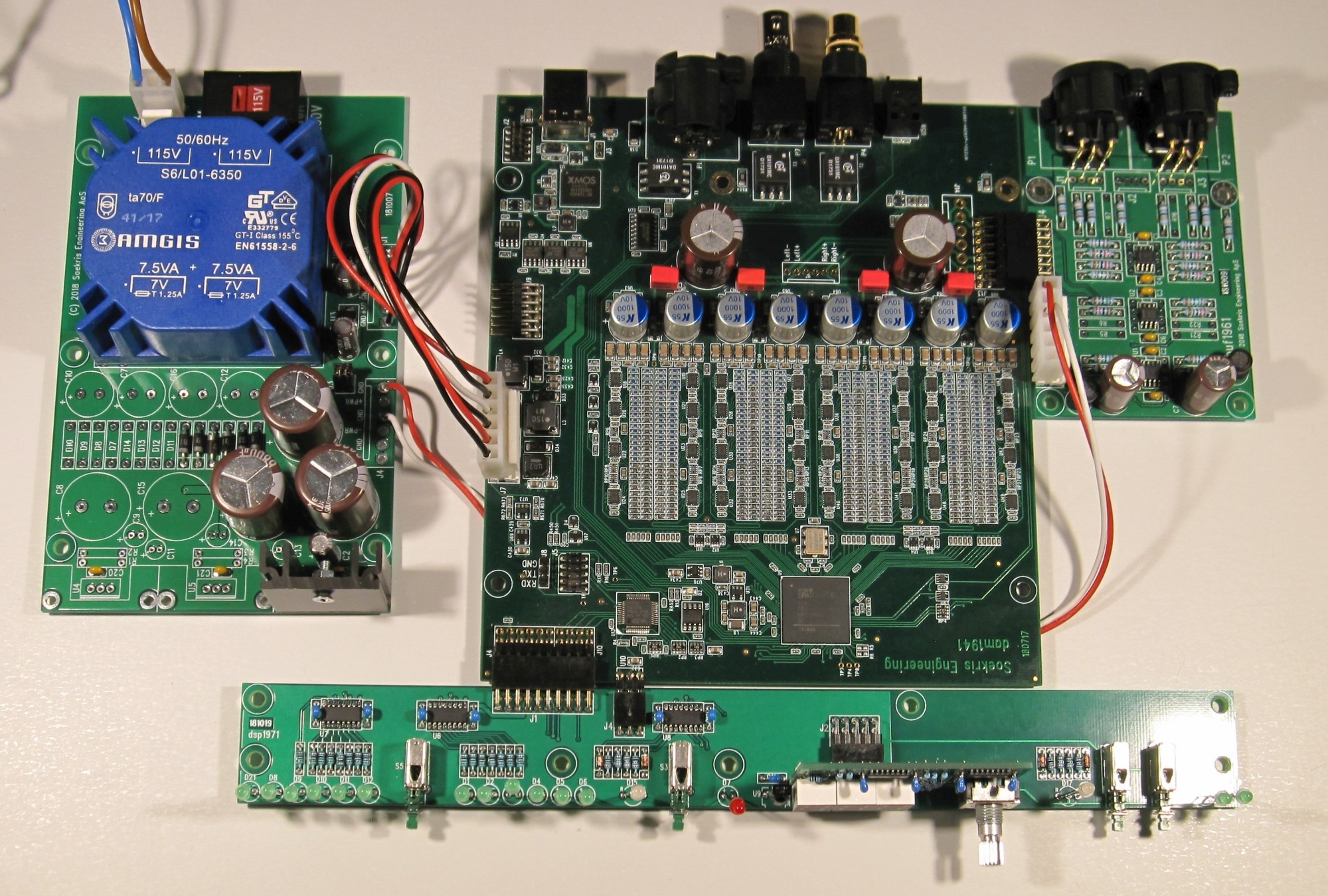

Here is a nice picture of a dam1941 system, with the accessory PCBs mounted.
The Power Supply PCB is only partial mounted, there is room for additional voltage doubled +- supplies for a more demanding Output Buffer.
The basic Output Buffer showed here is using R-R OUT opa1678 opamps, they do fine with just the basic +- 5V, but there are space for DIP sockets for the opamps....
Notice the 3 7-segment LEDs and the encoder for volume, the black part just next is the IR receiver. The User Interface board is designed for a 5mm front plate, but are pretty flexible as except for a few so16 parts it's all leaded parts.
