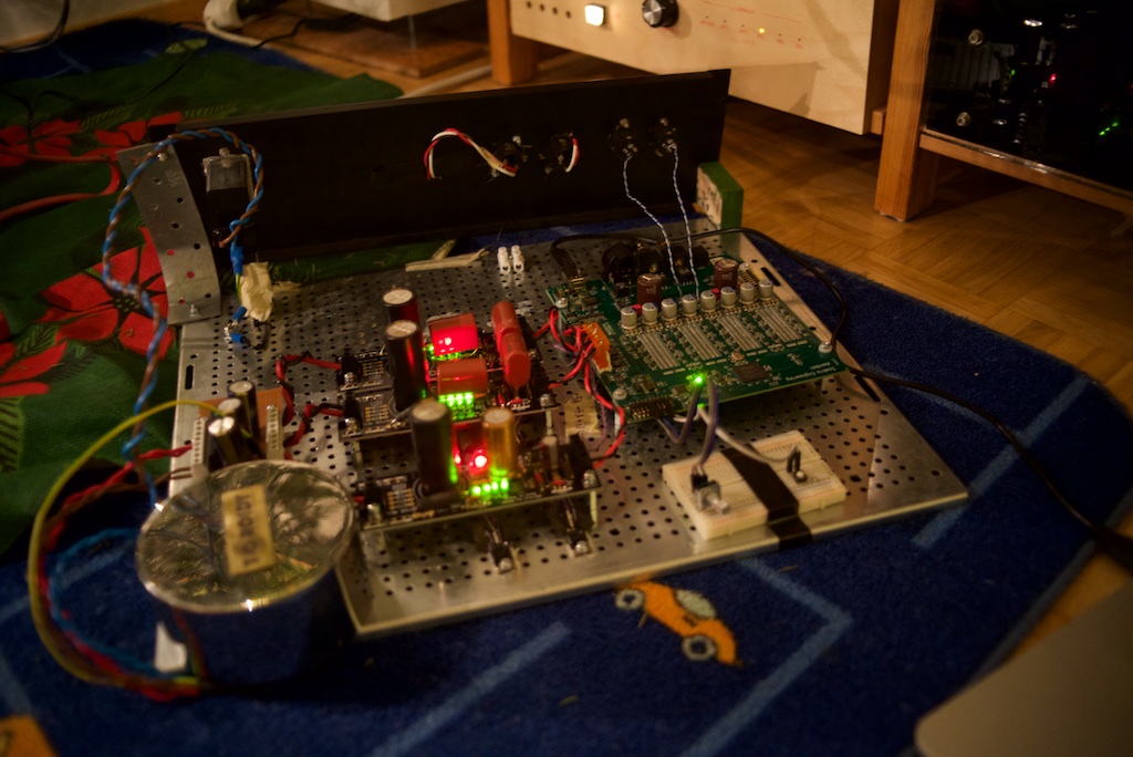

Fixed up my prototype=) This sound really good - my best dac so far (competition is a dacmagic, buffalo 3se with resistor+trafo iv and opus).
IMHO a very good and easy to set up dac for the price, excited to test some output stages!
THANKS Soekris!

very cool torb, did you use boot it up and plug music in?

Yup, plug and play=)
Cheers mate
