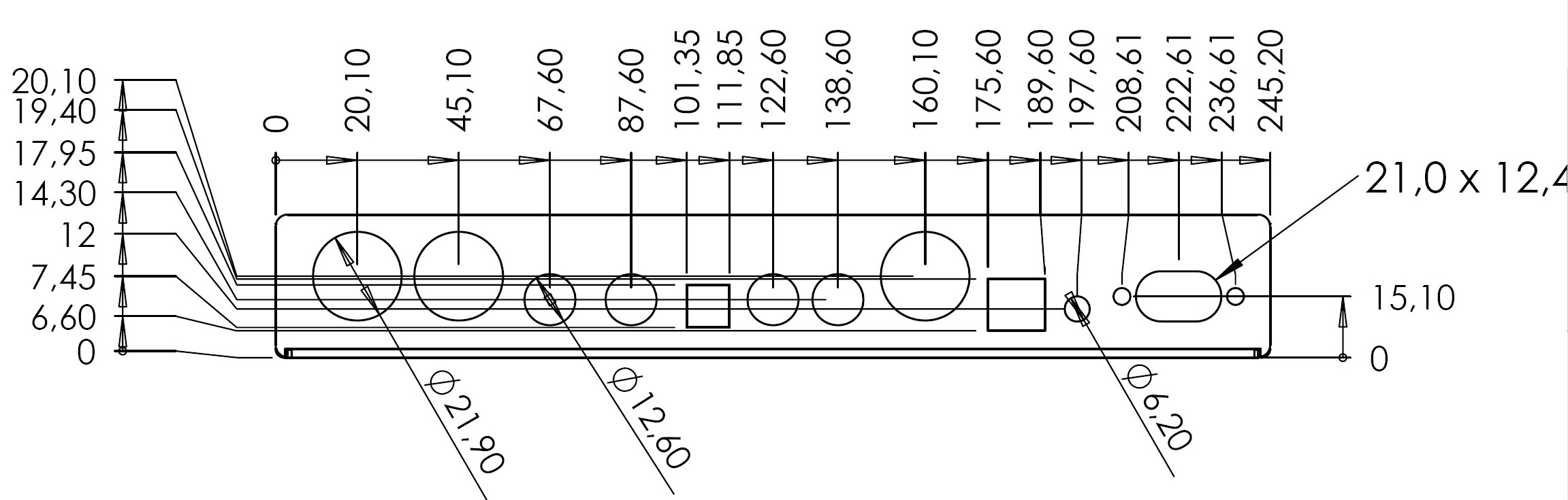

Do you have manufacturer part numbers for the rear panel connectors? I see the center-line dimensions on the component locator PDF but I'd really like some datasheets with recommended panel cut-out dimensions. My calibrated eyeballs are not what they used to be!
Thanks!

I'm still wondering if you can hook us up with some connector part numbers, specifically for those on the rear of the DAC module. Pretty please? I'd like to get a nice machined rear panel from Front Panel Express and I'd like to nail the panel cutouts on the first rev.
BTW, like Norman Tracy, I'm also a professional EE and I lay out PCBs for a living (optics industry). Your DAC module looks fantastic. Well partitioned and very well laid out. It's a joy to look at.
