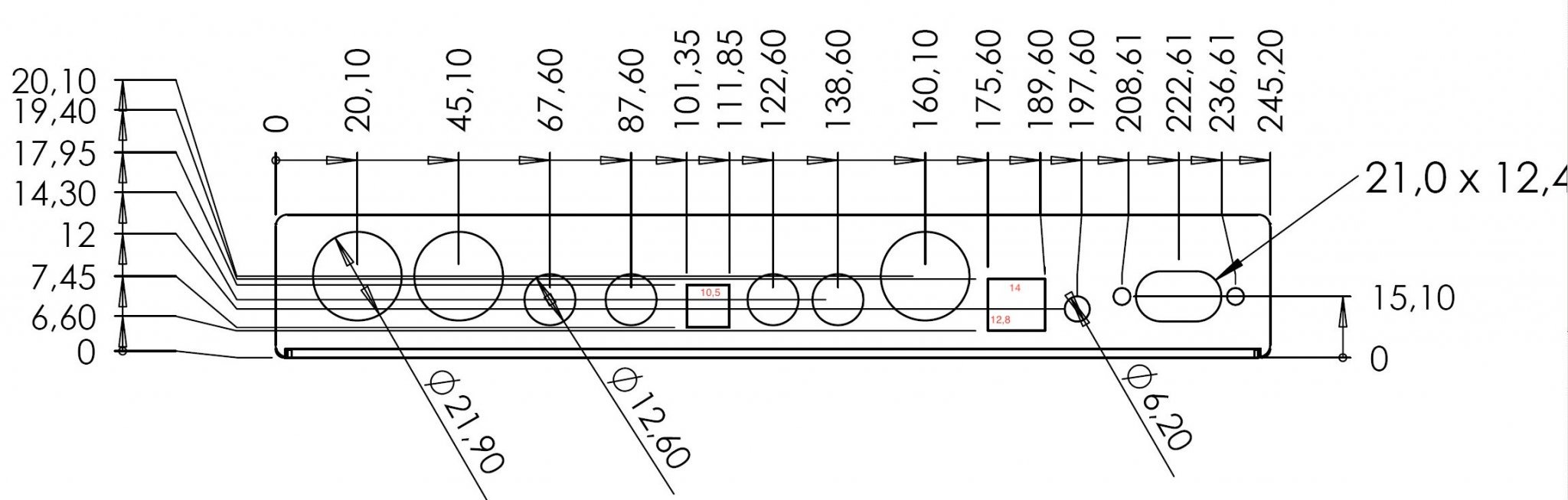

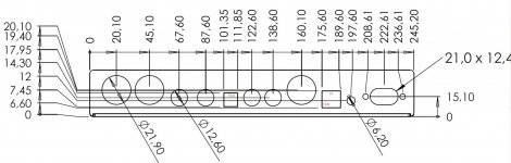

Just finished building the Power, Buffer, and Display boards and assembling the dam1941 system. Everything is working fine and sounds great. I won't be using the head phone feature. Am I correct in assuming that it is safe to cut-off the display board at a point beyond the mounting hole at 6.695"?
I'm ordering front and rear panel face plates for the assembled DAC. I'd appreciate part numbers for the TOS and USB2 jacks so I can get accurate size & cut-out specs. The RCA and BNC information was provided preciously.
Some time ago Soren posted the the bagplate of the Soekris dac1541 which as the same cut out size. I've attach the Autocad dwg with those info. I haven't made a case yet, they should be correct but in case double check them.
  • slim line 2u (1) dam1941_final.dwg.zip
