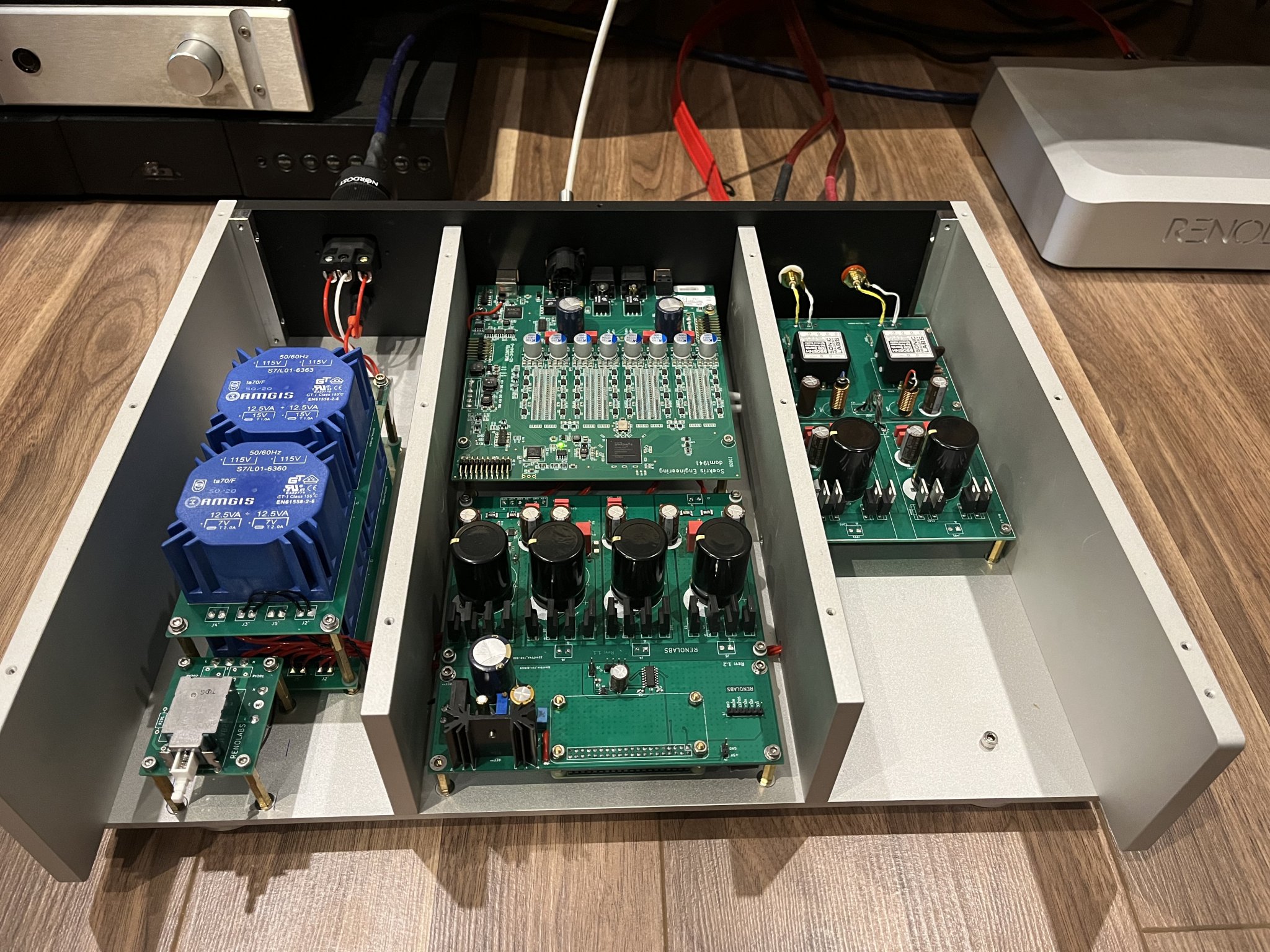

This is also my very long project too. It have following msections
1. 3 Power supply for dam19x1 is LT3045, 1 for eRed Dock also LT3045
2. Buffer Designed to use Sparkos Pro or Sonic Image Opamp, also powered by LT3045 too

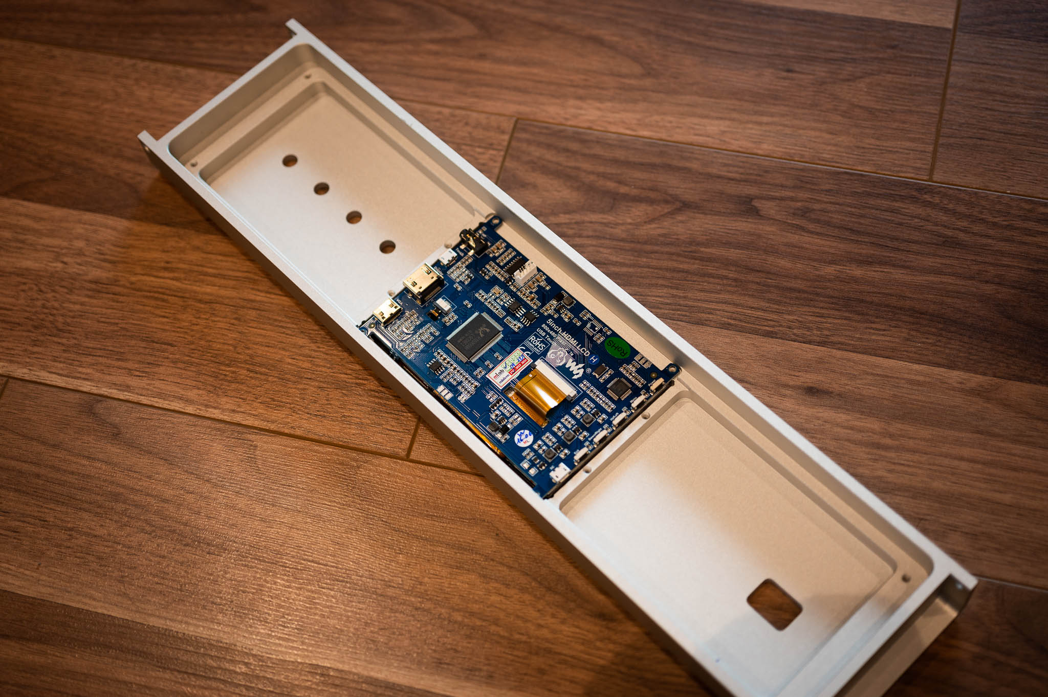

3. controller section use Pi Zero 2W to drive 5inch LCD, serial line was isolated with dam19x1 by Si8641
