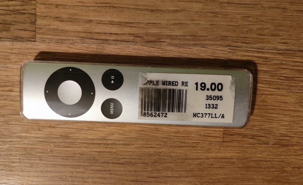

Hi all. I have a problem with the remote control. When I press the up arrow, sometimes the volume increases and sometimes it decreases, and vice versa. I have already tried two different remote controls and the result is the same. They were both from aliexpress but compatibile... From the DAM to the IR sensor, the cable is about 20 cm long and I have no foil / optical filter in front of the IR sensor. Where is problem?
I had the same problem with an Apple original remote, the white one from an old ipod mini. The problem was solved when I used the latest Apple allu remote.
Thank you. Can you send me link on your allu remote please?I had the same problem with an Apple original remote, the white one from an old ipod mini. The problem was solved when I used the latest Apple allu remote.

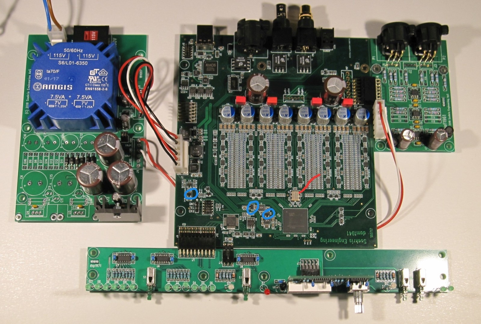

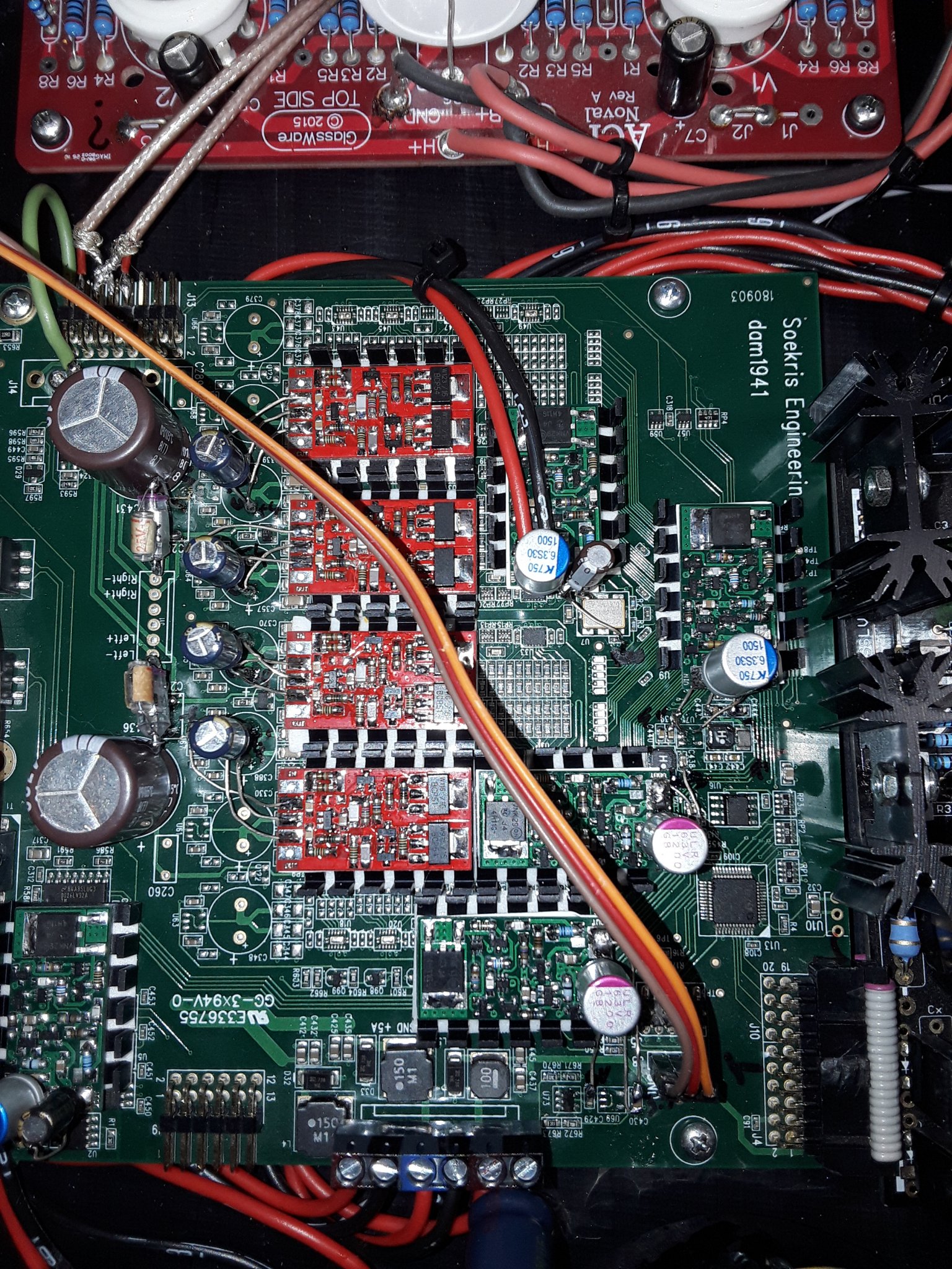

Hello im a diyer i love diy, and i love soekris dam dacs. I have lots of 1021 and 1121 dams and i have modded them. For now i have 1921 with 1971 dsp panel. of corse i have modded the same way i do in 1021 and 1121. So i have disolder on board 3.3, and 4v reference, and 1.2v stabilizers and solder my stabilizers i like it i have point them on picture by blue color. Red color line is the place where org is litle trace to power up clock. i have cut thiw trace and solder my 3,3 stabilier with self power to the clock. it works well, plays very good but with litle problem. When i power on and of couple times the soekris led blinking and geting off, and all leds on pannel are blinking . I dont know where the problem is, beocuse dac works corectly, but sometimes after power on dac it have problem. Soldering are good. Please tell me where to search, i know did you dont like this kind of mods, but im with soekris couple of years,and i will go further with you. Please take a look on pictures. Mayby on board stabilizers have power on order? Very very thanks!
