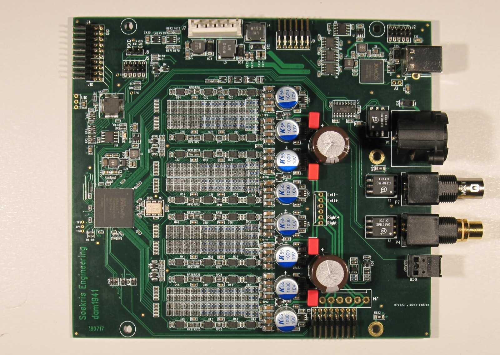

I have a project in mind.
The soekris 1941 dam in parallel mode comes out at 2.6 volts and zout of 313ohm.
At the output there is no dc offset but still there is high frequency noise from the r-2r switching process.
For this reason I would like to make a transformer output stage.
A transformer thanks to its bandwith can filter out high frequency noise without using a harmful low pass filter, right?
My concern is, is technically possible to build a 1:1 transformer that will accept its 2.6volt SE and 313 output impedance? With a bandwitdh of 20-25.000 khz.

May i? If your system sounds better after removing something it's reasonable to call it harmfulPlease describe a "harmful low pass filter".
A 1:1 transformer fed from a low impedance and without any dc is about the easiest transformer to design. Don't know how you can limit the bandwidth to 25kHz though. Or why. Do you plan to use the NOS filter with redbook?

What noise have you measured? Or seen in measurements - ref?
Where is the parallel capacitor?So your plan is to remove one parallel capacitor and replace it with 2 inductors? Or will you keep the capacitors as you add the trafo?
I didn’t know it, exactly where is this lp filter?🤔The DAM DACs has a capacitor on its output forming a LP filter.
No, they are not. Whatever they cannot amplify they just filter. Whatever they do amplify, the output transformer filters. Either way, no prob. A solid state, high NFB circuit may indeed get upset with a lot of out of band noise but a tube amp working open loop, no way.Because I don't want r-2r switching high frequency noise injected into my 300b se integrated amplifier.
Triodes are pretty sensitive to high frequency noise.
In my case the dam1941 was followed by a balanced tube preamp with a transformer coupled output into solid state power amps. Removal of the dam low pass filter brought only benefits.
Red caps
Ah okay, and the electrolytic in the middle of the two red caps?Red caps
